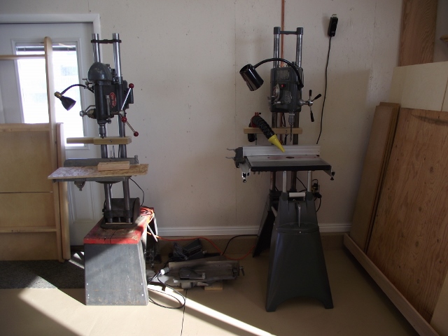

OK, I have a 520 Power Pro that has been upgraded to that from a 510 that I bought new in 1994. I bought a full up Power pro headstock and double tilt and used the other MK V headstock to build a dedicated drill press. I also have a dedicated 10ER drill press along with a MK V shorty that I built. All the MK V's have 520 tables and fences. I did that for interchangeability.
All of the accessories accept for the mortising attachment will fit the 10ER. OK, that is not quite true since the 10ER fence dose not have T tracks. However the main advantage of the SS drill press is still available in the 10ER. A large table. a tilting table and an adjustable fence.
The MK V slow speed is a little too fast for larger Forstner bits. The 10ER with the speed changer it much better.
DSCF1101 (640x480).jpg (198.84 KiB) Viewed 4004 times
