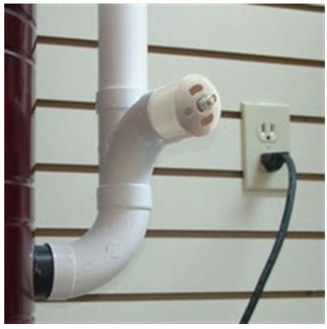

If you are concerned about 2HP creating too much vacuum and collapsing the dust collector, you can also add an adjustable suction relief valve such as https://www.youtube.com/watch?v=Ax42XEe ... r_embedded to the suction piping used on the vacuum line to the separator. It also helps protect the motor in the vacuum if you get a clog obstruction.

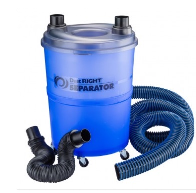

The Rockler Dust Right Dust Separator has worked like a charm for me, and it's size and reduced height lets me keep it out of the way. I didn't need a 2HP unit for my work.
