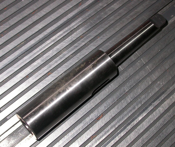

If all you need is a #2 Morse Taper to ~1+" diameter by 2" long cylinder I think this will work.
[ATTACH]1272[/ATTACH]
It is a standard #2 Morse Taper to #2 Morse Taper extender. If you want the body bigger you can get a #2 to #3 adapter as well.
Paul Cohen
Beaverton, OR
Roy - How about removing the tail cup center from the tail stock and finding a metal cylinder of the size to fit into the tail? Maybe you would have to find a local machine shop to turn you a piece. Shouldn't be too expensive.
Seems you can tighten the cylinder into the tail stock with the two allen screws. Should hold pretty well.

Paul, this looks like it might work. I have a email back to Stan.
Chuck, that was my first line of thinking (hoping that some standard pipe might fit it and not be too large).
