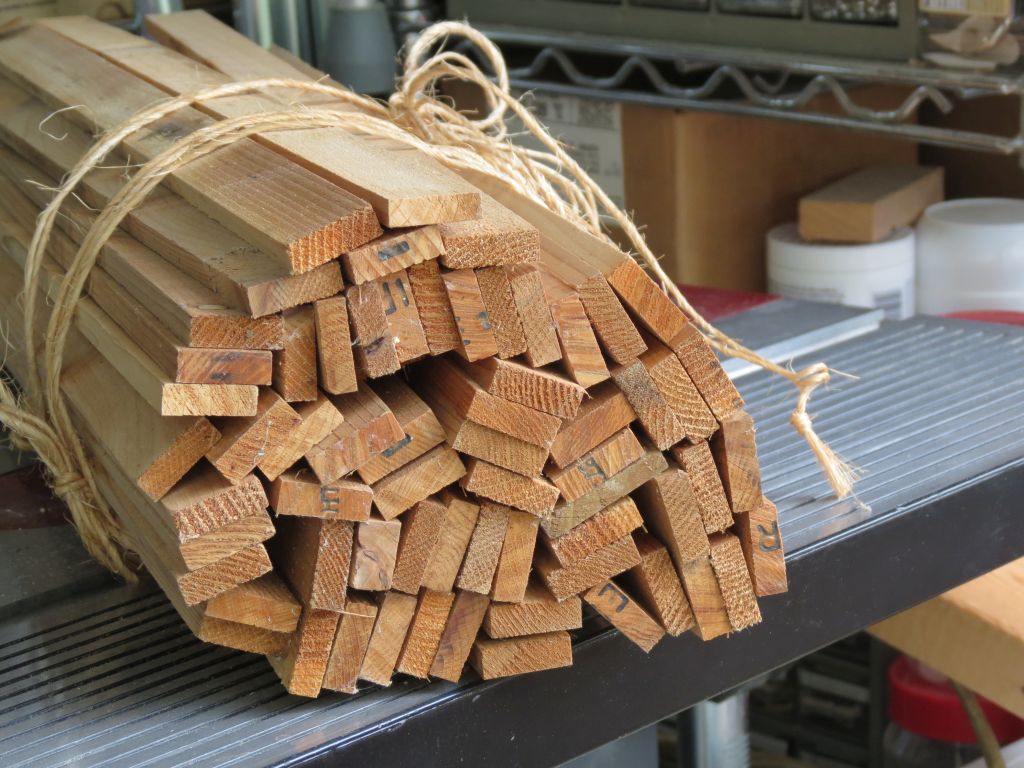

I have several bundles of scape wood I got from a cabinet shop quite a few years ago (they have since gone out of business so that source dried up but I still have these pieces and lets say this is 1/4 of what is left).
The actual dimensions are in the 3/8" thick by 1" wide by 20+ long. I think they maybe fine but a bit wider then I normally use. I don't see a problem trying one kite this way and see if it functions OK rather then sizing the strips to 3/4" wide.

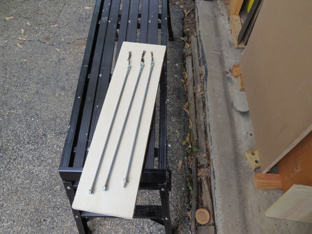

This is the hardware for the kite.

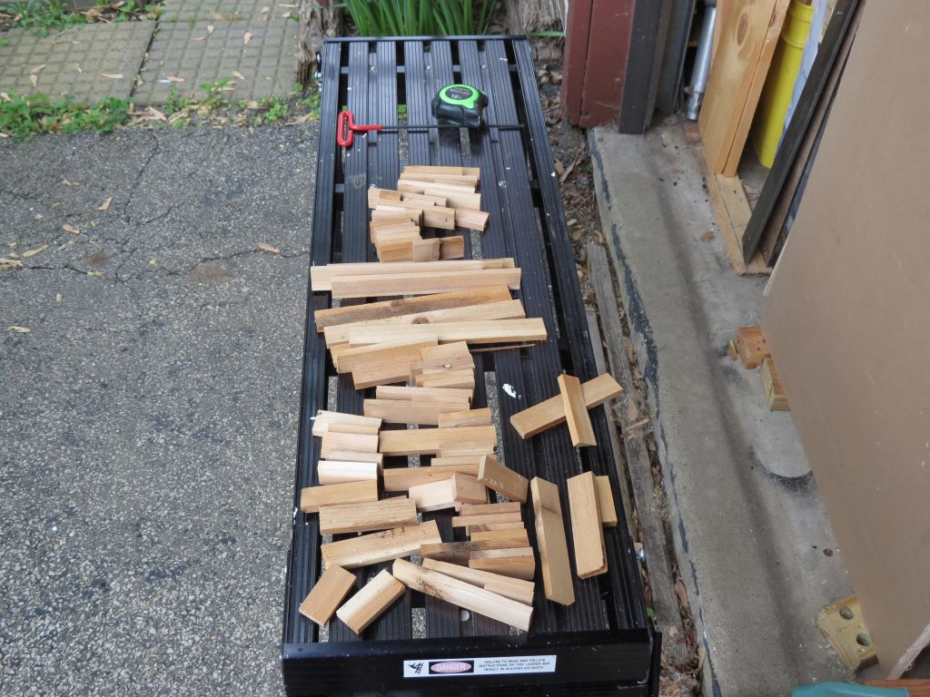

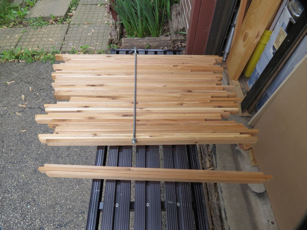

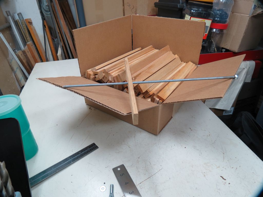

Rather then measuring and or doing the math to find out how many strips it will take I simply lay them out and then add a couple of spares in case I find some defects I can work around. The process looks like this:
I then do a visual inspection looking for those defects early on. Some of the parts have defects but if I think they will be a show stopper I get rid of them now. I still keep the spare count as somethings don't show up at this stage.

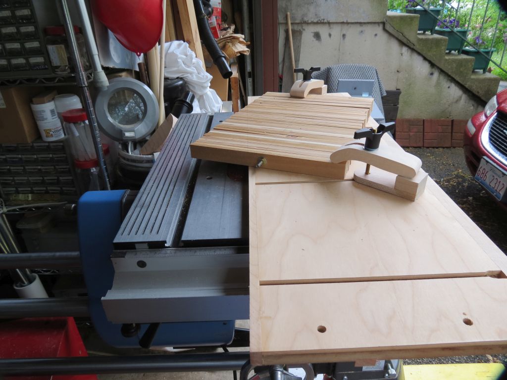

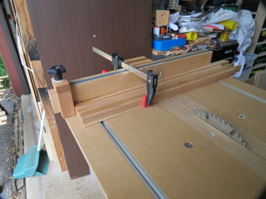

I have decided to bring out my sled to do the cutting. I will do a "gang" of parts at the same time and this is a safe way of doing that.

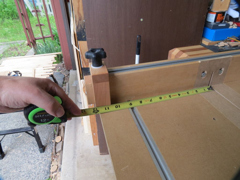

I start by using a tape measure, hooking the end in the zci slot of the sled and measuring over to set up a stop on the sled.
Note that since the blade cut the slot in the sled the edge of the cut will be pretty darn close but in this case it doesn't really matter as we are just making a pretty simple craft item where being off even a 1/4" on this cut would not matter.

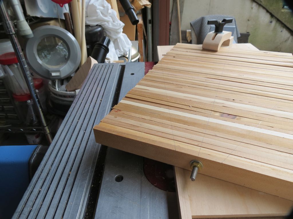

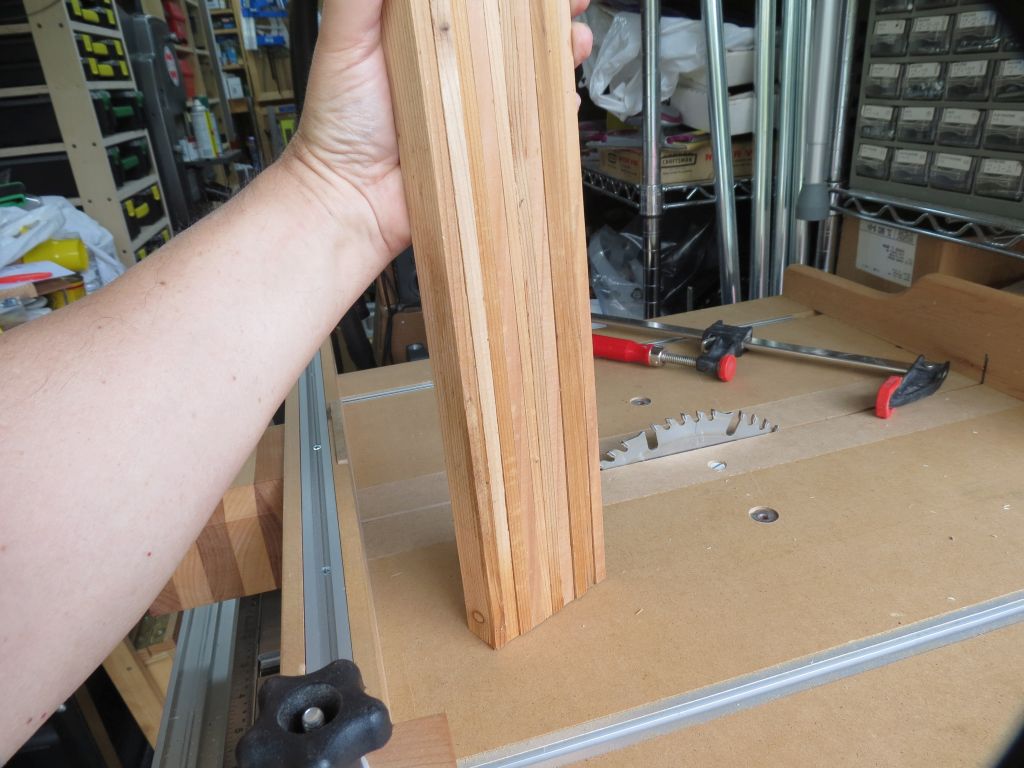

Next I pick out a "gang" of strips, a comfortable hands worth and register one end to the sled.
Next, using the stop for location I clamp the strips together to the sled. For added safety you might want to clamp to both sides of the cut.

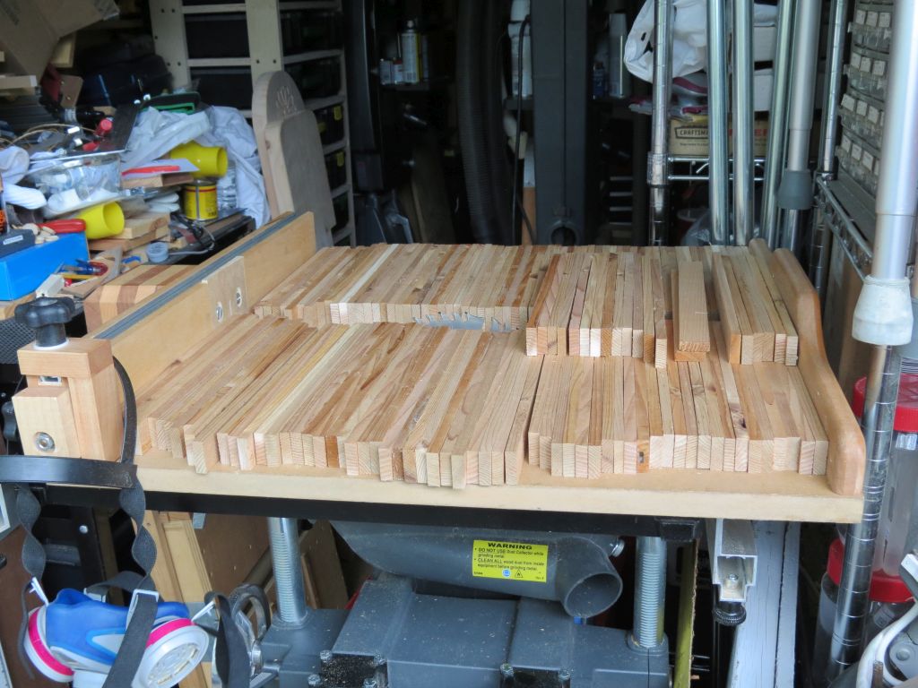

No nap, the weather held out just long enough for me to do this set of cuts resulting in 142 pieces and a small pile of left overs.
First the left overs:
I say left overs cause they some of them are still going to be useable if I get into a bind and need them.
The cut pieces, did I mention 142 of them are now ready for the next process.

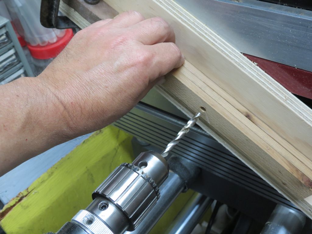

Time to make the donuts... ah wrong ad, time to make the holes. Weather is not going to be stable for a while yet so I decided to just work inside and get this part of the job done.

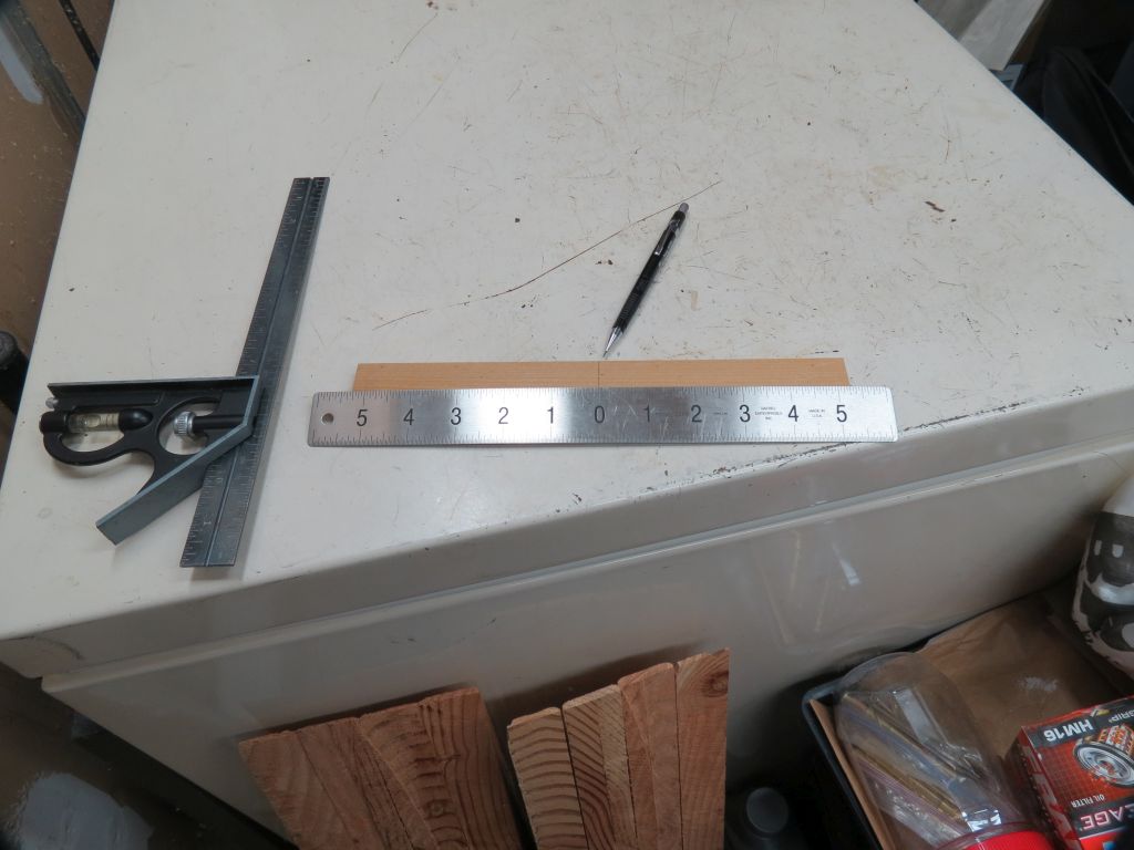

First thing was to find the center of the workpieces, and a handy way to do that is with a centering rule.

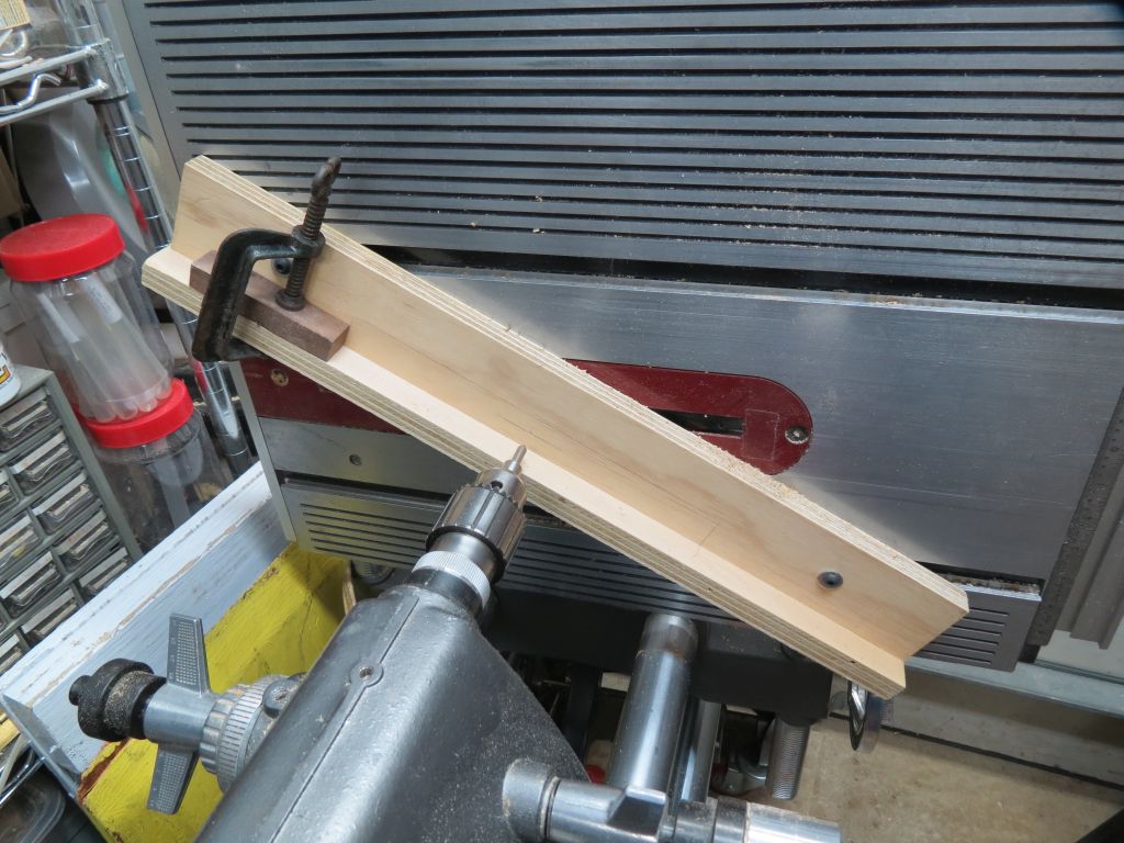

With this part I then set up the shopsmith to do the drilling. A few notes here as this might interest some of you users. I made a jig out of a scraps of plywood. One part I simply drilled a hole that would allow me to mount the plywood to the table using a couple of t-nuts.
It was done at an angle for a couple of reasons. First it didn't require any measurements, I simply set the wood on the table at an approximate angle that looked good to me and then marked where the miter slots were. Drilled the holes and that part was done.
Next I wanted a part that would index and hold the parts during drilling. Another scrap of plywood and some screws to attach it to the first piece. So far we are talking minutes here.
Now with the jig mounted it was time to locate it vertically by way of the table height. Yes we are taking a horizontal drill press mode here. using the marked workpiece and a centering bit I got the table adjusted. Next was to locate a stop block along the jig for that location. A clamp worked fine to hold a pen blank reject in place.
I then rechecked the location to make sure it was where I wanted it. Removed the centering bit and when to decide which bit I would be using.
We will get to the other reason for this setup a little later.

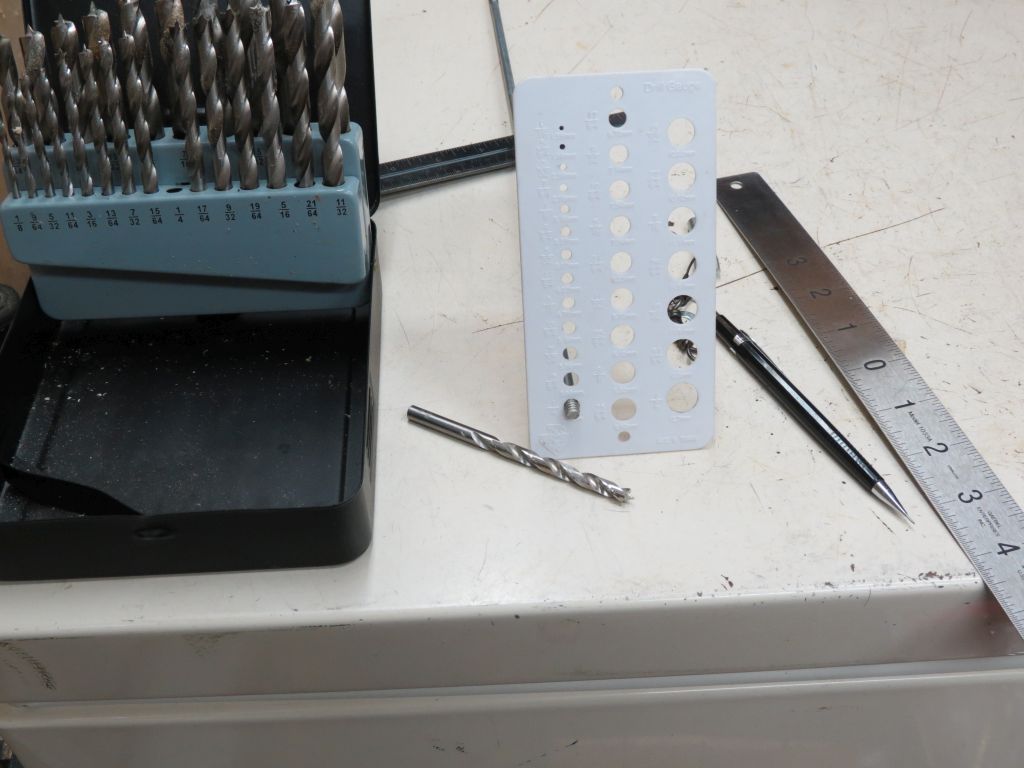

I wanted to use a brad point so I got a clean cut. By using a drill gauge it looked like a 1/4" hole would be just right.
Now it was time to drill a sample and see how it fit. One of 142 pieces mind you. It fit fine so it was now time to do the drilling but you will see that in my next post.

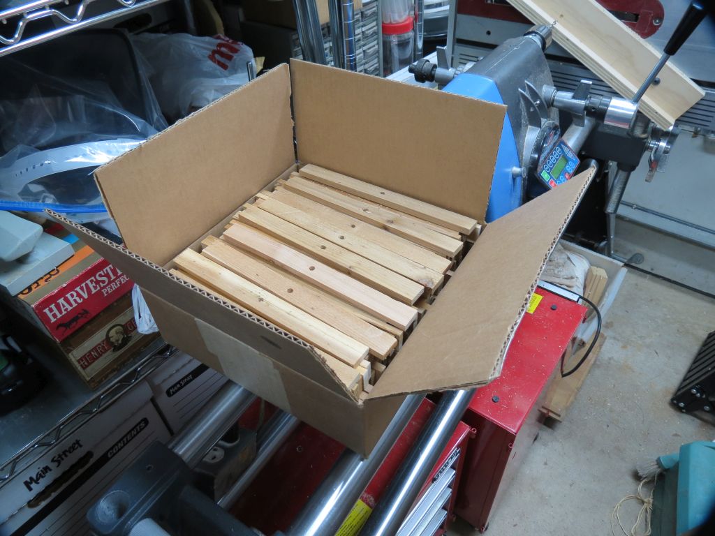

I didn't time the drilling operation but it felt like it went pretty fast. I later looked at the time stamp of the last photo before I did the drilling and then the photo I took when I finished re-boxing them. The time was 19 minutes, and a few of those were not drilling related so my guess is it took about 15 minutes. That is not bad for all of those pieces and I wasn't rushing it.
One of the reasons was how I had the set up done. My set up allowed me to drill them 3 at a time. The angle and location of the fence let the sawdust fall away so I didn't have to keep cleaning up the work area. That was intentional and is the other reason for the set up being the way it was.

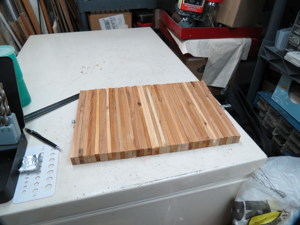

Now with the holes drilled I was able to do a test assembly. It looks like 45 is a good number.

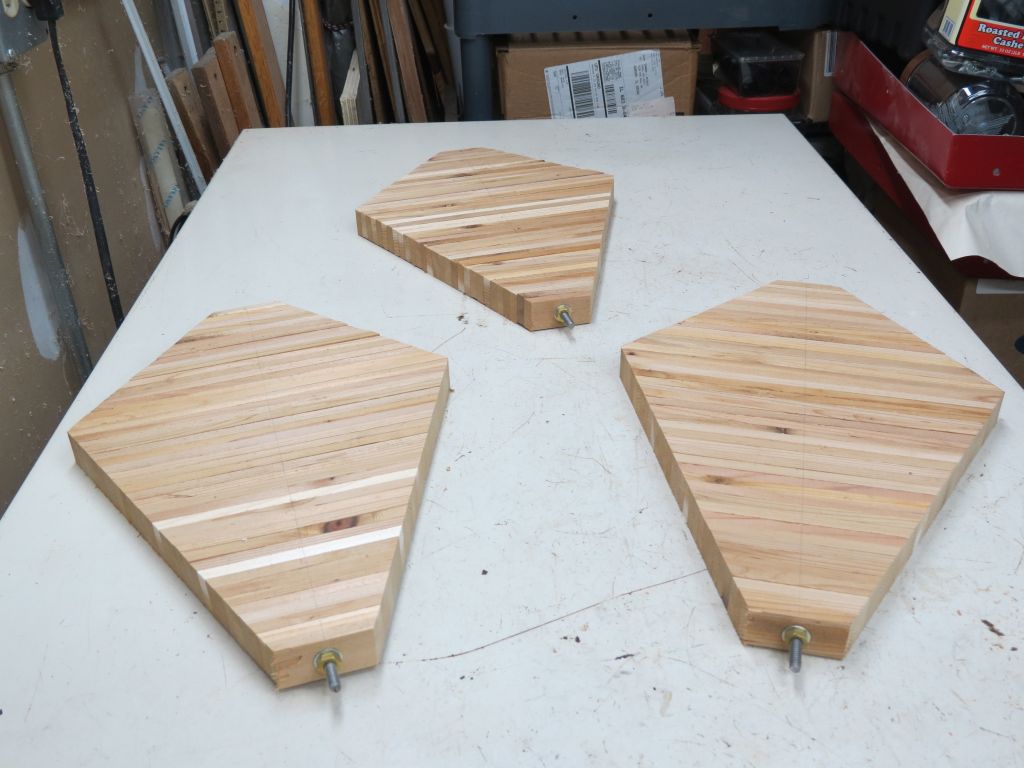

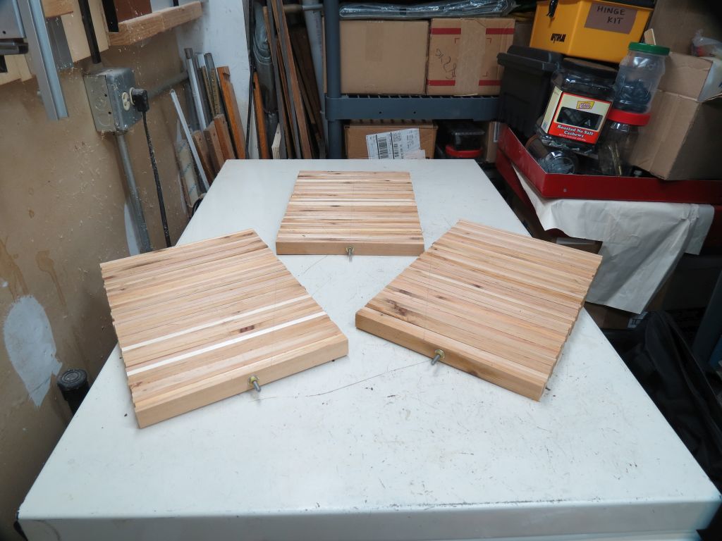

May plan was to put the other two kites together then cut them all this morning. So are the plans of man. I did get them assembled and they are ready to cut. I was setting up for the cuts when the rains came so that was what you call a washout.
This is what the three of them look like when they are ready to be cut.

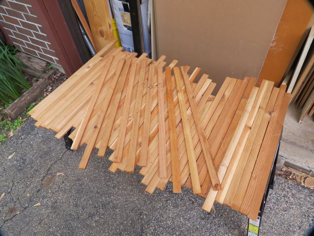

Here it what the kites look like at this stage:
From the center line the widest parts are 10-3/8". The taper starts where the lower portion of the 16th down strip sits. The line runs to a 2" wide mark at both the top and bottom.
