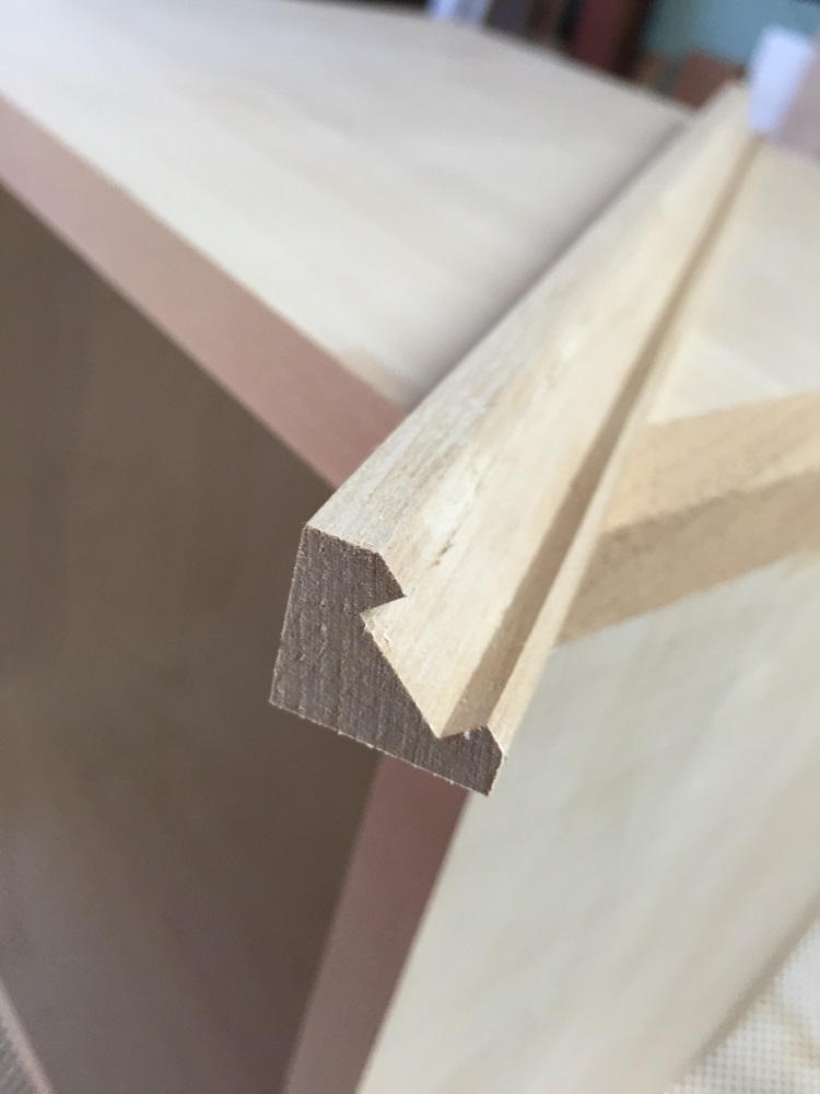

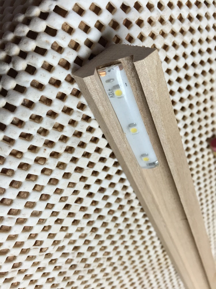

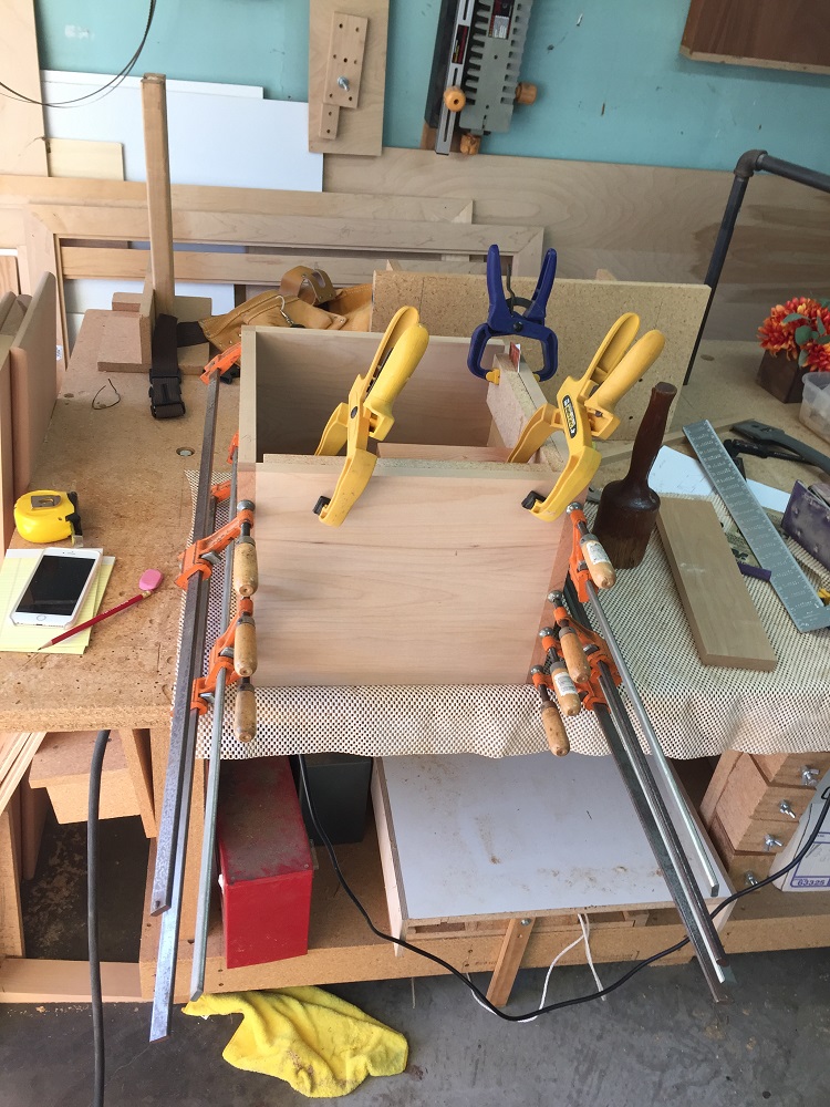

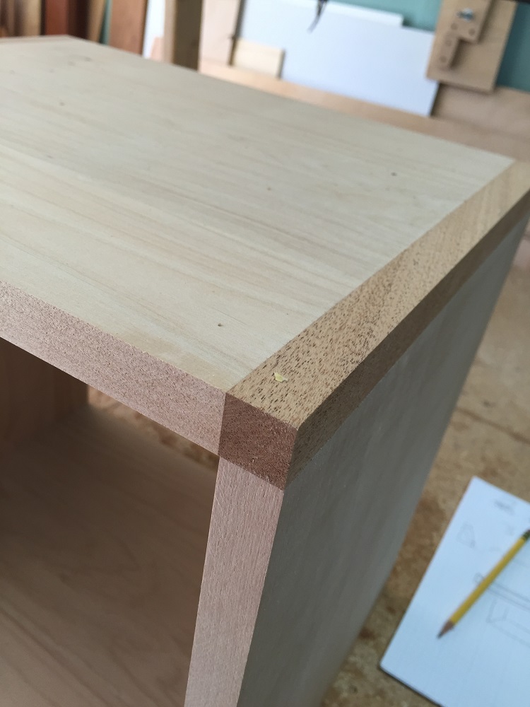

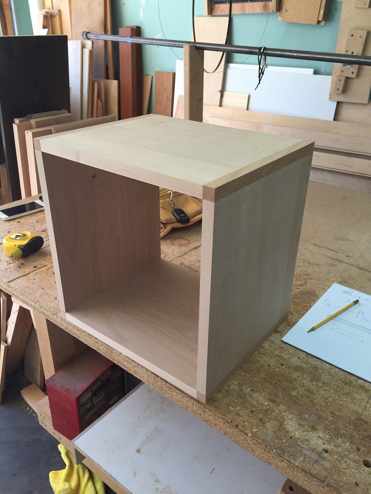

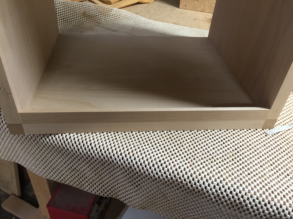

Good day in the shop today. I got the cube prototype finished and approved by the boss. Now to build the other nine. I included pictures of the light valence which shows only the one in place. Ultimately there will be one on each side of the cube and mitered together. The body is alder with the corners and valence in Honduran mahogany.

Re: The next project begins
Should look very impressive when all the lights are on. The corner joinery is..? epoxy glued butt joints? dowels or biscuits?
Idaho Panhandle
Idaho Panhandle
masonsailor2
- Posts: 1564
- Location: Las Vegas NV
The corners are butt jointed biscuits.

ddub
This picture just solved a problem of how to do something that I have been thinking on! Thank you!
