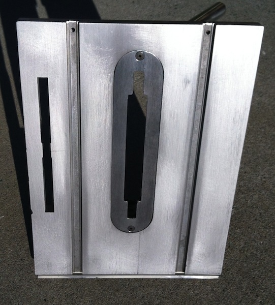

Did you mean the Mark V 500 with two slots that was discontinued?
Shopsmith 500 Table with two slots -discontinued-.jpg (100.26 KiB) Viewed 4047 times
If there is another early 510 Table, I don't know about it. Do you have any data on it you could send me? To my knowledge I haven't seen one myself.
