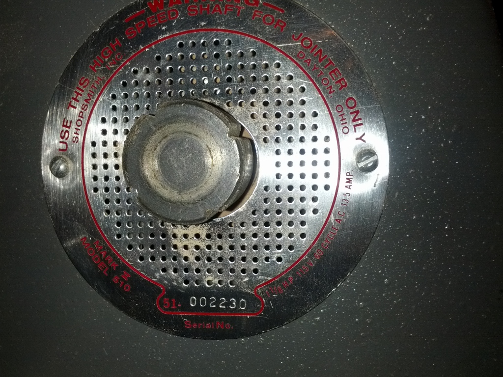

Hi. I just purchased a Mark V looks like produced in Feb 1982 Serial # 116361 and I'm looking for a carriage assembly on Ebay and most are marked for use on a 500 model. How do I tell which model I have also does any one know of a good source for used parts besides Ebay? I'm also looking for some 4 inch jointer blades and a manual for this model. Thanks for any help.
Re: Carriage is missing controls!
The model number should be on the vent plate on the left end of the headstock. Check there to start but if the previous owner made upgrades then model number may be insignificant. (Edit: Added two additional pictures. Also note that some headstocks may be a later model as with one of my shorties. It has a 510 headstock and a 500 carriage. Poor quality photo brown is not rust) A picture of what you have would help in identification. Here are a couple of pictures from ebay of cariages.

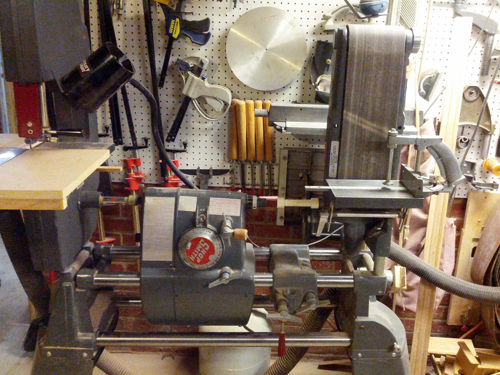

Redleg, I gotta ask: what is that coupling the bandsaw to the headstock?
And is that tubular extension around the bandsaw's shaft a normal part of later bandsaws? I've never noticed it in a photo (I've got the old cast iron bandsaw).
That is an old Shopsmith Power Coupler similar to Shopsmith Power Coupler Kit 555124. It does have a Shopsmith label on it. The tubular extension is a guard for the band saw shaft that came on the band saw I bought with my Power Pro about 2 1/2 years ago. I think it may cause problems when raising a 500 model vertical with the band saw in place if you do not have offset tubes on the band saw.

How far does the new bandsaw shaft guard extend out from the bandsaw casing?
Since it is in the center, the tie bar may clear it. With a 'normal' size base, the tie bar would have less clearance(longer arc due ti longer pivot length).
