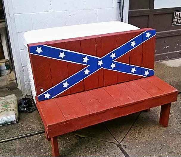

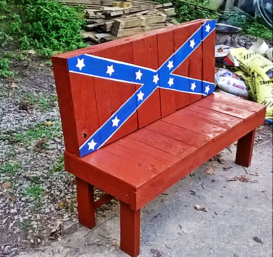

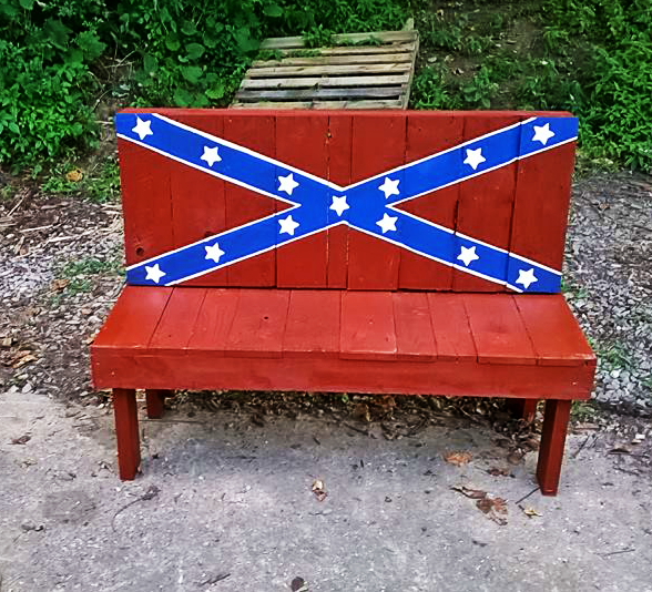

48x18.75 with back tilted @5 degrees, for comfort.
This built, like a brick $hit house, strong like a bull.
Frame is put together with 2 inch deck screws, planks are fastened with 6d penny galvanized, twisted shank nails. Back is mounted with 3 lengths of 1/2 inch all thread. And yes, very heavy. it is built to last.
All paint and stain is double coated.
I will use this bench, in an up and coming farm show vending event, for advertising. If it sells, it will go to the highest bidder, but not until, the end of the show.

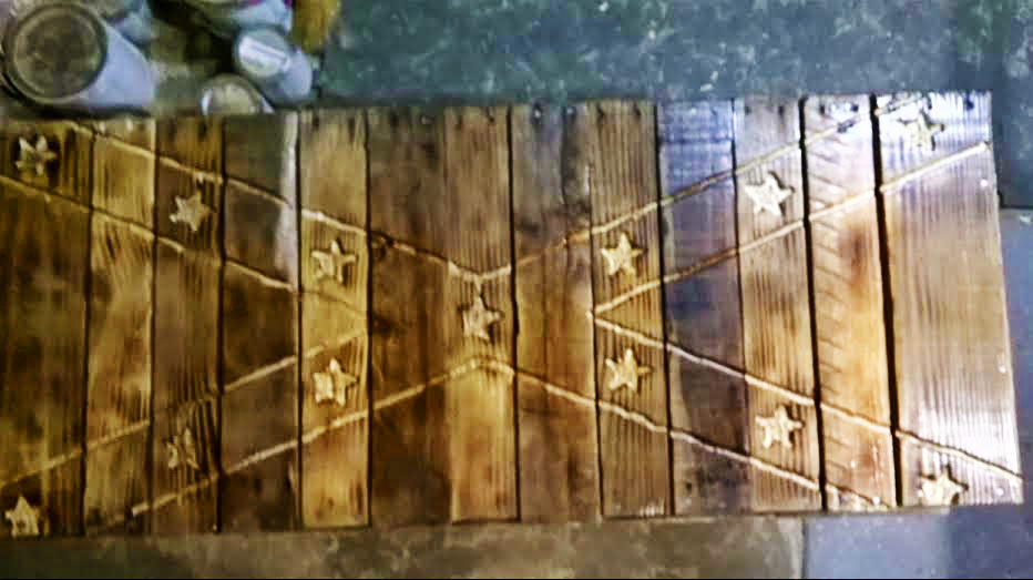

Here is a more conservative looking, stars and bars flag, bench. (well the back of it, anyways)

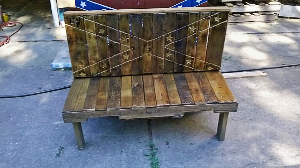

Newest variety of the above bench. This one is a bit conservative.
All carved using a non plunge trim router. 3 coats of poly finish.

I noticed the stars were recessed. Did you rout them freehand, as you did lettering, or did you make a template.ExtraMile wrote:....
