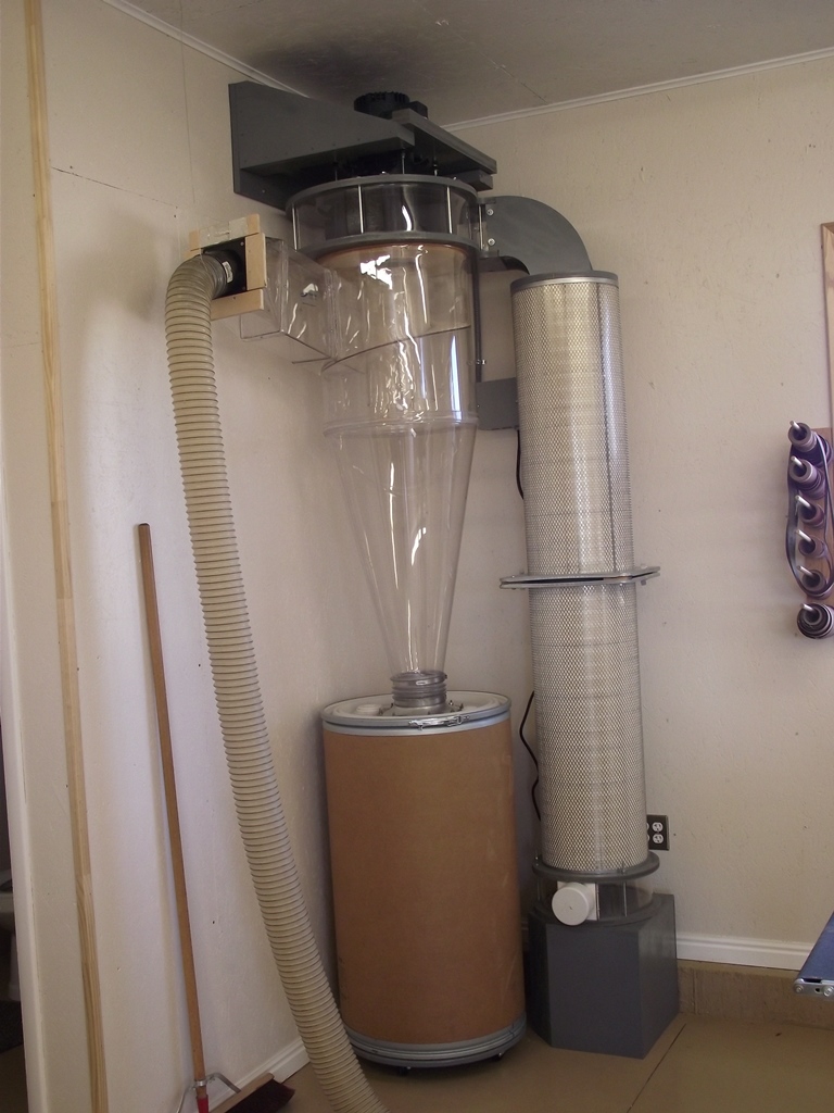

I also thought that was true for the smaller DC's. My Clearvue Cyclone doesn't have one but that is different.S Brian wrote:I thought all canister dust collectors came with a crank, which is attached to an internal paddle. My 1 HP Penn State has a 1 micron canister, with a crank. After a few uses, I turn the crank a few times and and the paddle knocks 90% of the fine dust into the bag.

ddub
Re: Dust Collection
That is a snazzy looking setup jsburger.

Thank you. The picture was taken a few years ago when I first installed it. It is still not plumbed in.ddub wrote:That is a snazzy looking setup jsburger.
