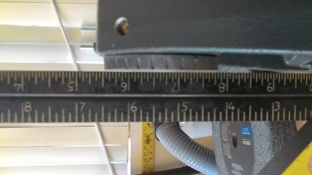

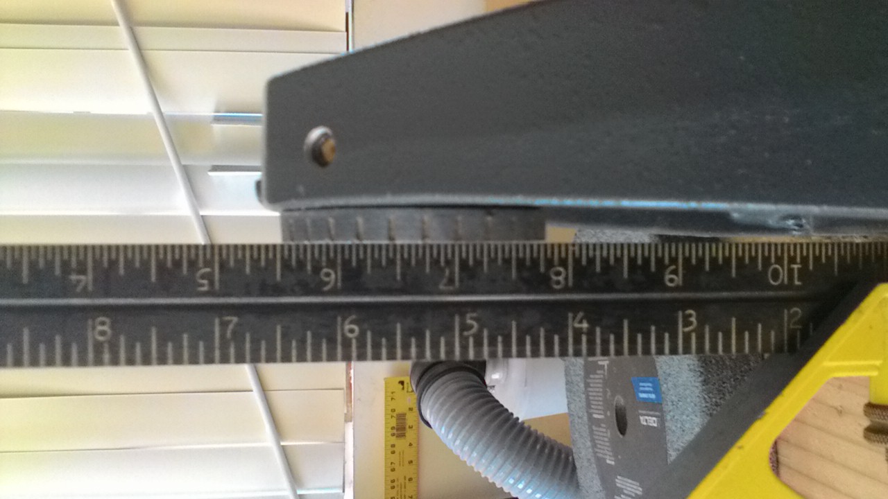

Noticed the tailstock had movement at the way tubes. Made sure everything was level and took 2 pictures; one with the tailstock forward position and seconded with the tailstock backward position. It appears to show that the movement is approximately 1/32-2/32. The pin through the casting does not move.
Is this common and I am just noticing it and/or is there a corrective remedy?
Thanks
Alan
Loose Tailstock at Way Tubes
- Backward
- P_20150820_134123.jpg (176.63 KiB) Viewed 2132 times

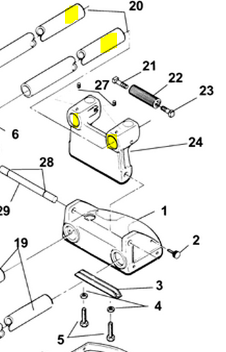

Pleased it is not uncommon. The movement is at part #20 & #24. Next time turning I will make sure the tailstock is in the back position (when pressure is applied) and use the Eccentric Mount for the needed adjustment.JPG wrote:Not uncommon, but this helps minimize it.
http://www.shopsmith.com/ss_forum/viewt ... MP#p174761
- #20 & #24 Movement
- Way Tube.PNG (81.59 KiB) Viewed 2026 times

The play I was referring to is between the spt posts and 24.
20/24 play is a different animal.
Off hand the only thing I can think of is the way ubes are not secure in the "24" bores.
Re: Loose Tailstock at Way Tubes
Agree the top way tubes are not secured. The bottom way tubes have #3 & #4 to assure they are secured. For those who have removed the top way tubes how did they fit when reassembling? Are the tubes compression fit?JPG wrote:The play I was referring to is between the spt posts and 24.

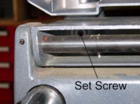

If you have a Dec 1993, or later machine, the way tubes are held by setscrews on top of the base arm, part 27 in the diagram. If you have an earlier machine, put it in vertical position and look through the pivot arm casting to see and reach the setscrews. (I'm getting this info from the double tilt base upgrade directions.)
Thanks Mike, that would have been the very last place I would have looked for a possible solution. It easy to find and just as easy to tighten!! Thanks again,Mike907 wrote:If you have a Dec 1993, or later machine, the way tubes are held by setscrews on top of the base arm, part 27 in the diagram. If you have an earlier machine, put it in vertical position and look through the pivot arm casting to see and reach the setscrews. (I'm getting this info from the double tilt base upgrade directions.)
Alan
- Way Tube Set Screw.PNG (309.05 KiB) Viewed 1996 times
