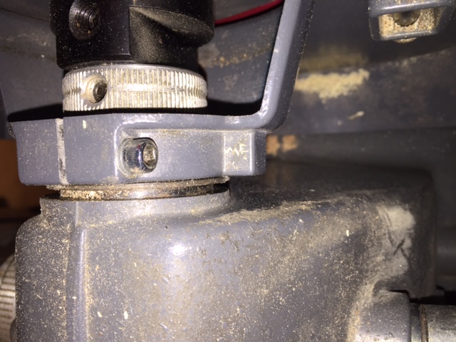

Not sure if I am using the right terminology here but the quill that extends the arbor does not return to 0. Meaning I think it should go back a bit more. Is this photo normal? Shouldn't the guard sit flat against the headstock?

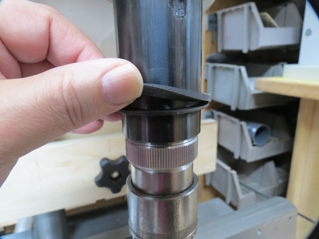

Another question might be what is missing from your shopsmith.
Re: Quill Not Returning to 0
Notice yours stops closer than the rubber bumper(missing) will allow(the bumper acts as a soft stop).

Ah, so there is a part missing? Could one be made from rubber gasket material?

I have never tried this but I think that an "O" ring with a cross section of about 1/8" and proper diameter may work until a proper replacement can be obtained.
