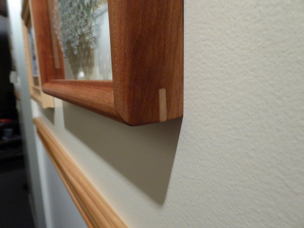

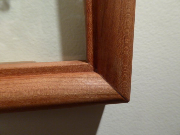

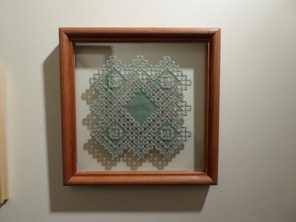

Most Thanksgivings my wife invites a women she used to work with to share our meal. Like any good guest she brings gift of some sort. Being a fiber artist last year she made this great lace piece. So with Thanksgiving quickly approaching I figured I'd better make a frame and get it up.
This is 9.5 x 9.5 cherry with maple splines in the corner. The lace is held between two pieces of glass. Just to be different I used a slot cutter on the router table for the splines. I thought someone might find this interesting.

Looks very nice. That is a great design!
She wI'll be thrilled to see it on display

Nice job, really good tight mitre joints. Did you make the frame profile and if so how?

algale wrote:Nice job, really good tight mitre joints. Did you make the frame profile and if so how?
I made the profile. It's easy. I started with stock 13/16 x 1.5. I set up a 3/8" round over bit in a router table, with the bearing flush to the fence and made a pass with the 1.5" side down on table. Then I raised the bit about an 1/8" turned the stock over and made another pass. The piece doesn't come out 'round' but it's easy to use a block plane and abrasives to sand the profile into shape. If you made a large frame it might be a bit more work. You can use thinner stock and 1/4" router bit or larger stock and move to a 1/2" router and create the same kind of half round look with the character line running around the inside of the frame.
If I've been unclear because of the Thanksgiving over-indulgences, write again and I'll try to be clearer.
Re: Picture Frame
Nice job, Berry!
I appreciate your mounting using two panes of glass. Gives the affect of a floating piece of art.
