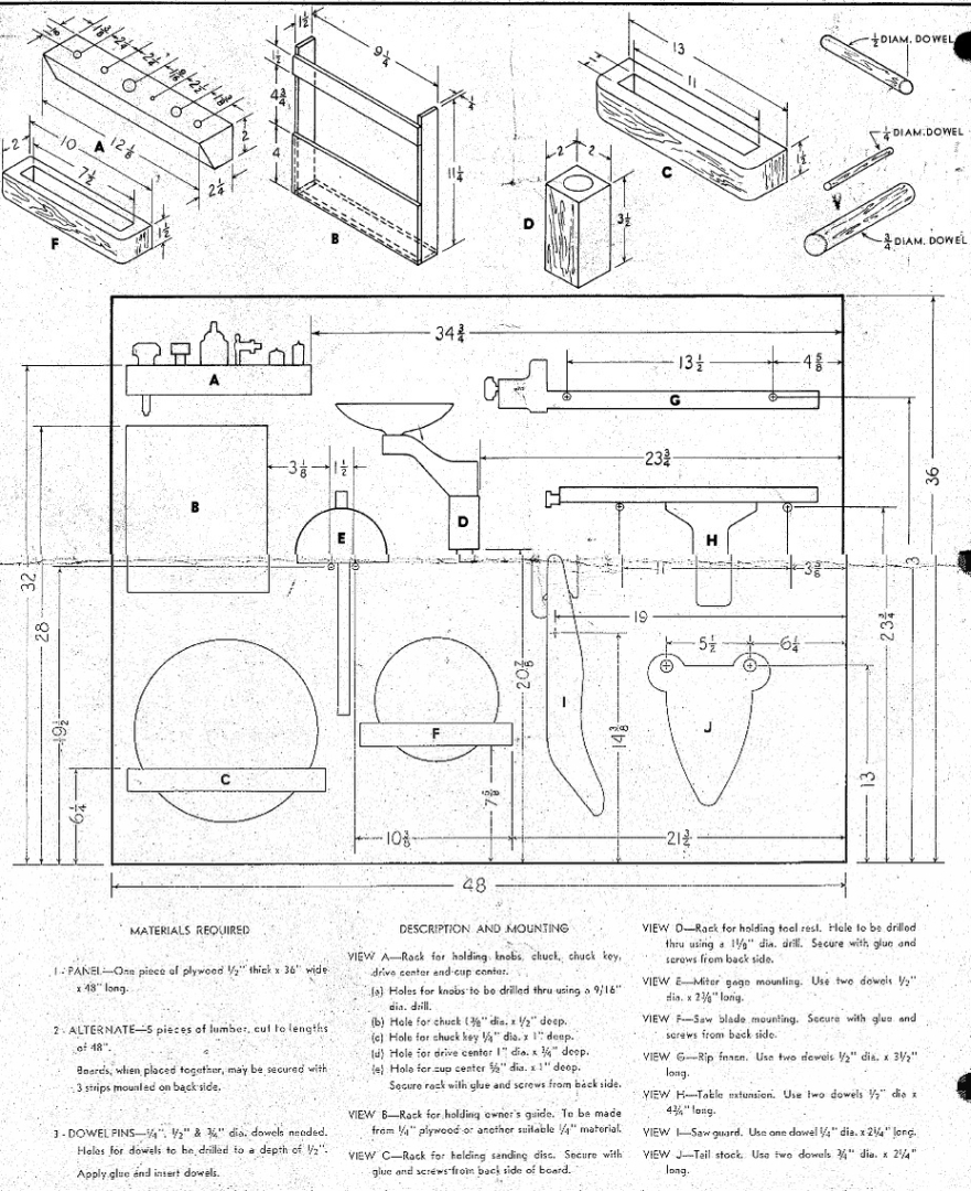

I was reading through the ER manual over at Vintage Machinery, it sez in there when unpacking your ER, there is an envelope with plans to make a bench for it if you dont want to buy the SS leg panels. Anyone here got a copy to post or a link to it?

Here you go Mike. I have the original and it is a true blue print. I had to save it in black and white so it was small enough to upload here. If you want a color copy PM me with your email address and I will send it to you. Even grey scale looks much better than black and white but it was too large also.
One of the 10ERs I have here is on a bench made from these plans.
10ERWoodBench0001.pdf
(739.22 KiB) Downloaded 606 times

I had a feeling it would be you, ya know why, on VM on the ER there was your name for some info, a true lover of these machines, thanks JB

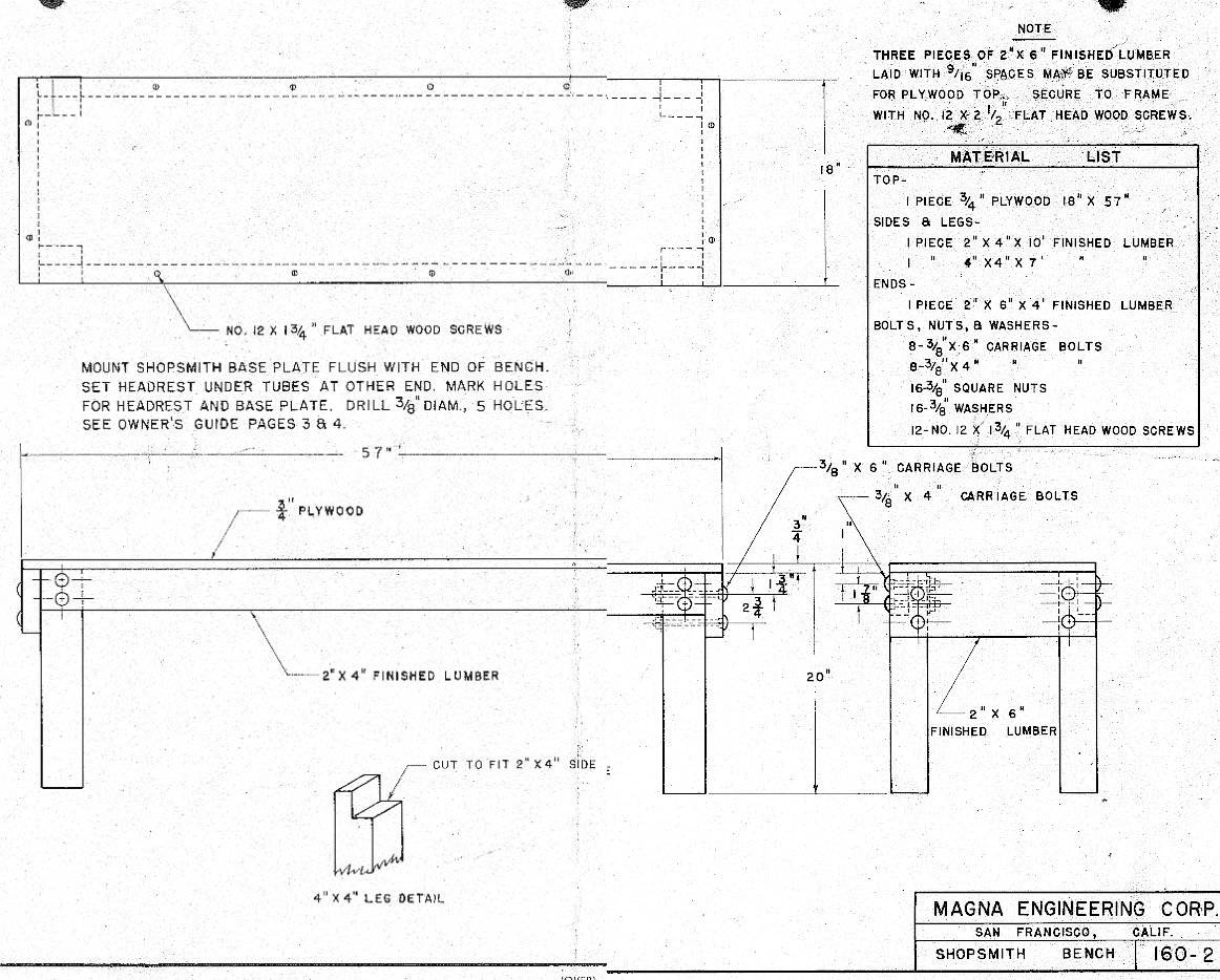

Re: ER 10 Bench
Maybe this will help. :)
ER BENCH AB.jpg (745.77 KiB) Viewed 3438 times
Overlook the slight misalignment(done blind!).
I have not looked close enough, but be aware dimensional lumber 2 x 6 'then' was 1 5/8 x 5 5/8 (IIRC)
ER BENCH CD.jpg (668.82 KiB) Viewed 3424 times
The second dimension from the 'bottom' is 31, not 3.
