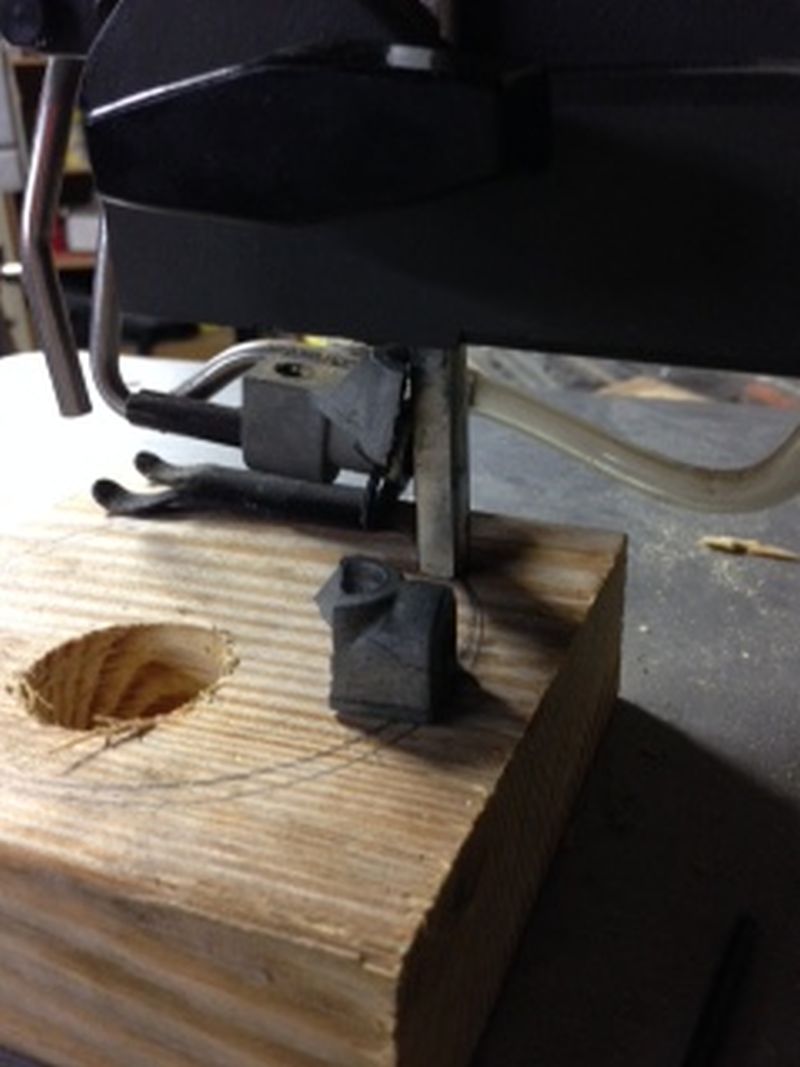

Here is a picture of the old gray scroll saw broken part. I was unsuccessful with finding a picture or part # from any Shopsmith source. A replacement part would be my first choice for repair.
- IMG_1629.JPG (30.68 KiB) Viewed 7831 times

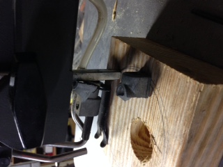

Sorry it's sideways - it was right side up in preview! The broken part is closest to the hole in the wood.

I'm having trouble seeing the part in the image but my eyes are not what they use to be so perhaps that is the issue.
Re: old gray stand alone scroll saw
After making a couple of changes to the image it looks like it might be a blade holder but it not at all like what mine has.
