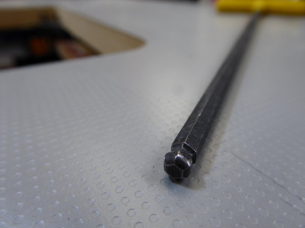

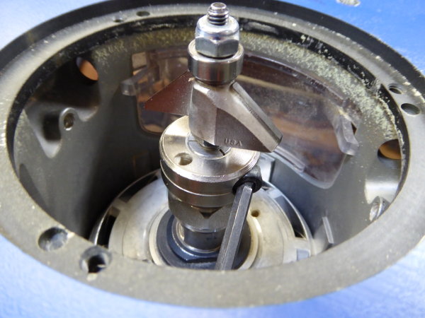

Not any more, at least not for me. The chuck tightens or loosens a bit with an approximate ¼ turn of a 5/32” allen wrench. That’s right the very same wrench we use for our SS. I use a ball end wrench which gives me ever greater flexibility. Now I can easily remove or mount a bit without removing the router from the table.

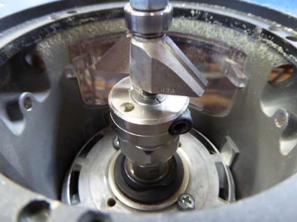

It’s worked great on every bit I’ve tried. I did have some serious vibration with this chamfer bit but I just loosened it and turned the bit about ¼ turn, re-tightened and it was fine. . It works well with reducers so you can use ¼” shank bits just as easily as ½” shank.

unit mounted on router in table

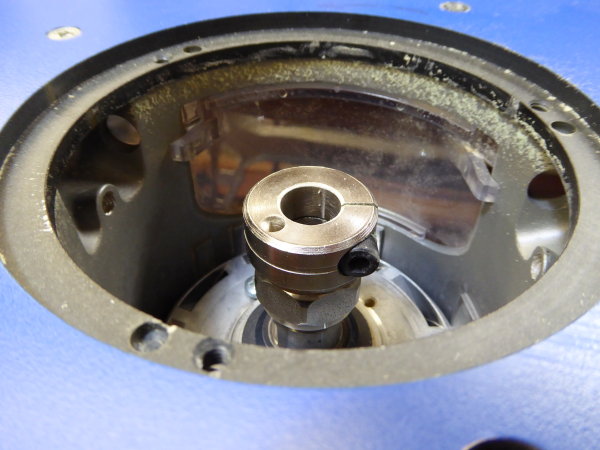

MC 469.jpg (61.97 KiB) Viewed 8864 times
with bit
with bit

tightening bit into chuck
MC 468.jpg (65.49 KiB) Viewed 8864 times
ball end T wrench 471.jpg (31.11 KiB) Viewed 8864 times
