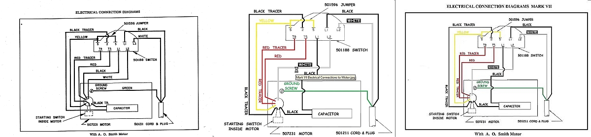

I am working to build out a D size illustrated parts diagram for the 1960's Mark VII (similar to those I did for the Mark V), but while that is in the works, see if this Mark VII Electrical Connections to Motor diagram I am re-doing will help you any.
Everett
Mark VII Electrical Connections to Motor.pdf
(434.71 KiB) Downloaded 1092 times

everettdavis wrote:I am working to build out a D size illustrated parts diagram for the 1960's Mark VII (similar to those I did for the Mark V), but while that is in the works, see if this Mark VII Electrical Connections to Motor diagram I am re-doing will help you any.
Everett
AH OH!!!!
Double check those drawings. Both have errors!

JPG wrote:[font=][font=][/font][/font]
Everett
The attachment Mark VII Electrical Connections to Motor.pdf is no longer available
AH OH!!!!
Also there is another A O Smith motor that uses an external relay.
Can you elaborate just a bit on the error? The redone drawing came from the OEM manual PDF you emailed me relative to post http://www.shopsmith.com/ss_forum/viewt ... 93#p202493
If I understand, you are saying the Magna American OEM manual wiring diagrams were wrong?
The only thing I did 'extra' was on Terminal 5 (which has a jumper 501596) was to extend the color to show the potential on the Yellow or Purple wires on the jumper connection.
I have attached a side by side to show what I did from the OEM manual. My eyes aren't what they once were, so I could have missed something.
Also if you have a drawing on the 3rd motor type with the external relay, I will strive to add one like this for it.
Since I have no physical Mark VII to reference (and apparently I would need three), it is a more difficult task to re-do a manual of this model, but I feel it is something that once vetted for accuracy, can be of benefit to others who have or acquire 1960 vintage Mark VII's. Lord knows so many of you have contributed to my knowledge.
I look forward to seeing what errors are there and correcting them.
Everett

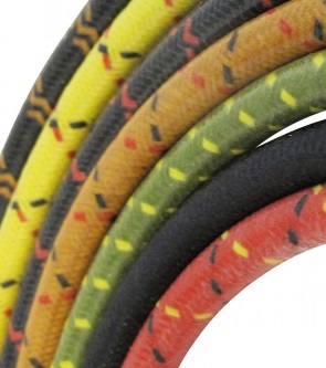

Update: As I look at it, since Magna didn't specify the specific core color of the tracer wire, I listed it as Red Tracer etc. and drew it Red Some may not know that a tracer is an added color to help identify a specific wire in a bundle, often has higher heat resistance, and may be a cloth based insulation with a tracer color as illustrated in the photo below.
Wire with tracer colors.jpg (33.83 KiB) Viewed 5477 times
Re: motor mark vii
You did not get the manual input correctly. The error is around the 'internal start switch', the capacitor leads and the 'L1' black wire.
ClipboardMARK VII MOTOR AOSMITH MAN-FIRST-CURRENT.jpg (143.55 KiB) Viewed 5464 times
The manual drawing is left, your first post center and your last post right.
Will follow with the ge and the third version.
The tracer wires are white with a tracer the color identified.
Kudos on the added color. A dashed line could represent the 'x' tracer wires.

Re: motor mark vii
JPG wrote:You did not get the manual input correctly. The error is around the 'internal start switch', the capacitor leads and the 'L1' black wire.
Aha! I also couldn't find an error in Everett's drawings earlier. I see now that there are two different versions of the "original" 507231 drawing floating around. Compare to the one in Everett's "side-by-side" PDF above.
