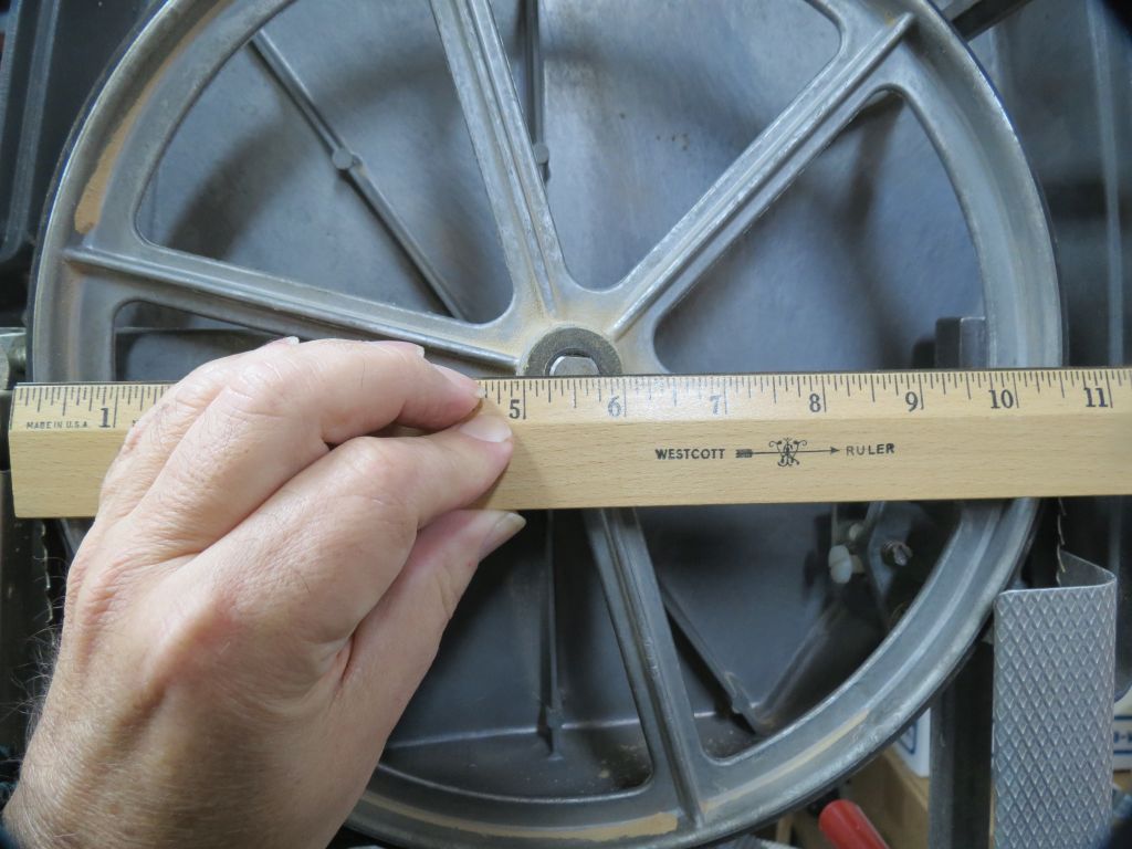

Re: Need assistance
When out and pulled the cover. Using this old scale it looks like it is quite near 11" including the tire.

Re: Need assistance
Yep! 11 inches!
Cir = dia x pi
About 2.88 feet
But I think the other Ed already said this
Cir = dia x pi
About 2.88 feet
