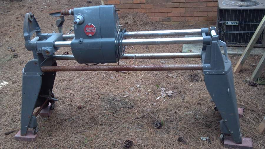

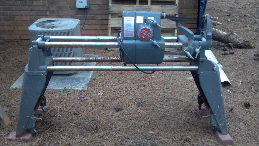

Picked this Mark V 500 up locally 2 weekends ago for $50. Just couldn't see it going to waste. Owner claims he bought it new around 12/93 and gave it to his father who didn't use it much. As you can see it has been neglected.

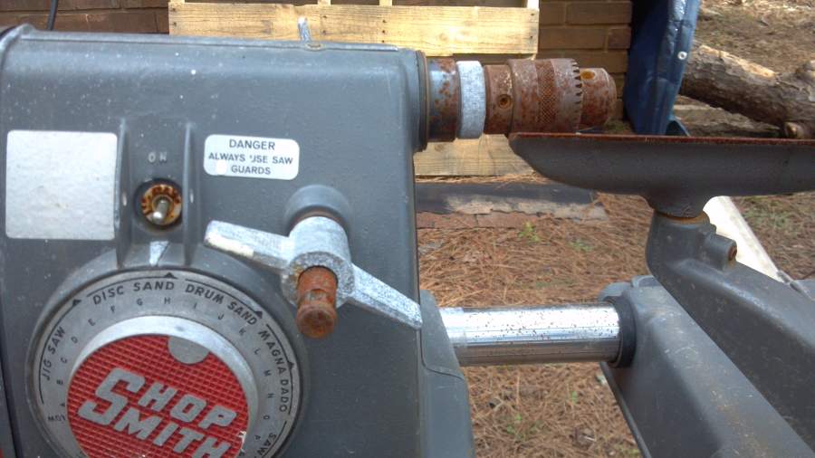

Motor runs but quill doesn't turn, belt gone with some shredded remains, motor belt is there but unattached. Luckily, the speed control is OK, the quill is frozen as is the sheaves. The drill chuck is really rusted on.

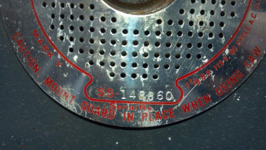

The serial numbers sequence is dated around April 1983. Which brings up an interesting question. When was the last year a Mark V 500 could have been purchased?

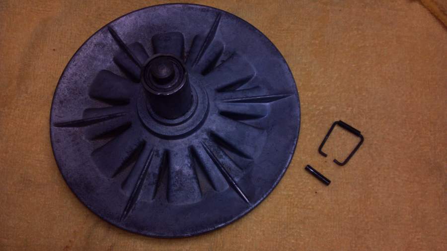

Have the headstock all disassembled (with a lot of BP Blaster help) excluding the quill(still frozen) and the parts are currently enjoying a nice EvapoRust bath.

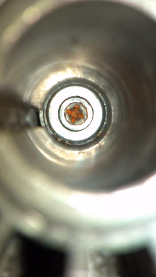

One issue I'm comtemplating is replacing the control sheave bearing. It's small and "staked" to the sheave. Anyone here attempt it before? Mine feels pretty rough, so I really don't have much to lose. I have a HF press, so I'll be removing it this weekend. Just need to find an appropriate cutter to remove the staking. A dremel grinder/cutter should do the trick.
Control sheave 1.jpg (37.47 KiB) Viewed 2107 times
Another problem appears that the "button" shaft is staked to the backside of the inner race of the bearing.
Control sheave 2.jpg (22.97 KiB) Viewed 2107 times
I think that I'll have to remove bearing and button together and then cut the bearing off with a grinding/cutting wheel.
