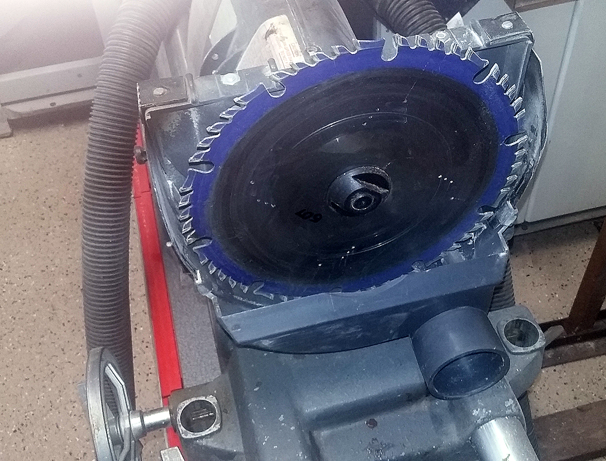

I see nothing new is out there for dust collection, several years ago I bought the current Mark V table sawing dust collection 2 piece thing, a total waste of money. with it all hooked up with a stationary dust collector, it takes longer to set it up than it does to simply vacuum it up afterwards. Any ideas on how to improve it? I see they are still offering the same one I bought years ago. I even made a lower guard out of wood that does a little bit better job, but there has to be something better.

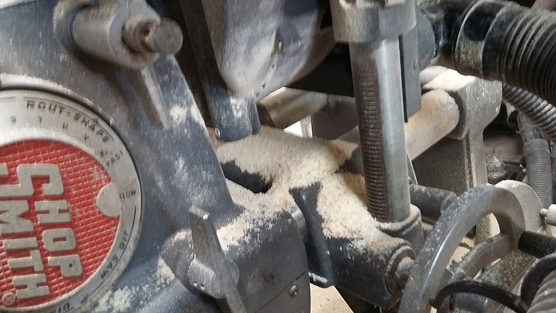

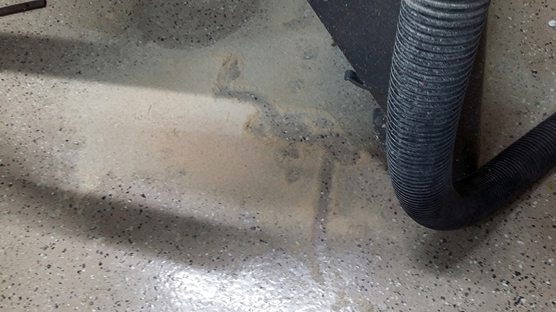

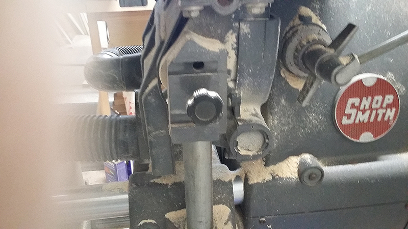

On the dust collection, the lower guard seems to catch the largest chips, but the fine dust escapes, even using 2 dust collectors, one on each hook up. Probably the use of 2 Shop vacs , with higher velocity, might do better, here are the pictures, this is after a good clean up and then making a 6' rip with a 60 tooth blade.
- DC1 small.jpg (325.37 KiB) Viewed 2498 times
- DC2 small.jpg (305.16 KiB) Viewed 2498 times
- DC3 small.jpg (322.32 KiB) Viewed 2498 times
- DC4 small.jpg (324.04 KiB) Viewed 2498 times

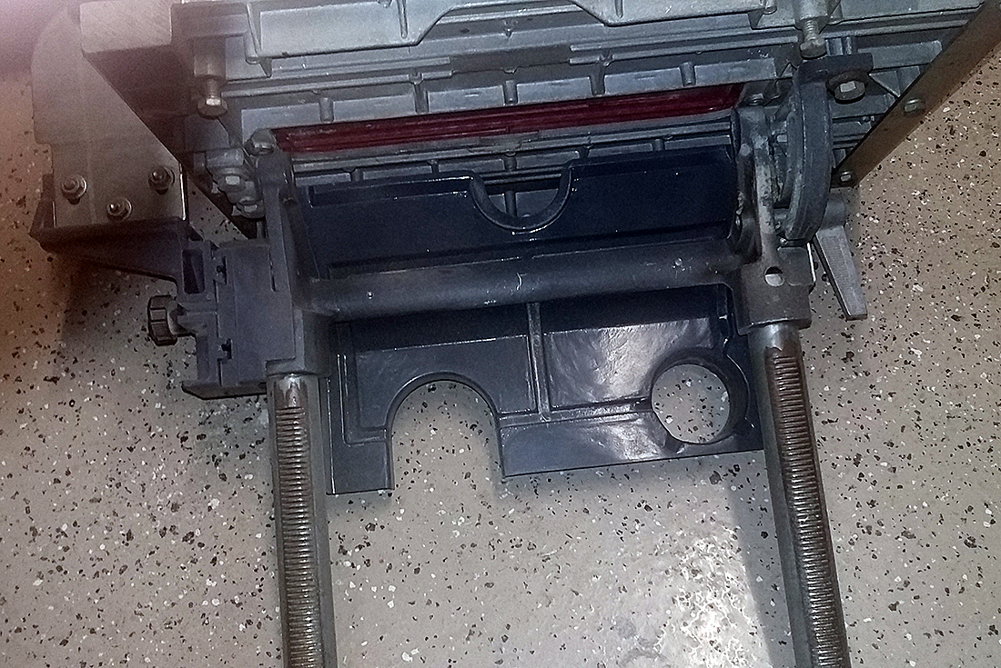

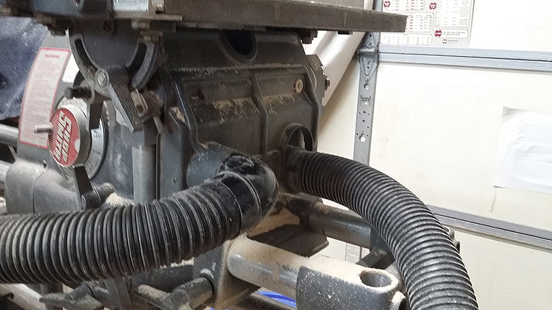

I have a Mark V with the Clear MarkV Upgraded Saw Guard System. Here are Pictures.dusty wrote:
A picture or two might help the forum crew determine and correct whatever problem it it that you are having.

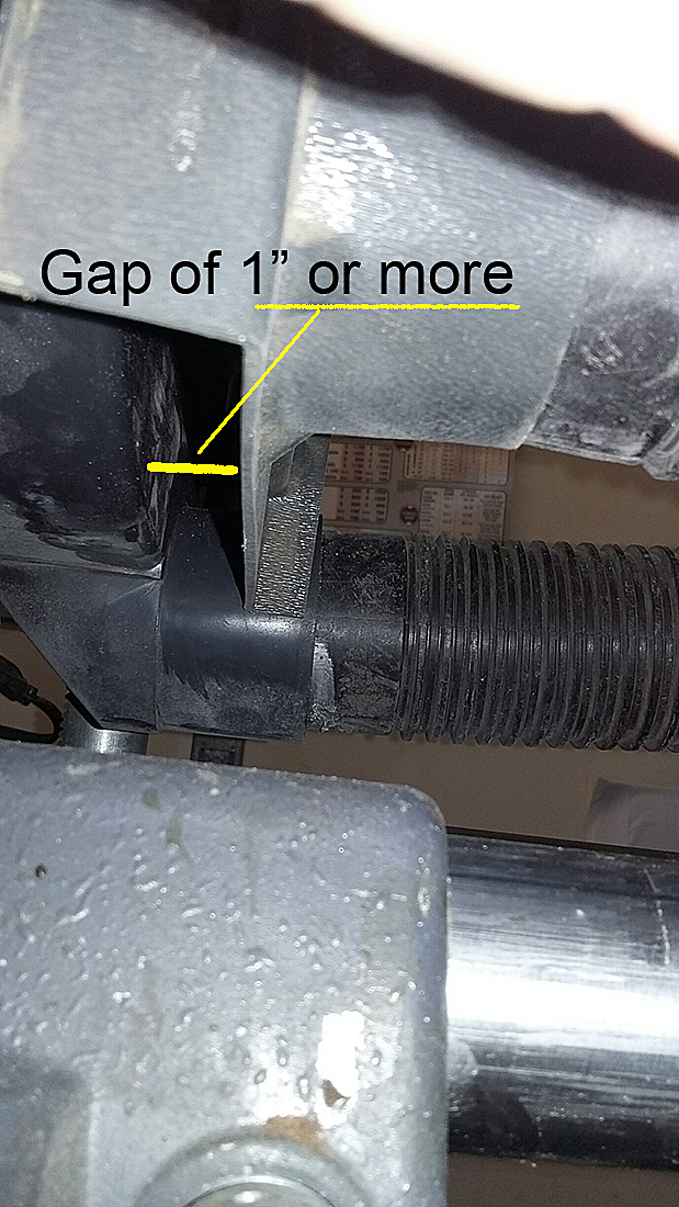

Re: Saw dust collection
http://www.shopsmith.com/ss_forum/maint ... t6063.html has a good overview of some options. In short, some of it has to do with the dual use of the dust chute for the 12" sanding disk and a 10" saw blade. If you close off the front edge a little, it can significantly improve the collection performance.
