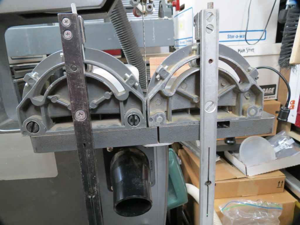

Re: miter gauge glides
Just remember that there are at least two styles of these. The one on the left is the newer one the one on the right the older. The replacements are for the one on the right.
When shopsmith did the 510 table with the ribs they had to change these so if you have a 510 or newer hardware you will likely have the new design.
Thank you, Ed. You saved me a few dollars. Both of mine are like the one on the left.
wa2crk wrote:Ed
Mine are like the ones on the right but I do have the 510/520 table and the glides seem to work OK. When I upgraded to the 510 I did not get a new miter gauge only the bar.
Bill V
That is the same thing that happened to me. The problem will show up when you have the miter gauge set at an angle. The smaller glides will come in at an angle and you will feel it if you are thinking about it....... Might seem like nothing but they did the redesign I'm guessing because of complaints.
I didn't like the all ribbed main table either. That is what I had on the 510 so after the upgrade to a 520 I was still stuck with the old table. Later I updated that table as well and I'm much happier.
BTW remember the 500 had a flat table so the design evolved but it seemed to have gotten lost somewhere along the way with the upgrades. I think the bar was a start but the protractor head should have also been included with the 500 to 510/520 kit.
