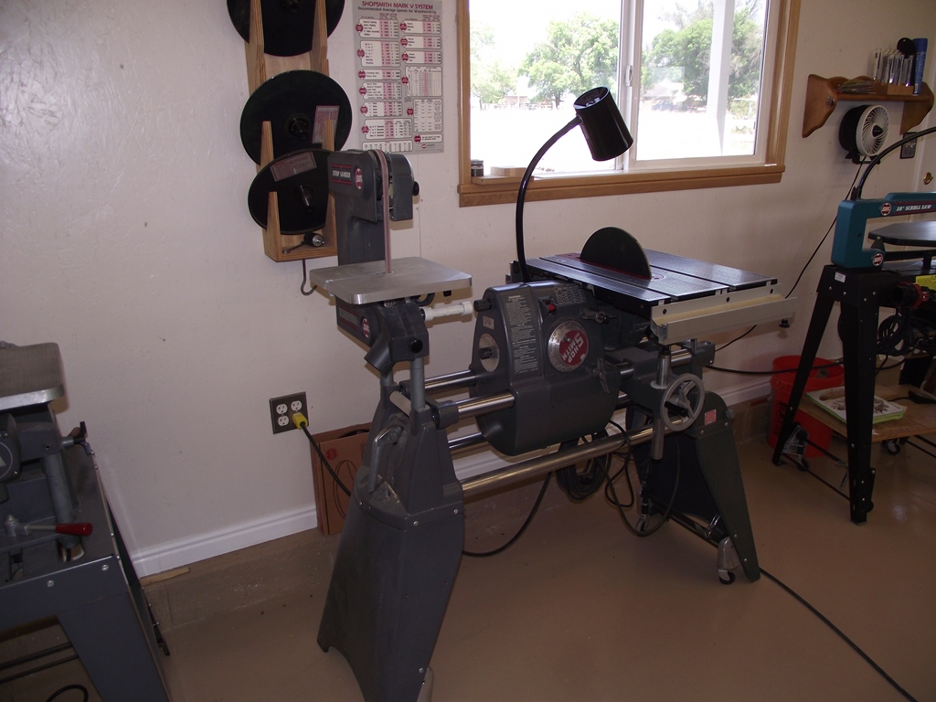

I can not speak to "what is the latest" but I can tell you what I have done. You have to determine what capabilities you want for your shorty. Do you want to be able to utilize the carriage (main table). If so, the shorty needs to be longer than some. If drill press, power station and sanding station are your only objectives, the shorty can be shorter.
I cut 16" off of the tubes to create mine. Here are some pictures of my Shorty (and my ravaged shop area).
http://www.shopsmith.com/ss_forum/viewt ... ty#p179760
You can see that with a drill chuck attached, there is very little clearance between it and the main table.

Nice looking job Dusty. Thank you.

As Dusty says the length is determined by what you want to use it for. I cut 18" off when I made mine. In drill press mode it was a little light on the left end without an SPT installed. My wife used it for a long time to drill holes for her scroll saw projects. I used connector tubes and telescoping legs to support the table so it would not tip in case she leaned on it real hard.
Now that we have dedicated 10ER and MK V drill presses it is used primarily as a sanding station.
