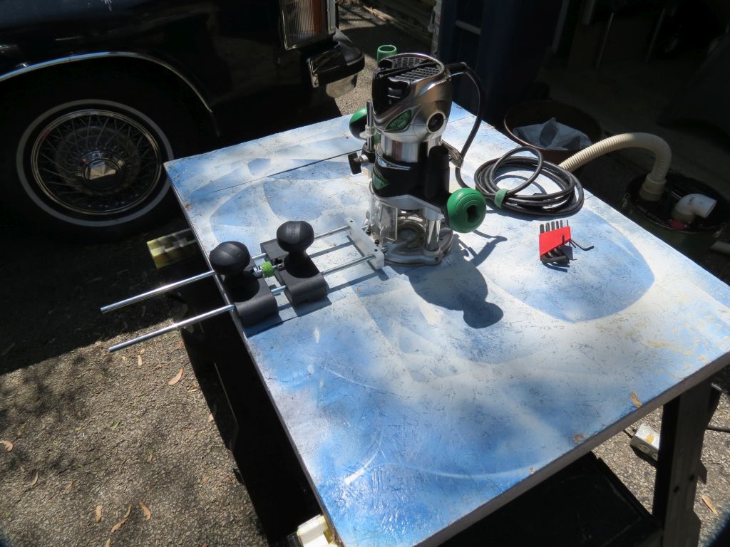

I was wondering if I could adapt my Hitachi router to fit the Festool rail system and their adapter. It looks like it might work with a transition piece between them. I have some parts on order so I can check it out.

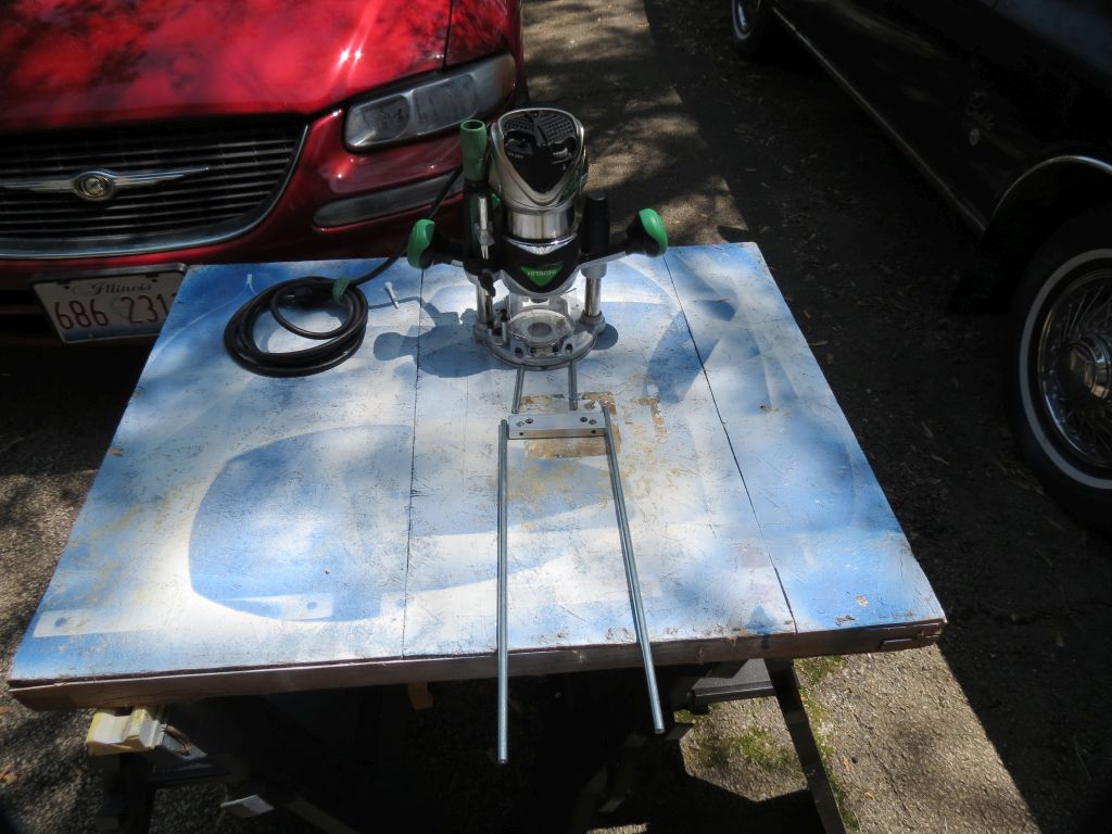

Had to order a block of aluminum and the plated rod and stop at Ace for some set screws but it is all together now. As always here are the pictures to prove it.
Posts: 3815
Re: Anyone own a Festool 1400 router and could get a measurement
It appears that one end connects to your Hitach router. Where does the other end go?

BuckeyeDennis wrote:It appears that one end connects to your Hitach router. Where does the other end go?
Festool rail system?

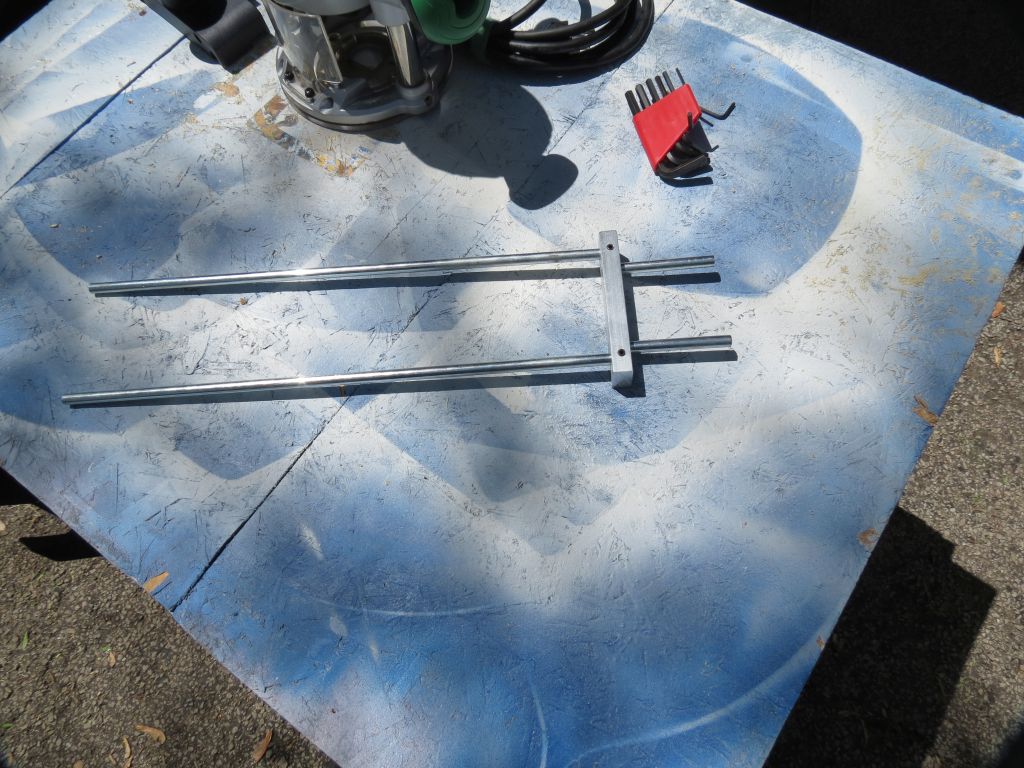

This is the "other" end.
