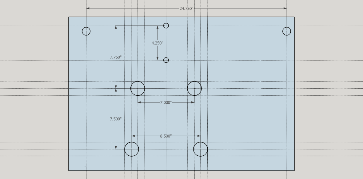

If you have been following the thread on Extension Table alignment, you are aware of the issues that I now believe impact Extension Table interchangeability. The contributing factors are several but one of them is the relationship of the Way Tubes to the Bench Tubes. The Ways must be "centered" over the Bench Tubes to achieve proper alignment.
With the 510, the Head Rest lock does this to some degree but I have prepared a video that is intended to show how ineffective it is. To completely understand, you will probably need to do this for yourself on your own 510 (with or without Double Tilt). With Double Tilt there is less movement but there is still some.
This video clip does nothing more than communicate to those interested, what I am attempting to show.
Shaft and Tube Angle Verification.png (107.97 KiB) Viewed 3535 times

What are the two upper/outer circles?

JPG wrote:What are the two upper/outer circles?
Extension tubes for main table?
Re: RE: Re: Mark 510 Tube Alignment
Thank you! Before JPG asks or otherwise makes the point, this sketch is not intended to depict the vertical movement of the Main Table (thus the extension tubes).
I should probably modify that drawing to include a saw blade too.
