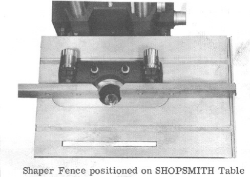

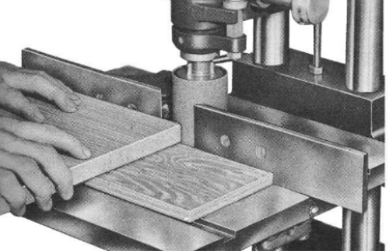

Re: Er Shaper Fences
Post by lyall »
shaper on mark V.png (136.71 KiB) Viewed 2403 times
shaper fence for Mark V
shaper ss 10er.png (167.08 KiB) Viewed 2403 times
shaper fence on SS 10er
