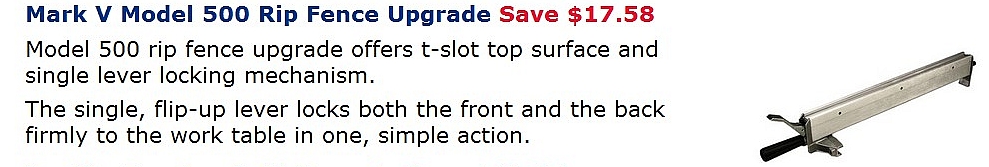

Since I cannot attach a jpeg file to a PM to Admin, I will do so here.
The fence does NOT have only a single clamp. The knob tightens the front clamp and the lever operates the rear clamp only.
500 rip fence upgrade description wrong.jpg (114.43 KiB) Viewed 2259 times
Or has the design been altered without my knowledge. ;)

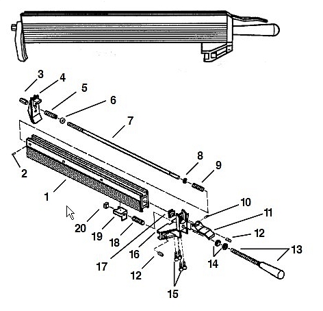

No, it is like
500 UPGRADE FENCE EXPLODED.jpg (87.32 KiB) Viewed 2183 times
13,14,16,18,19,20 = front clamp
2 - 12,16,17 = rear clamp

It looks like MY OTHER Delta Fence it locks in the back as well, Rod #7 is adjustable for the rear tension on MY Delta one.

ERLover wrote:It looks like MY OTHER Delta Fence it locks in the back as well, Rod #7 is adjustable for the rear tension on MY Delta one.
The rod/lever/etc. does NOT lock the front. Yes it will 'pull' the front(16) towards the table, but it does not 'clamp' it.
I think a difference of opinion as to what clamping is perhaps.
Personally I would not use it without securing the screw actuated front clamp 'first'. Maybe that is a 'Mark 5' habit/mindset. The Mark 5 clamps both with a single 'screw' handle sequentially.

Well I took a closer look at my bandsaw fence(same as the 500 upgrade fence, but is shorter).
It could indeed be described as 'single lever lock'(I WAS UNINFORMED[IGNORANT] :eek: ).
As I said above the lever lock will also pull the front into the table. It appears that clamping action is quite secure.
So clamping with the front screw lock is apparently not necessary.
Makes me wonder why the entire front clamp set of parts were retained.
I think a screw and knob are likely sufficient.
So I will uses it without setting the front clamp at all 'going forward', but do not use it very much so the jury will be out fer a spell.
Sorry if I have confused anyone! :o
