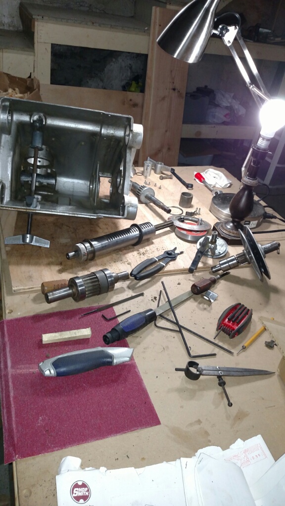

- First is the complete messy tear down

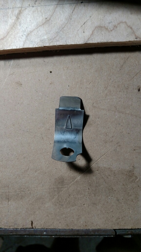

- Unknown part. I feel like it fell out when I took the speed changer off but not sure..

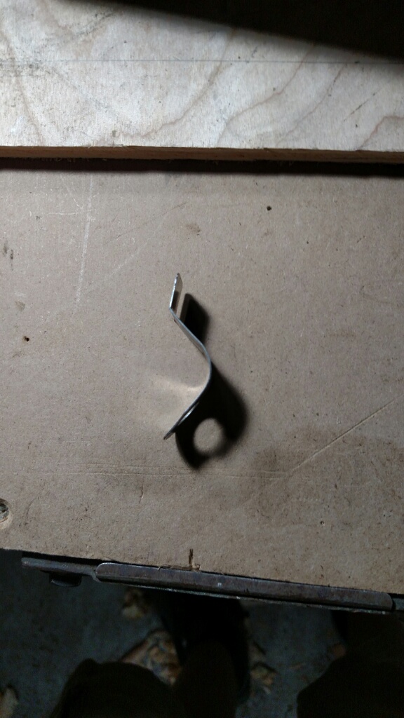

- Side view of unknown part

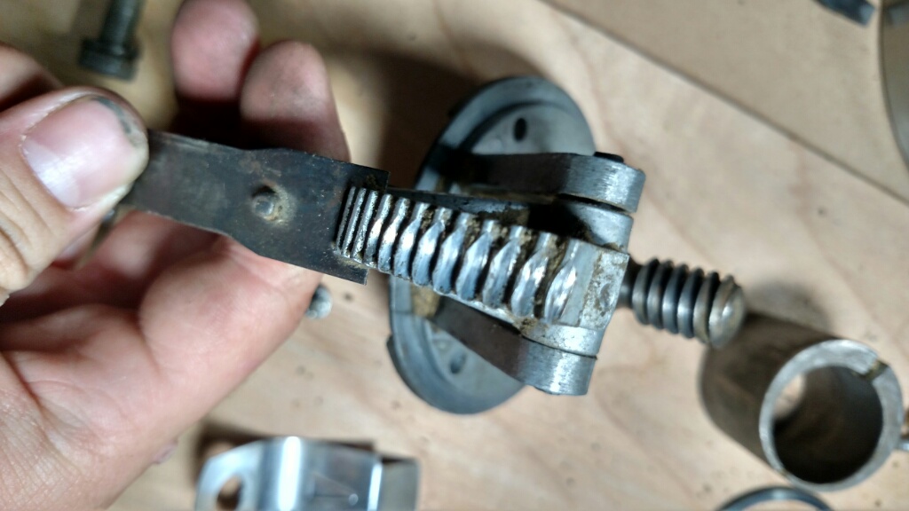

- The "pork chop" with teeth a little rough. I feel I should replace it but want to make sure.

That part rubs on the back of the speed changer dial and fits in the 12 o'clock detent on the top of the opening for it in the headstock.
You guessed well. Later model case has a spring that goes across an opening in the same general area.
Based on this and the two small holes visible in the photo opposed to an inspection port opening on the back side under the removable logo plate, it is clear you are working with an early Greenie, and one of the heavier sand cast "A" style headstocks.
This anti rattle / locking clip was used exclusively with "A" series headstocks.
See post from JPG http://www.shopsmith.com/ss_forum/viewt ... 40#p202240
Everett
Everett

That's where I thought it went but couldn't figure out how. Probably because everything is in little pieces. Thanks!

Be careful with that light (shocking)!
Re: Greenie Restoration
Haha I took the cover off last night to find a set screw that had fallen on the floor and took the pic right before I cleaned some stuff up and put it back on. So no worries no electrocution here!

Since you have already broke it down, I suggest a couple of 'alterations. The control sheave needs an oil hole in the hub.
Ditto the floating sheave on the motor shaft.
I would replace the porkchop and reassemble with Bill Mayo's 'fix'.
I would not add the access hole.

Well JPG, he might know who Bill M is, give a bit of info or a sight for him
Jesse cant find him to post, time to put mom to bed.
Here tis!
JPG, thanks for the link and advice. How would I go about adding the oil holes? Do you just drill into the hub? And although that PDF on "the fix" looks like a great idea, I have a good feeling that I will end up messing up and/or breaking something trying to do that. This is the first "machine" I've ever worked on so any alterations are quite nerve racking.
Basically yes. A small(1/8") hole near where the hub attaches to the pulley sheave into the keyway groove. Removal of any burr inside the hub bore will be needed. The burr can be minimized by creeping up to the final hole size.
Use of a drill press is advisable.
