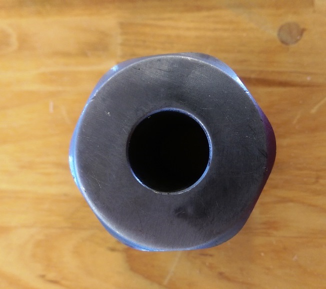

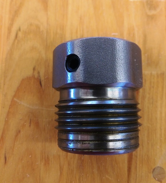

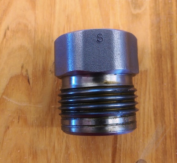

Any Chance we can get a picture of the SS NOVA adapter? I have a NOVA with an adapter but I think its a different style from NOVA's.

The SS adapter has a 5/8" smooth bore as expected but it has an angled set screw to match the tapered flat on the SS spindle like most SS arbors/adapters. As such it is stamped with the letter S to indicate it is SS.

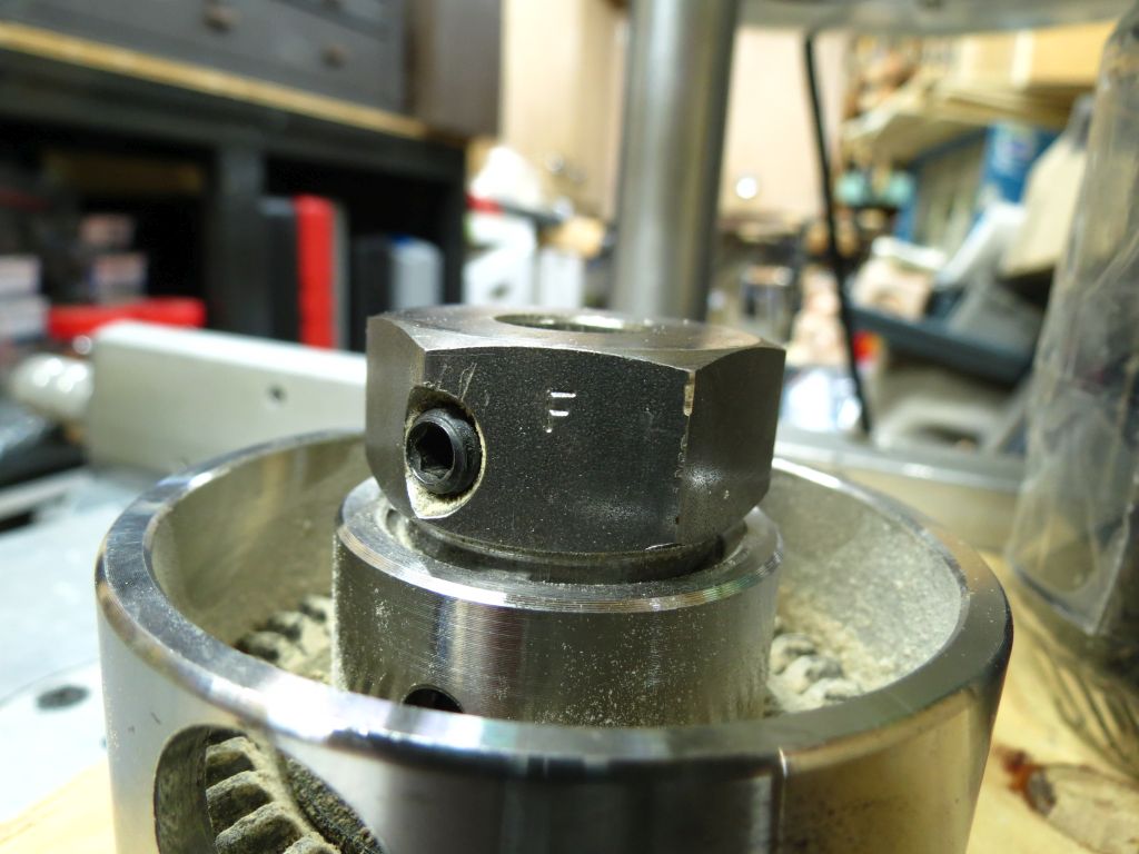

Re: Nova G3
A couple of things to mention here. First if you have the older adapter that came from shopsmith with the G3 from say back in 2006 the stamp will have "F" stamped on it. It has the correct angled set screw.
For a short period of time some of these chucks were shipping with the wrong adapter, the set screw was not at the angle but would have been fine on a plain 5/8" shaft but not for the shopsmith. If you have one of those you need to check and make sure the set screw is at an angle. If it is not then you have the wrong insert for a shopsmith.
