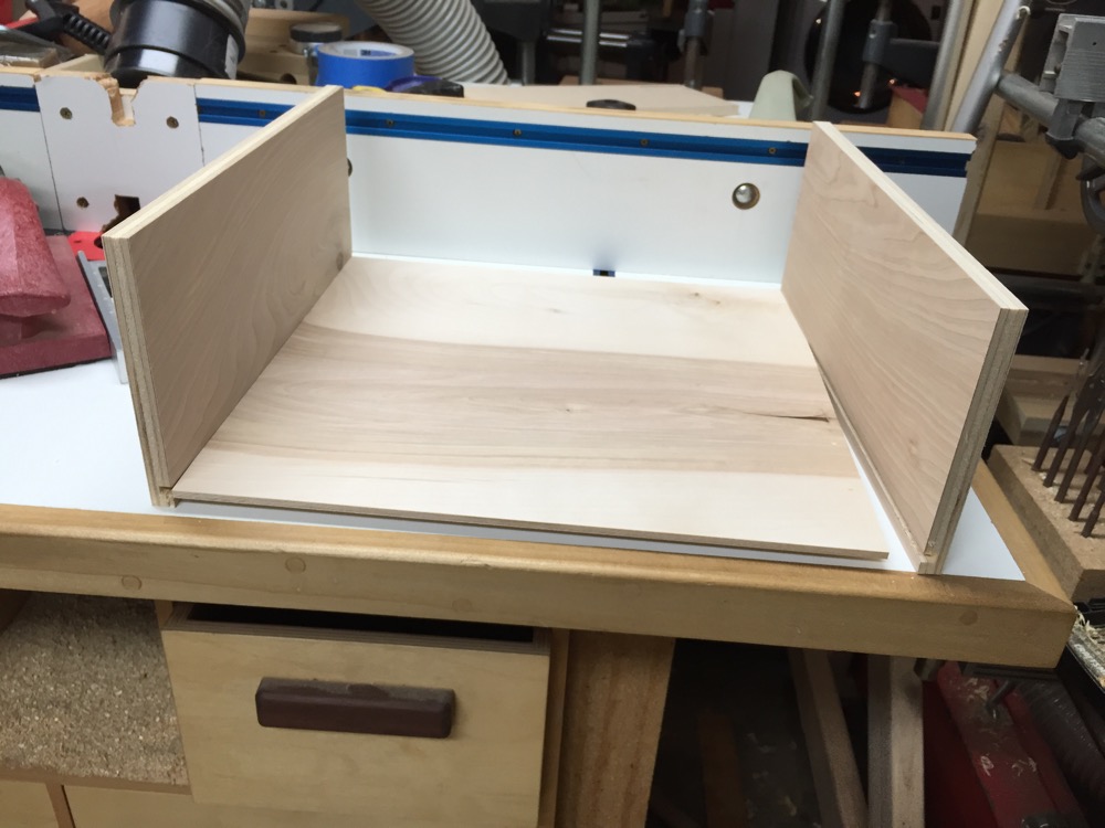

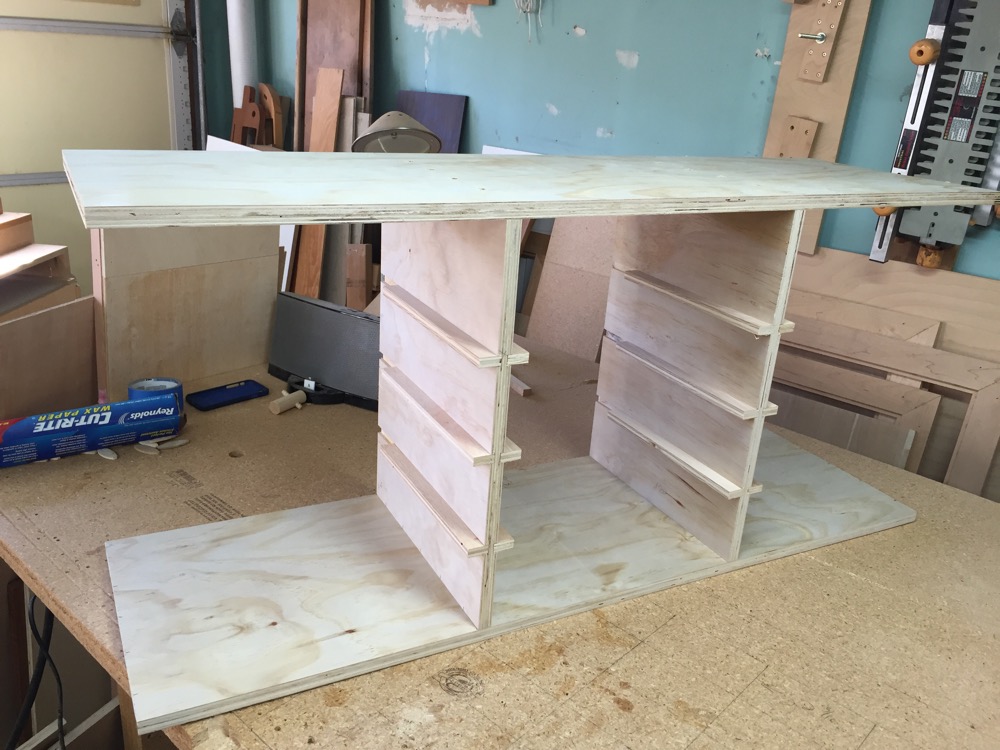

Off to a decent start. A nice new Freud blade cuts like butter... Now if only my Dado didn't tear out like I carved out with my own teeth. Next up, my first attempt at drawers for the center. I figured I would use this as an excuse to attempt an upgrade to my first incarnation.
Oh also I avoid the Dado cutters through the back, I figure 2 sides for the shelves are enough, looks much better in my opinion.
Still maintaining the removable hangers so the cabinet can be unmounted from the shopsmith if I ever so desire,and keep it intact but for a few bolt holes.

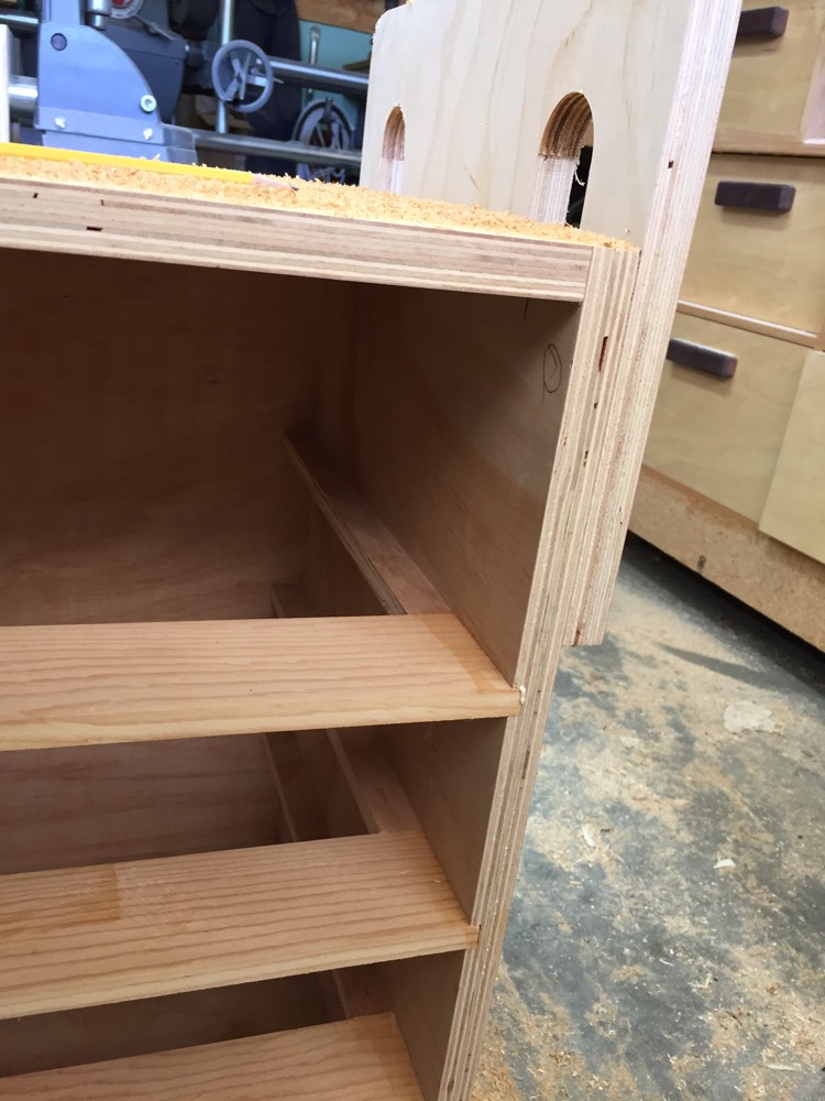

Final verdict of my previous design and plans, very precise for the 510 and 520 model. Table tubes come down on both sides of cabinet with only a few millimeters of clearance. Same with the height. Can't wait to see what the premium casters do to the added weight. Here is a picture with the drawer front panel on the table, still need to evaluate drawer sizing.
And here is a picture side by side with it's older brother.

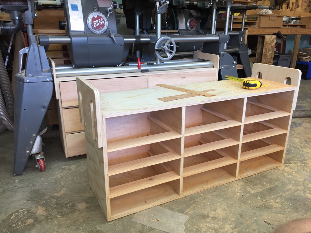

So I decided to follow your lead Beav and started making the ubiquitous ( don't you love that word !) SS storage cabinets. Got one done and the carcass for the second one done. Two more carcass' cut out and wafered. Lots of sawdust today !

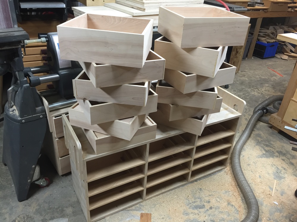

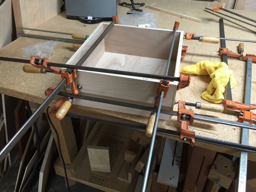

Productive day yesterday in the shop. Got all twelve drawers cut and glued up. Now I have to size them and install it on the SS. It was complicated by the fact I copped out and went to HD to buy an additional piece of ply for the bottoms. My other choice was to wait until today to buy it from my usual supplier ( Austin Hardwoods). How is it the world can't even make metric plywood at a consistent thickness. I can live with the metric vs standard as I have the metric router bits for 7/32 ply. This stuff was closer to 1/4" but not quite. Not earth shattering but it is annoying. I had already routed the slots for the bottom using the metric bit but only had enough of the ply to make five bottoms. I used the HD ply to make the other seven but had to reroute them at slightly wider to get them to fit. Any way apps well that ends well.
