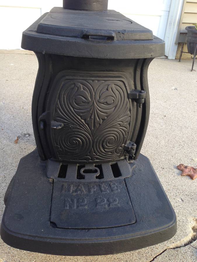

Got wood?
Tons of them on CL up your way. Asking price is $250 for this one, including the stove pipe.
http://greenbay.craigslist.org/app/5739174762.html
