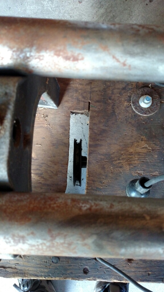

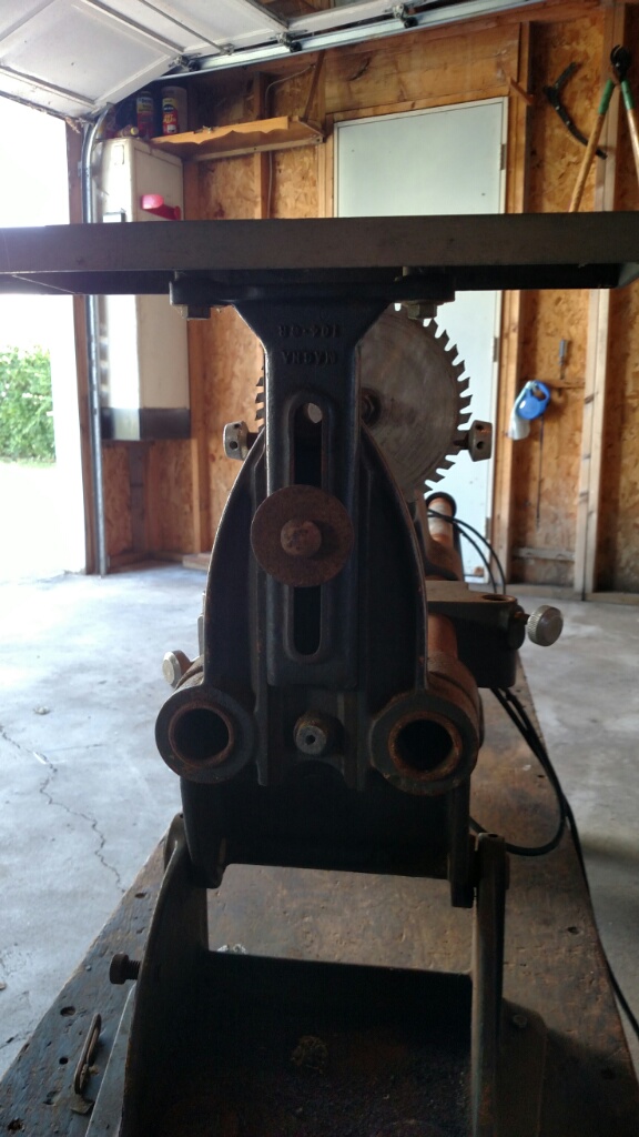

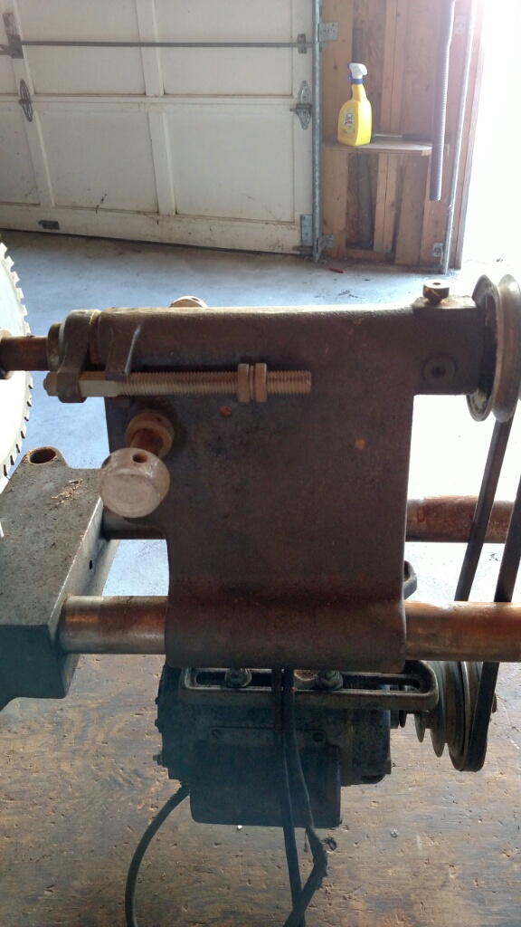

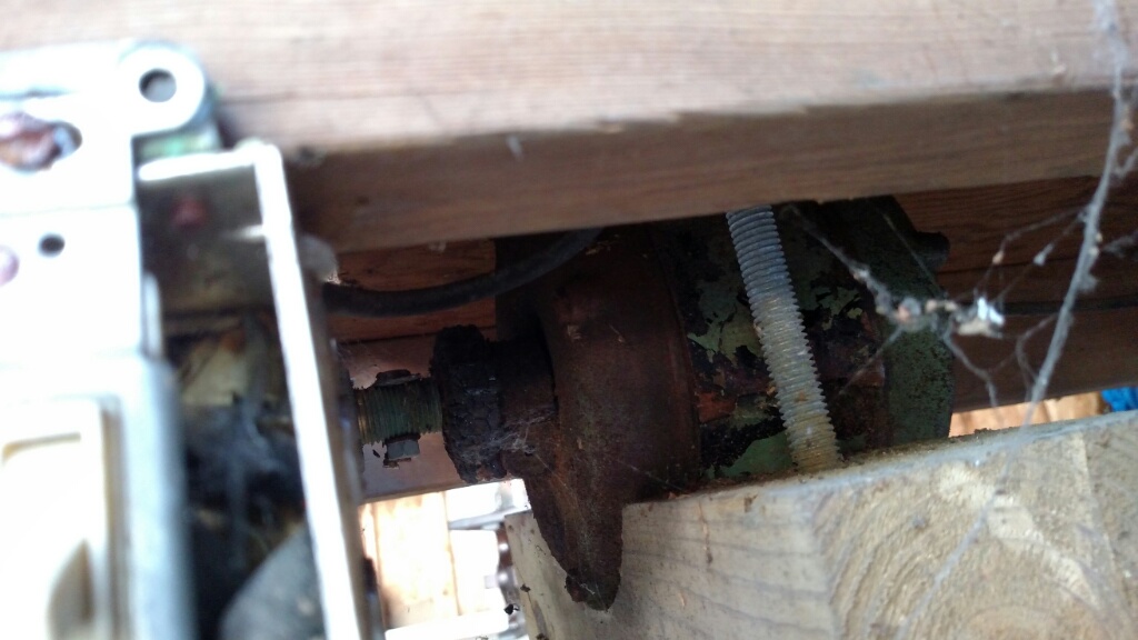

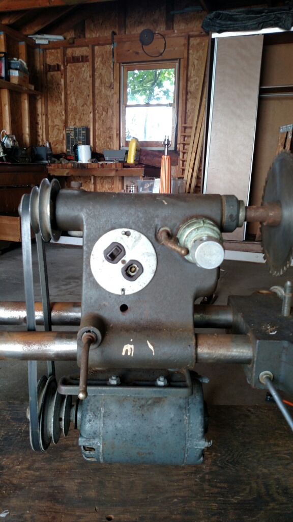

My last post was about a possible 10ER purchase and questions about it. Today I went to look at it and it is being sold by a guy who is taking care of his brother in law's estate. He knew absolutely nothing about the shopsmith. Didn't even know it was a shopsmith. After talking for a while and giving him some history he said he will hold it for me until next week. He plugged it in and it ran surprisingly good. One upsetting part is the gentlemen that owned it replaced the name plate with a piece of sheet metal that houses a house hold light switch to turn the machine on/off. Now for the weird part, at the end of the "bench" the gentlemen installed a second motor. I can't tell why or what it was used for. Any ideas? The last photo is of the motor but it's hard to see. You can see the pulley in the second to last photo. Oh also the table is present with fence and miter gauge but I took it off.

Too bad about the ID plate. I think I have only seen one or two come up on eBay in years of watching eBay. Bill Mayo, Skip Campbell or Hogwinslow might have one. I would check with them.
As for the second motor, the only thing I can think of is that he had some other tool (jointer, band saw, etc.) that he clamped to the way tubes and used that motor to power it. It certainly is not a Shopsmith thing.

I figured it wasn't anything to do with the shopsmith and that was also my idea. I might just leave the switch how it is depending on what the rest of the electrical looks like. I'd like to make it original but if he's got it messed up in there I don't want to mess it up even more.

Hey Tyler,
Check with the folks John mentioned and get into the ole gal and make her right. I couldn't stand to have one of my ERs look that way! The switching is very simple and you can always add it along side the headstock. A replacement badge would be of immediate need to have...
The second motor was either for another attachment or possibly an improvised speed changer. If the headstock was positioned so a secondary belt could be slipped over one of the original motor pulley grooves, He may have run the bottom motor only and used the original motor as strictly a pulley system.

There is nothing to mess up. The wiring is as basic as any wiring gets. The power cord from the outlet hooks to one side of the switch and a cord from the other side of the switch connects to the motor. The connections are the same as the ones the other guy changed. Just go to Radio Shack and buy a toggle switch rated for 110V and a 1/2HP motor or greater and fix it right. Then find an OEM logo plate to replace the ugly thing someone changed.Tylerh wrote:I figured it wasn't anything to do with the shopsmith and that was also my idea. I might just leave the switch how it is depending on what the rest of the electrical looks like. I'd like to make it original but if he's got it messed up in there I don't want to mess it up even more.

Here is a badge, you might want to go quick. It has a buy it now price of 9 dollars or so ...
http://www.ebay.com/itm/Name-Plate-Or-B ... Sw~OVW03Oz
The switch can be found on ebay as well, just do a search. It has a red plastic safety device on it. I put one on my first 10ER and it is great. Like it has been said, there is nothing to mess up in the headstock.

That badge was 'ripped' off the headstock. The holes are now 'open'. Better ones have been there before.
