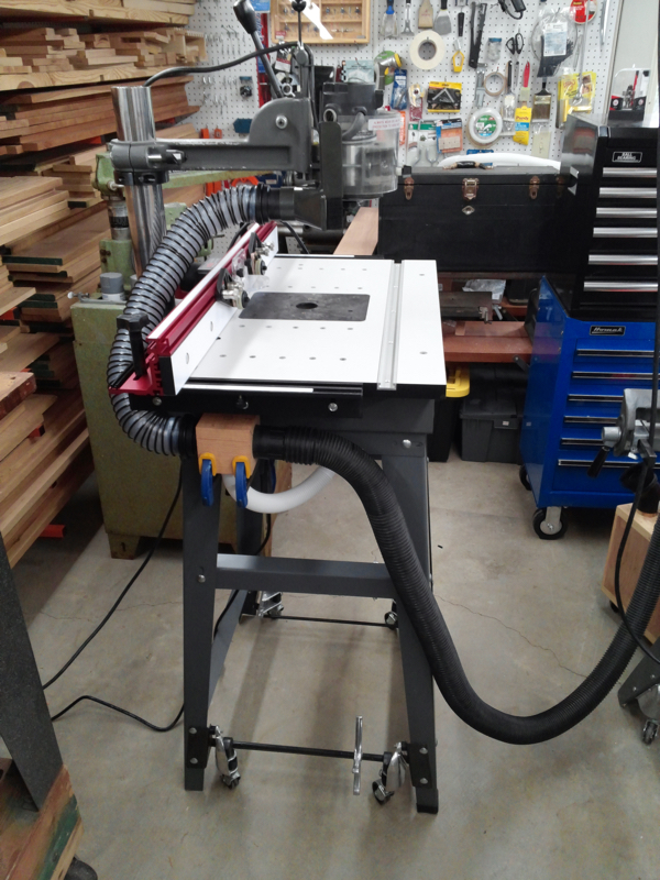

Dick, this is what you really need. Manufactured by Shopsmith. Well, except for the router motors and aftermarket fence, that is. If the column is in your way, loosen one bolt and it will slip right out. And the overarm part is awesome for router inlays, including making your own patterns. Also great for making repetitive copies of stuff .. that's how it was done before CNC's were invented. (Well shoot .. see below. For the last couple of days, inlining a pic from my iPad isn't working.)
Might be a bit hard to find in NM. I can watch CL for one in Ohio, if you're not in a big hurry. I usually see them once or twice a year. The fence cost more than I paid for the OPR itself.
Meanwhile, I would think that a handheld router, in conjunction with some supports of thickness equal to your rail/stile assembly, should work fine in conjunction with bearing bits. If the rails & stiles are already cut and assembled, and you like the rounded interior corners, why would that not work?
