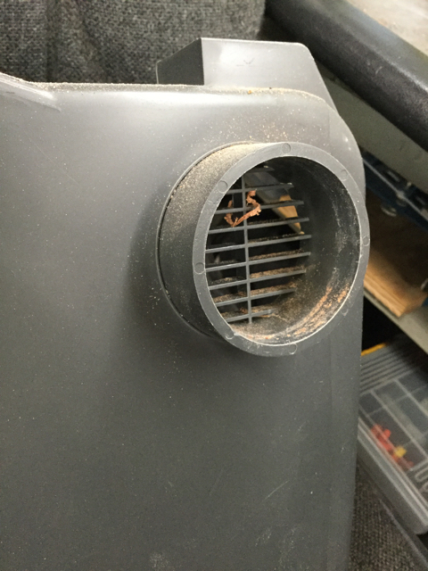

That's really strange about the cover quality problems .. aside from being smashed in shipping, anyway. I bought that same item a couple of years ago, and the quality was fine. I just took a pic of the dust-port cutout, below. Until your post, I had never realized that the port was glued in, rather than molded in.
I also just checked the thickness of the plastic on mine. The edges are thicker than the interior, so my dial calipers couldn't reach the thinner parts. Rarely-used micrometers to the rescue ... I measured between 0.130" and 0.140" on all the spots I could reach.
Sounds like maybe SS got a new vendor, or lost a good QC hand, or both.

Looking at it a little closer, think your right might be a QC problem. Only place it is thin is where it broke and has the white plastic stress mark across the cover to the opening, the hole I thought was ragged is actually glue squeeze out, just scraped it off some the hole is fine. Still going to have to send me out a new cover, this is cracked and looks bad with the white stress mark running across the cover. Looks to me like it didn't get molded right and missed on QC, if they even did a QC on it. It may have got bent during ship, but looks more like it was just thin and broke because of it.BuckeyeDennis wrote:That's really strange about the cover quality problems .. aside from being smashed in shipping, anyway. I bought that same item a couple of years ago, and the quality was fine. I just took a pic of the dust-port cutout, below. Until your post, I had never realized that the port was glued in, rather than molded in.
