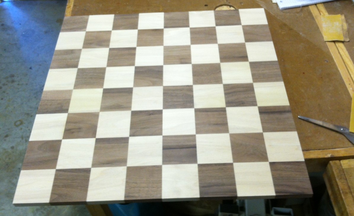

Yesterday, I was about to square up the glued up alternating black and white boards for a chess board. Going for 2 3/4" squares, the board was a little over 22"x22". The chore was to rip out 8 boards each 2 3/4" wide. This would give me 8 boards of alternating black and white squares.
To do this would require correct alignment of the 510 table with the saw blade. So I got out the dial indicator. The table hasn't been aligned for at least 6 years, and the shopsmith has been moved all around my shop, sometimes on a rubber pad, sometimes on concrete, sometimes half and half (a twist of the tubes). It hasn't been treated gently - just reasonably.
Okay - now the story - The blade checked out at .003" deflection. Not too sure of this measurement after reading all the horror stories in the forum, I rotated the machine 90 degrees and measured again using both miter slots. Well they repeated the same .003". Aren't 3 little marks on the Shopsmith Dial indicator = to .003"? Anyway it is still pretty well aligned.

charlese wrote:Yesterday, I was about to square up the glued up alternating black and white boards for a chess board. Going for 2 3/4" squares, the board was a little over 22"x22". The chore was to rip out 8 boards each 2 3/4" wide. This would give me 8 boards of alternating black and white squares.
Be confident that those readings are correct! I have said all along that if the Mark 5/V was properly aligned that it would maintain that alignment even through 'heavy use'. A very important factor is the five locks. Not so much the quill but the other four must be secure to get repeatably accurate cuts.
I remain satisfied with mine. I added the double tilt but I do not believe that improved either accuracy or repeatability. It is hard to improve upon .005".

They sawed square and glued up square. Yes, I have confidence that the machine will hold alignment through many operations and many years. When measured corner to corner - this board measured 31 7/8" both ways.
chess board.JPG (174.8 KiB) Viewed 3174 times

Nice job. Did you use a sled or just the shopsmith miter gauge?
Re: Amazing? No just true
Shopsmith miter gauge with Shopsmith 20" Aluminum extension. Fence with a starting block for width of cuts. Did a trial piece first to make sure the width was correct.
