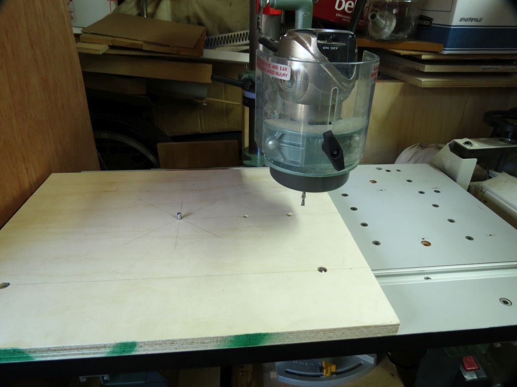

This is a pin off set fixture. It is nothing fancy nor does it have any exacting size requirements or measurements. Not only that but it also works on the shopsmith for doing some offset drilling.... so what have you got to lose in checking this out??
This would likely work with the newer OPR but I don't have one to check it out on. Feel free to make one and let us know if it does work.

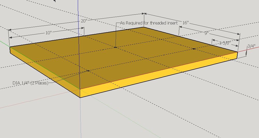

This is the whole design:
Parts wise this is a cheap piece of (3/4") handy ply that was left over after some project or another. The over all size was pretty much what I had left over and then resized to even numbers. If you want to use it on your shopsmith in drilling operations make sure that you can get a good fit based on the depth of the drill press.
If your piece is squared then the process of locating the holes can be done as shown. The center most hole is for a threaded insert that fits the "pins" of the OPR. I forget the thread, is it 10-32??? Anyway check that and find the correct bit size to drill the hole and then insert. Note the measurement places it centered on the width and 9" back. Again this is not critical but just what I used.
The other two holes are for shopsmith t-nuts. If you wish you can just use clamps to hold it in place and indeed that is what I had to do for some of the drilling I did with the jig and it worked fine.

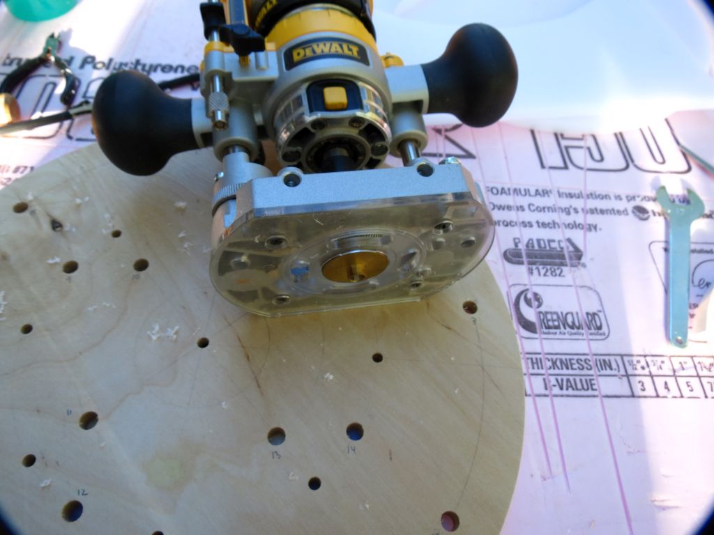

I neglected to take any photos of it just sitting on the shopsmith main table for the drilling operation so you will have to make do with this photo of it on the OPR.
Here is where I needed to go with clamps to hold it in place:
In the next post I'll show you how it works.

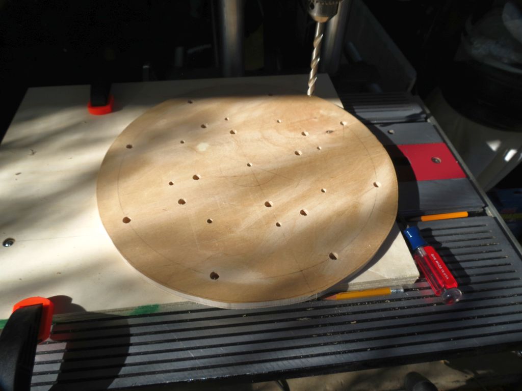

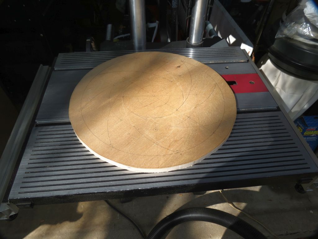

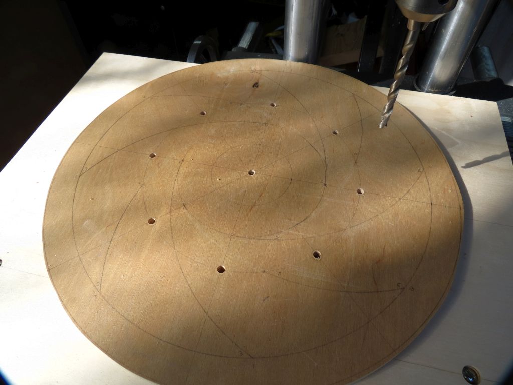

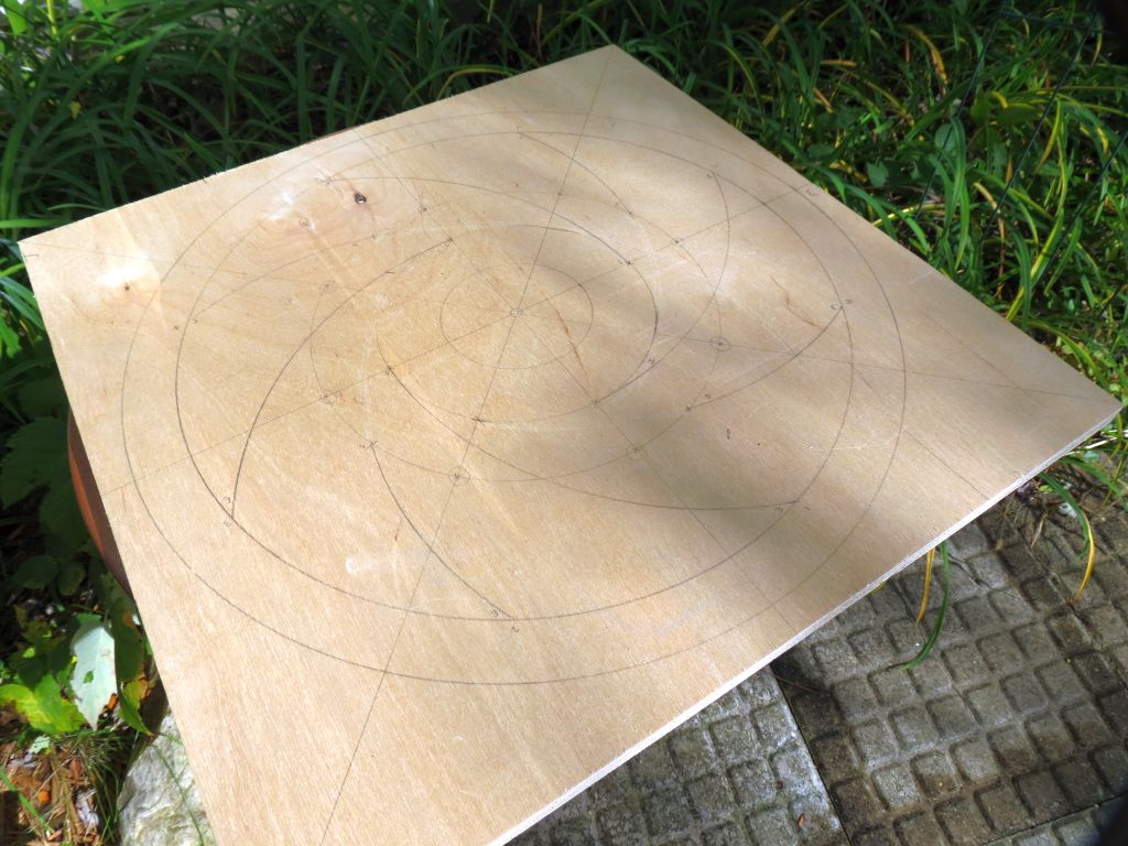

I did a layout of the template on a square piece of plywood. The end part will be round but it is easier to do the layout when you can go corner to corner and find the center of the piece. Then adding a vertical and horizontal line and you end up with the piece segmented by 8 lines. It just so happens that is what we need to make this, nice how that worked out.
The lines are hard to see but this is about the best I have on hand to show it.

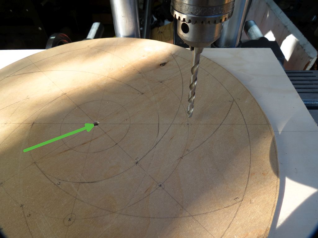

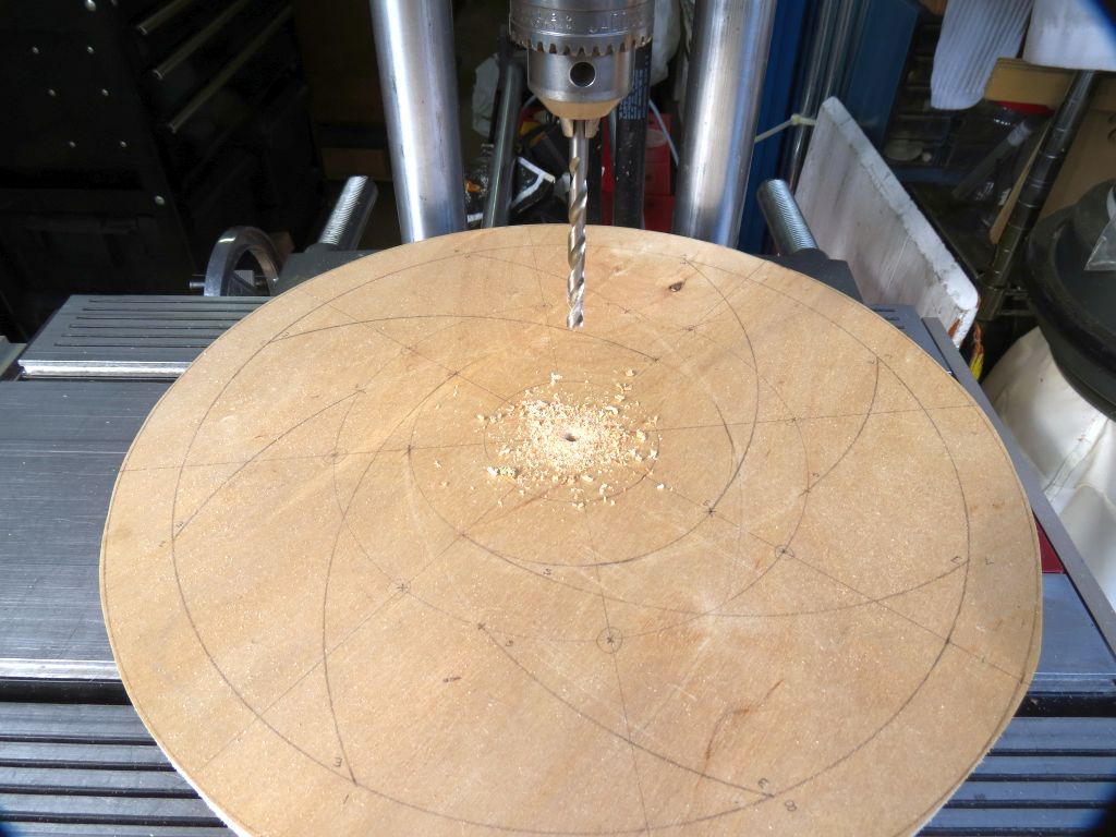

We are not going to cover the hows and whys of all the lines and how I figured them out. The important thing is that there are holes what need to be placed at accurate locations based on other points located on the fixture. The first and most important starting point is the center hole. But first I wanted to get the fixture a bit more round. Since later I'll be truing it with the OPR I just cut within a 1/4" or so out side the line.
After taking my time and making sure I was on center I drilled the center hole.

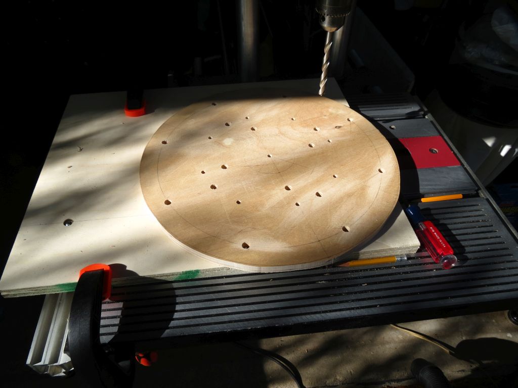

At this point it is time to mount the fixture and set up to drill the 8 pivot holes. The holes are all equal distance from the center hole and are on one of the 8 lines that radiate out from the center. Since the holes are all the same distance from the center hole I can use that fact to locate the holes. I can do that by moving the fixture so the pin is off set from the drill press center line like this:
The pin is now where the arrow is pointing. The line from the pin to the spot I want to drill is then controlled as far as distance and I am left with just making sure it is on the line. The nice part is that all 8 holes are the same distance from the center pin and just need to be rotated into position.

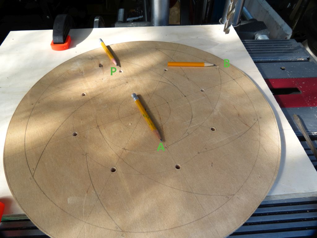

All of the holes thus far have been 1/4" which is the same as the pin from the pin router. One could use either of the other two sizes, those being 3/8" and 1/2" but for me the 1/4" was a better choice for those holes. The next holes I will use a 3/8" bit. You will see why later. But first......

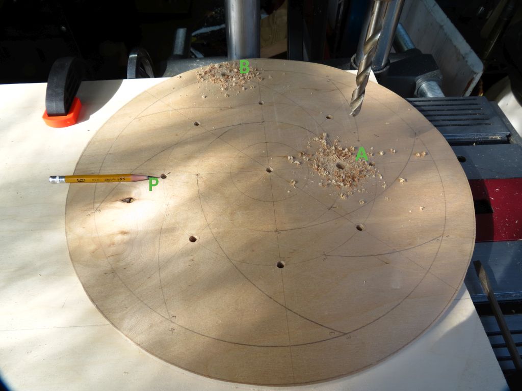

The 8 new holes are pivot locations. In this case they are used to create the arcs by placing the template on the pin and then drilling the two end points. Anyone have an idea why we need the end points? That will be obvious ones we get to the router table.
OK then lets look at that arc. In the next picture the "P" is the pivot point and the two parts of the arc are labeled "A" and "B". This design calls for 4 longer arcs and 4 shorter arcs. The one shown is for a longer arc.
To locate the holes the point "P" is placed on the pin in the fixture. The two holes are then an equal distance from the pin and the other location is on the ray lines.
The template is then moved to the other 7 locations and those holes are drilled. The end result is this:

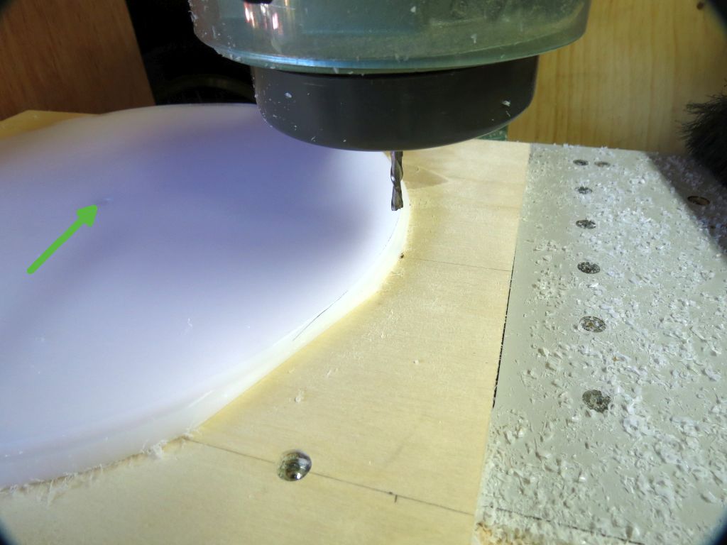

Using the same OPR set up you did to round the template you can round the two work pieces. I did take a picture but it not all that clear as to what is going on. The arrow points to the center hole that is on the pin. As you can see it makes a lot of plastic chips..... I like to go about two steps depth wise into the work piece then flip it over to finish the cutting from the top side.

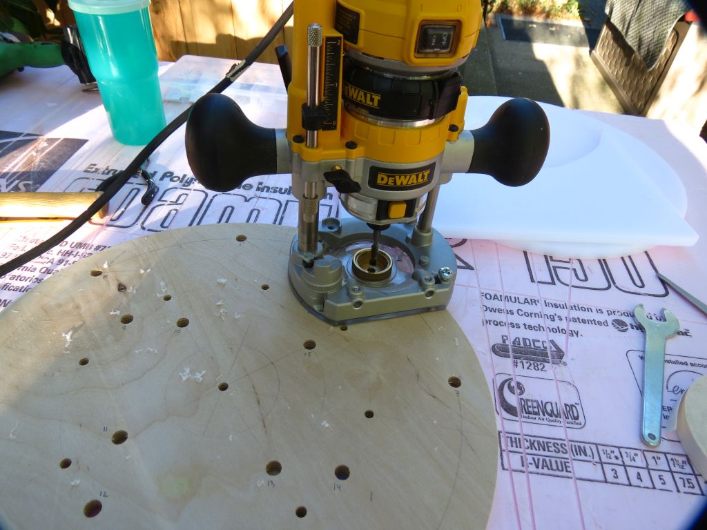

I debated here as to how I'd do the next step. I have modified my OPR to be able to use template guide bushings so I could do the next steps with the OPR but I think I'm the only person in the world with that capacity so I figured I'd go with a conventional plunge router set up. BTW I have a posting some where here with how to make your older OPR take template guide bushings if you are interested.
If you remember back a post or so the I drilled all the end hole of the arcs with a 3/8" bit. The reason for this is so I could use a 3/8" guide bushing in a plunge router to make the start and stop holes in the work piece.
The router setup looks like this:
Note the barrel of the guide bushing goes in the 3/8" hole and then you plunge the bit through the work piece. By having 3/8" hole for this means that all the hole that should be drilled can be but the pivot holes are only 1/4" so you will not mistakenly be able to drill those.
I number the holes so I could make sure I did them all, just went numerically. This too goes very fast.

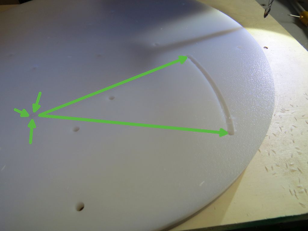

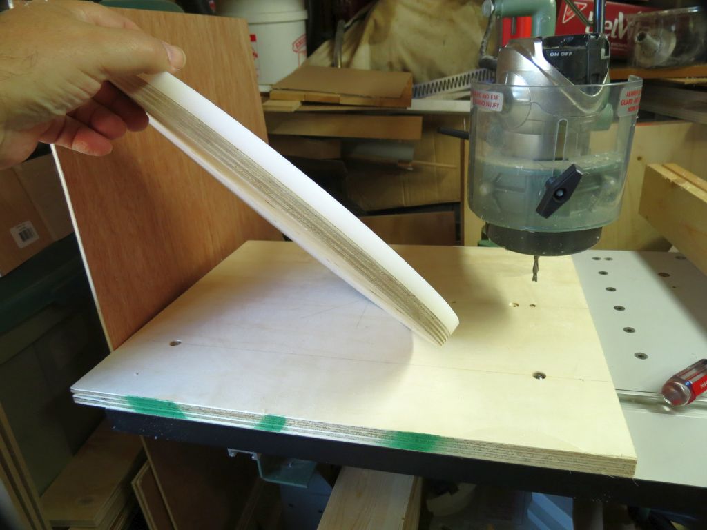

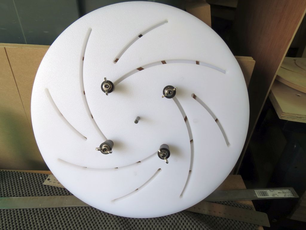

We can now go back to the OPR and get ready to cut the slots. First you need to set the distance from the pivot hole to the pre-drilled ends of the arc. With the template hidden under the work piece you need to see the end points and that is why you add them. It also makes it easy to adjust the pivot to end point length. This is only set one time.
You pick out a hidden pivot point and then router end point to end point. Again it best to do in steps so you can maintain control.
You do them in order and when you are done you have the 4 short and 4 long arcs.
Now this fixture can be used to do inside or outside circles, arcs and the like. I'd not use it as is for smaller circles, you could make a larger circle and mount that so you have control of a smaller circle but again you have to have a way to maintain control.

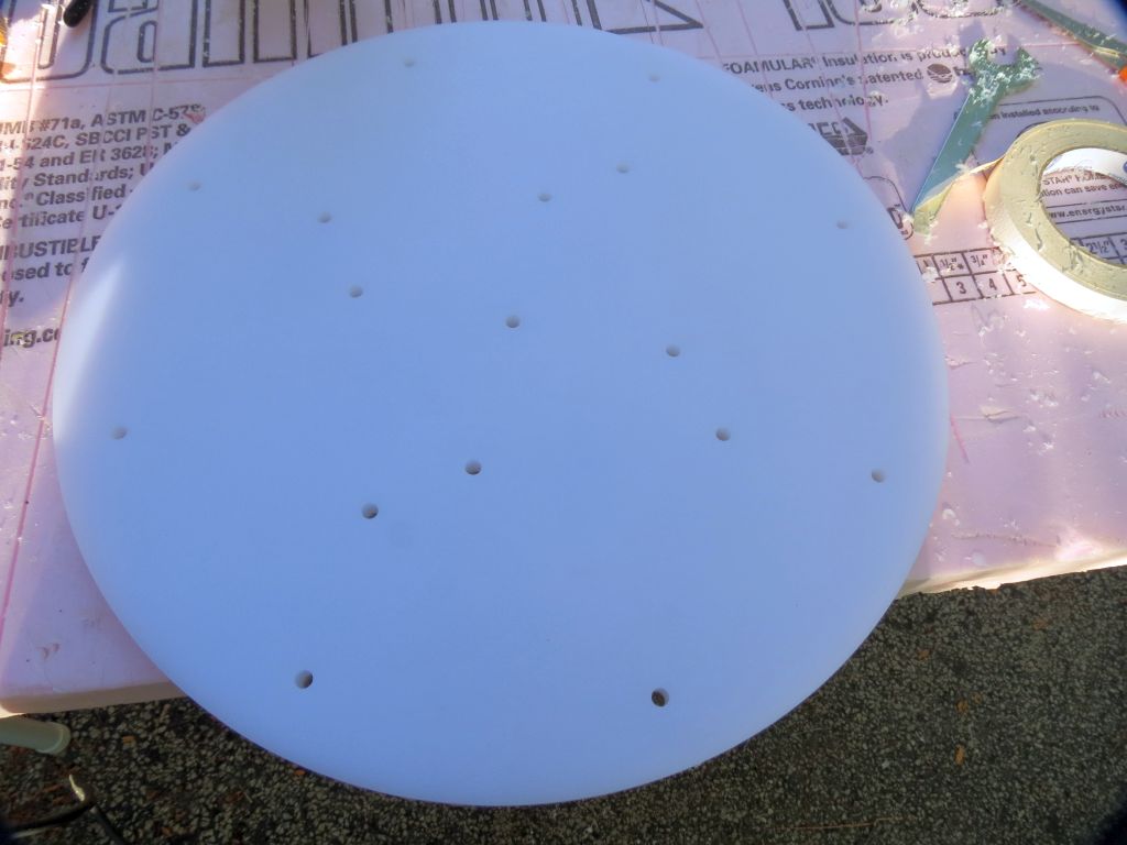

I did not time myself on the early part of the project but the cutting of the second disk and assembly took less then an hour including a massive amount of clean up........ little bits of plastic were flying about and I don't think I've come close to getting all of them yet. I was really interested in how the two parts would work together, almost seems like magic.
I was wondering about how rigid things were going to feel and I was happy with how things are. The boards are quite rigid to start with and the cuts did not seem to make much of a difference and when the two of them are put together, well they turn out to be very rigid. They are 1/2" thick so you have an inch of plastic when you are done. Sure if you stood on it it would flex but I can't see much happening when mounting a hollowed out bowl on it. Besides we are talking running the rpm way down, no more then 500 rpm I would think.
At this point I don't see any reason to look for other methods such as t-bolts/slots.
The hardware package I got has washers for the back side where the hex head bolt goes, then another washer below the gripper on the front side and another on top of the gripper. The wing nuts can be tightened enough to deform the grippers, bulging them helps hold the bowl. Since they are wing nuts your fingers limit how tight you get them pretty fast.
The question I have about the plastic is how flat they are after all of this. A hollowed out bowl is going to be reasonably light when you get to the point of finishing the bottom so I don't see strength being an issue. But if the bowl is wobbling about because things are not flat well that is an issue. This problem can be helped by how they would be mounted but again unless I get to the point of spinning them it is hard to guess how well it would work. Perhaps in the spring........
