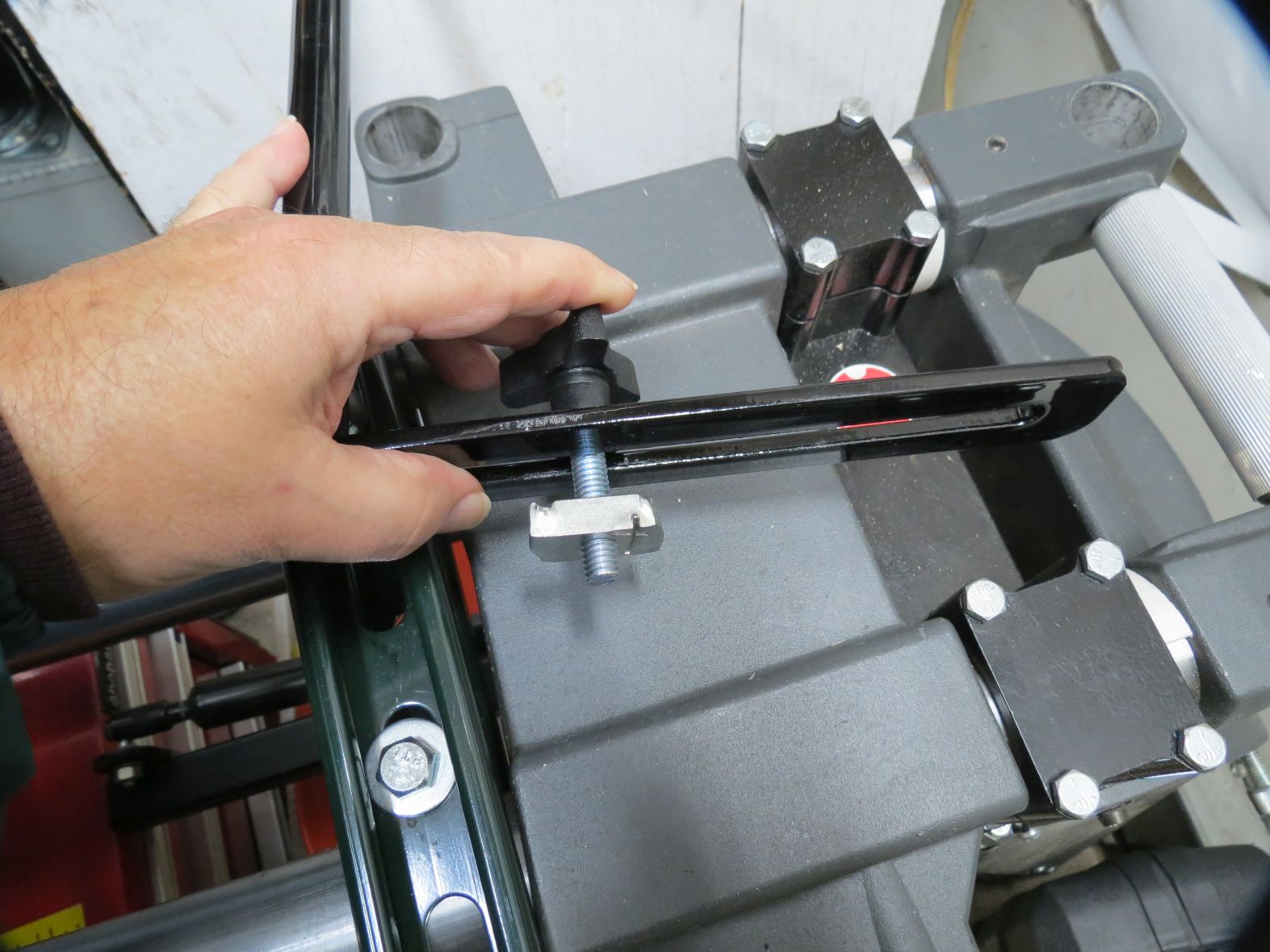

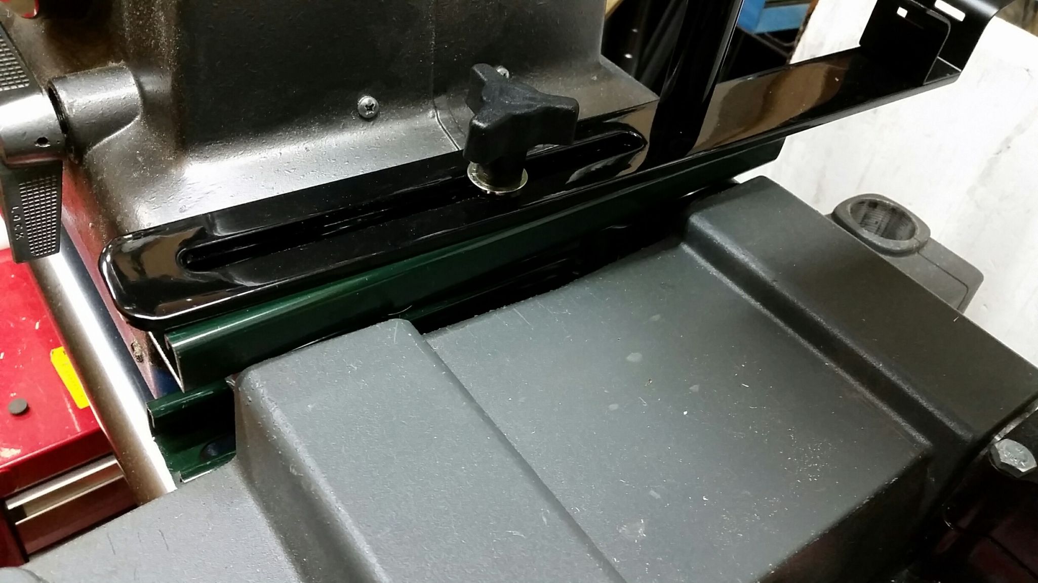

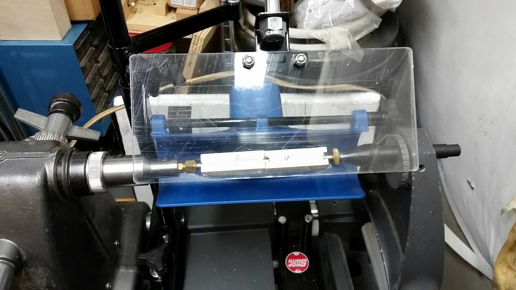

It was designed for mini lathes that a lot of people apparently use for pen turning. Since we are shopsmith folks that turn pens it sure would be nice to use it on our shopsmith. Designed for it no, easy to do anyway, sure!
I'll post more detail later but just to wet your appetite here are a couple of pictures.
Yes the plastic is all scratched up........ comes from being in the box with all the other parts and having a protective cover on only one side. The protected cover side was in good shape, the other side is the major issue. They are going to send me another one.
So as you can see it mounts fine. I have not used it yet so we can look forward to that at sometime in the future. I'm all set to turn that blank but other things to do/finish first.
In the second photo you can see how I mounted it, that will be shown in more detail later this evening. Pretty happy with how that turned out.

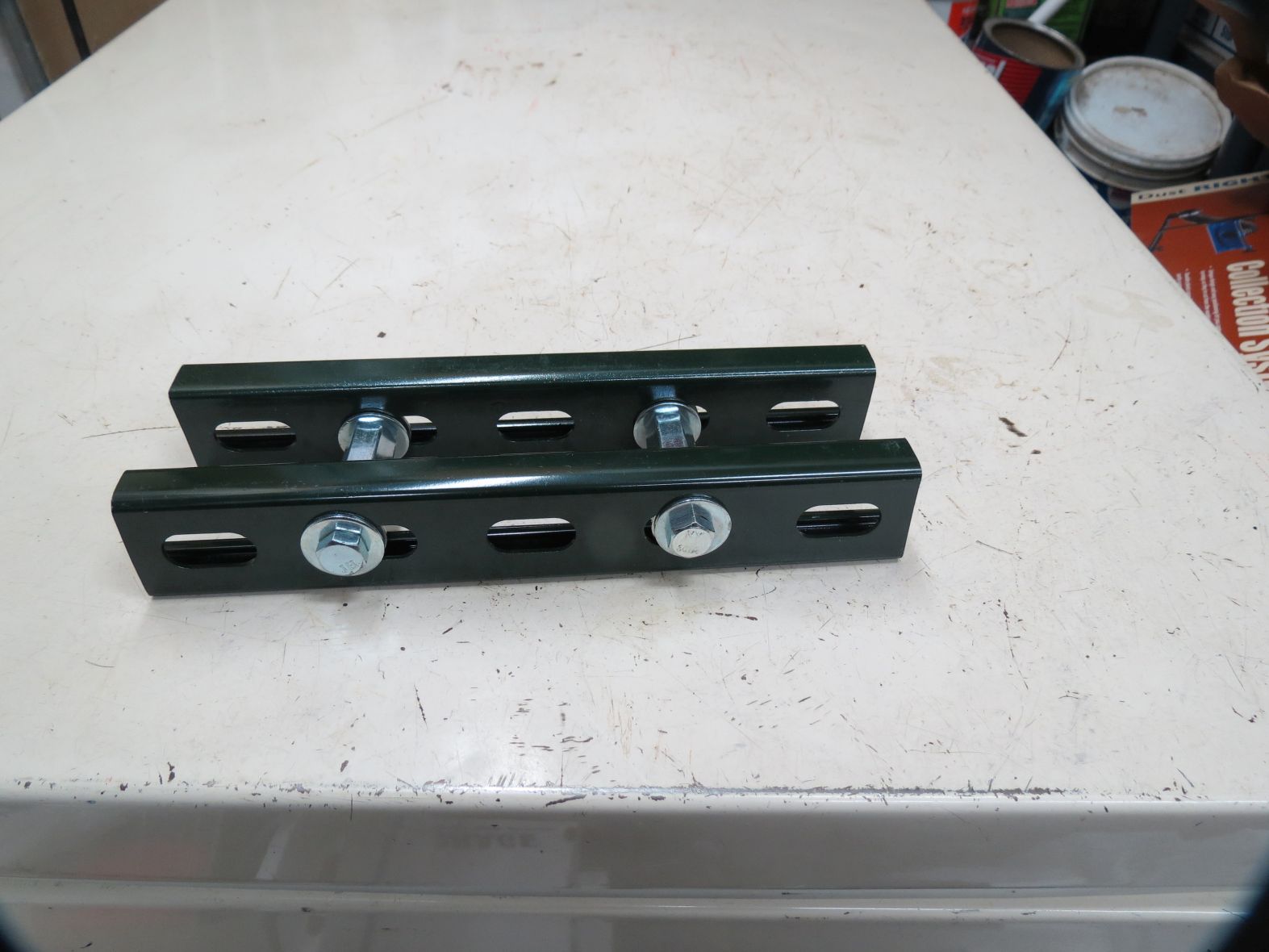

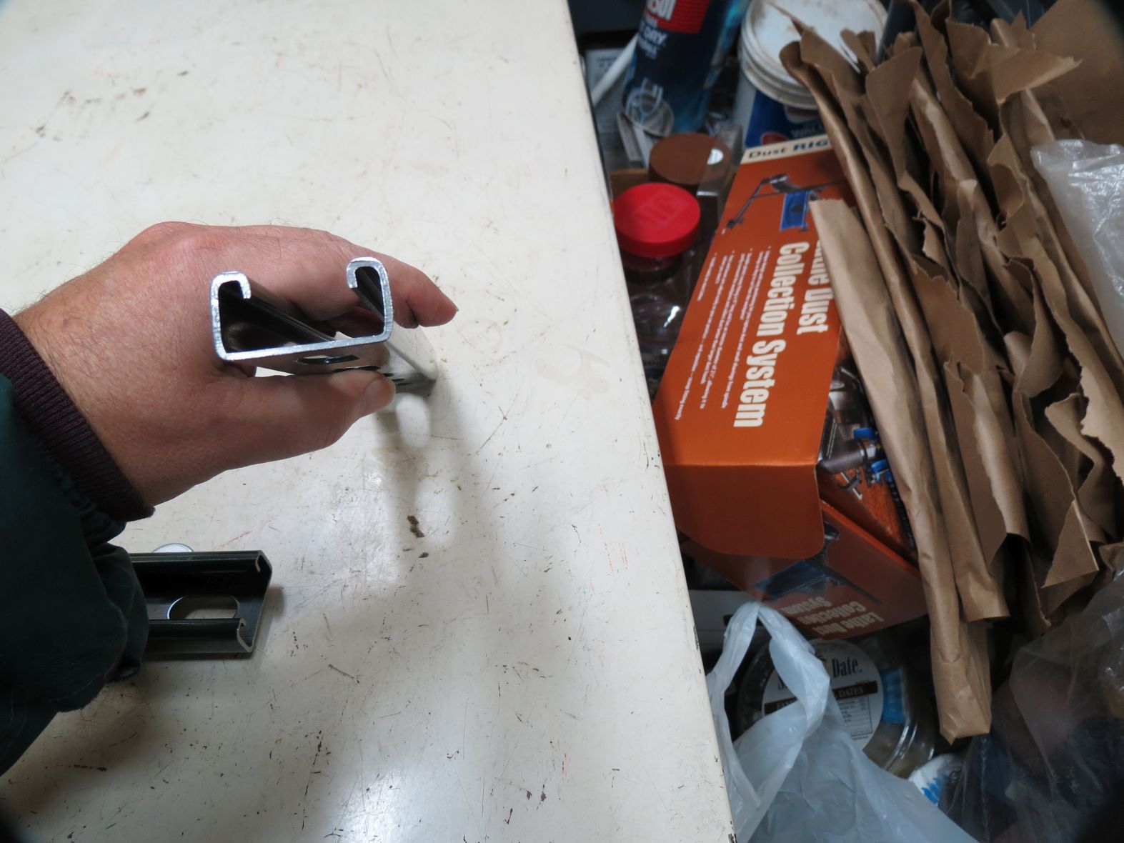

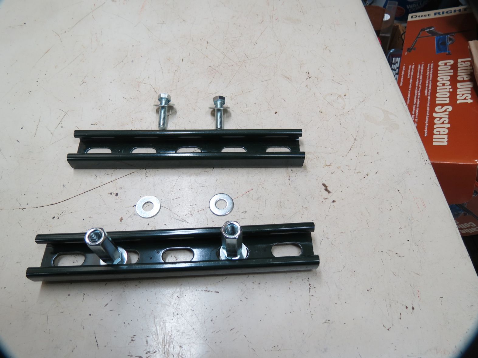

I'll not go in to details of what unistut is or how it is used but I really hope you take the time to google it and check it out. If you don't weld or have a welder this stuff allows you to make all manor of things out of nice sturdy metal.
It of course comes in different sizes. What is picture here is the one that is 1-5/8" wide. As you can see this one is green but other colors can be had. Places like Menard's, Lowe's carry it. It is in 10 foot long sections for somewhere around $17. Other sizes and finishes will be different.
This is what the cross section looks like:

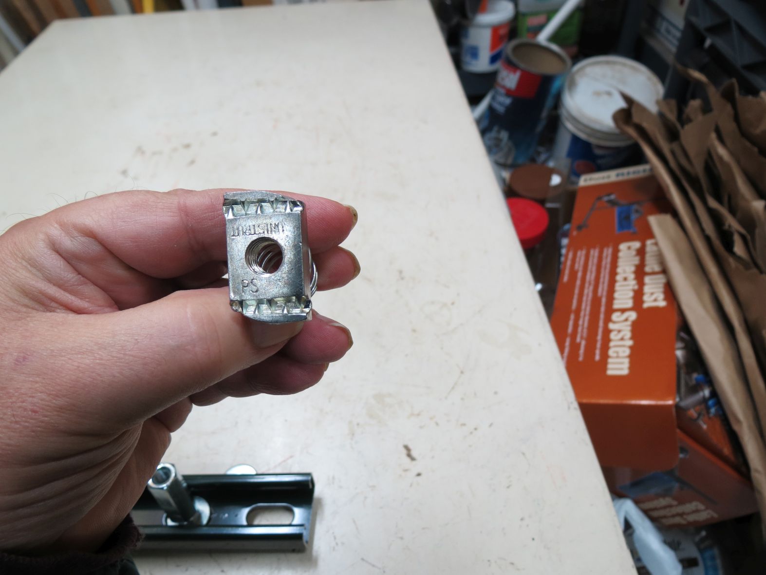

It is sort of like a t-track but different. The shape makes it quite strong, of course much stronger then we need it for this project. As you will see in other pictures it has a pattern of cut outs that allow it to be mounted in any number of ways. The nuts (channel nut with spring) they sell have a shape that lets you insert them and when you twist it the right way it engages the track. Here is one of the nuts:
The normal use allows the spring that is attached to the back to hold it in position and in place. The way I'm using it worked better with the spring removed.

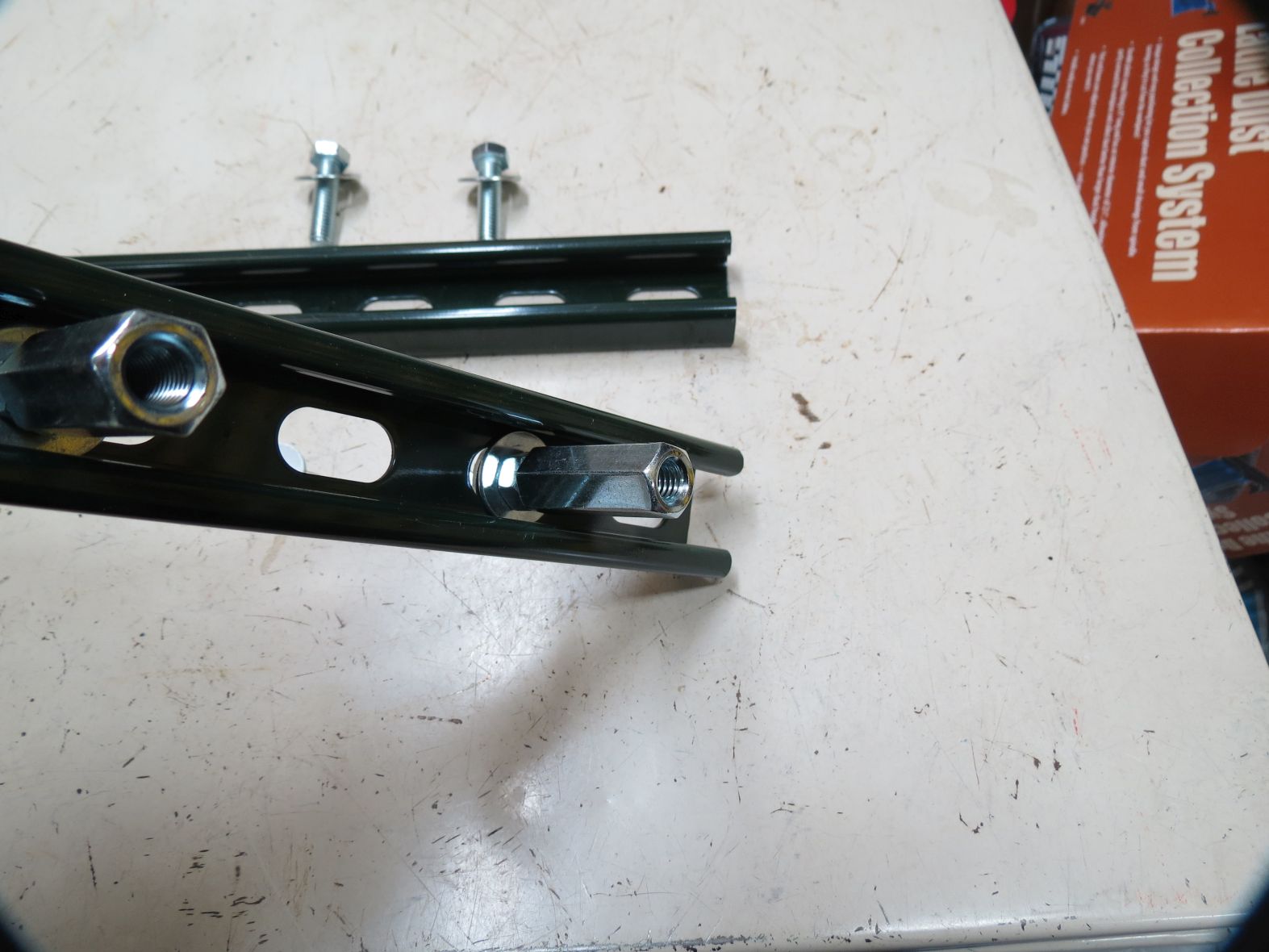

There are several other normal attachments but I'm only using the rod coupler nuts. Again this stuff comes in various sizes, here I'm using the 3/8" version. They are thread all the way through. You will see them in a moment but first lets start with what I've called the bottom. This being the part towards the floor:
That is a 3/8" hex bolt with washer. Since I wanted the parts held in position the inside has another washer and then a hex nut. The coupler is then added and this whole string of parts are tightened starting with the nut and then the coupler. I set the seperation to allow them to just fit with in the way tubes on the shopsmith. This is the stack up to this point:
The strut for this is about 10" long, both the top and bottom pieces. To attach to top strut I added a washer then the strut another washer and then the top hex bolt. This is a shot of the top parts before being assembled:

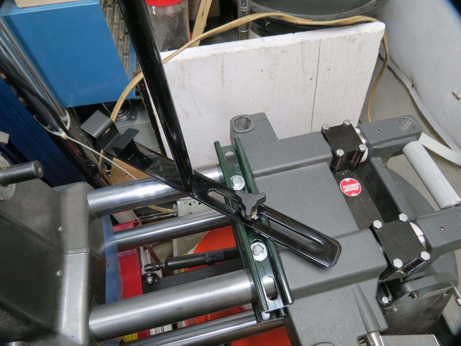

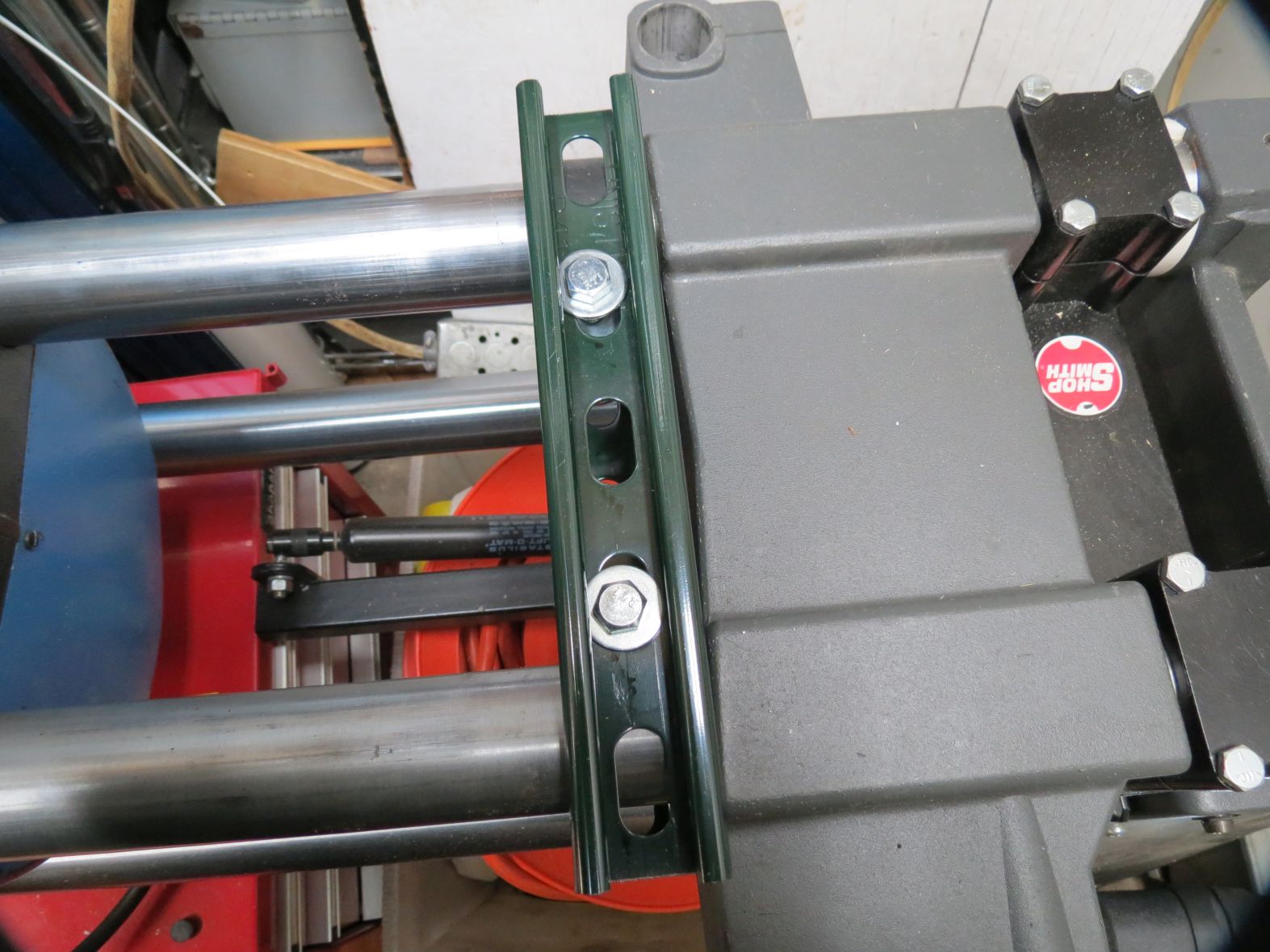

Now lets put it all together and take it to the shopsmith.

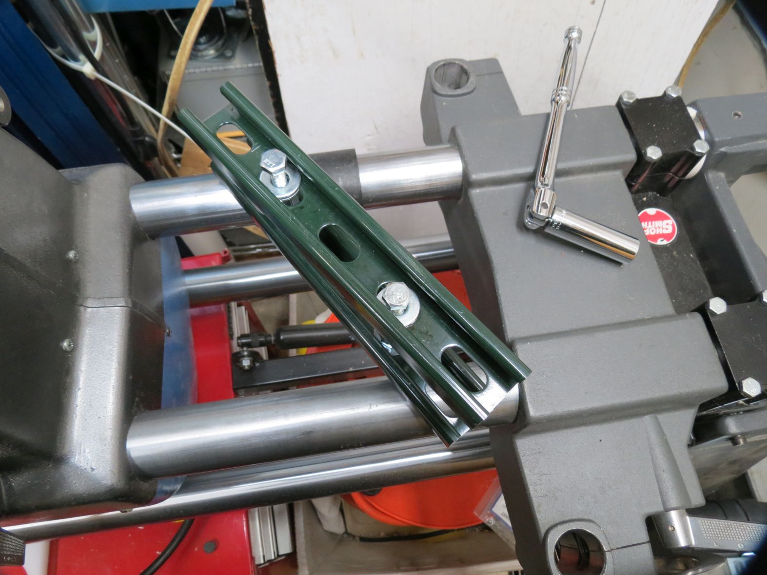

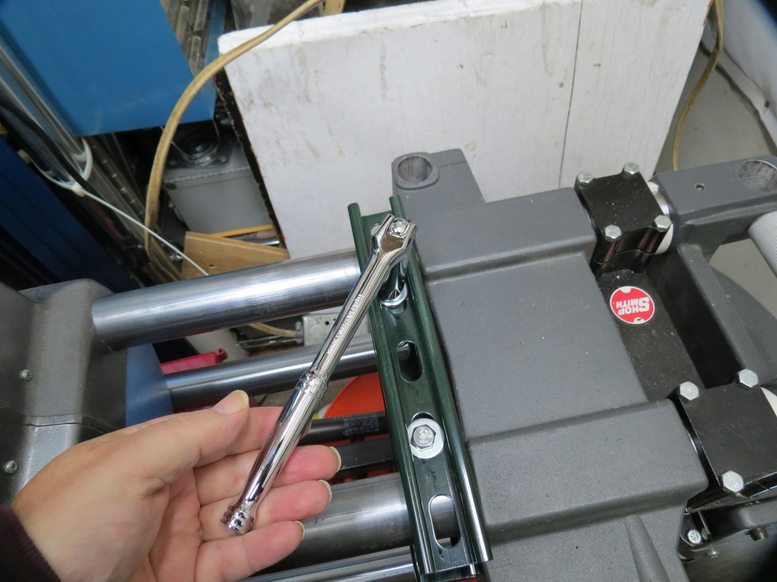

This is something I don't love about the mount but for now I don't see a better way to attach it. When possible it nice to not have a wrench involved but you need a way to tighten it down. If I had a some other fasteners on hand, perhaps the use of an allen wrench would be better but that will have to be another day. As it is I used a deep well socket to do the deed.

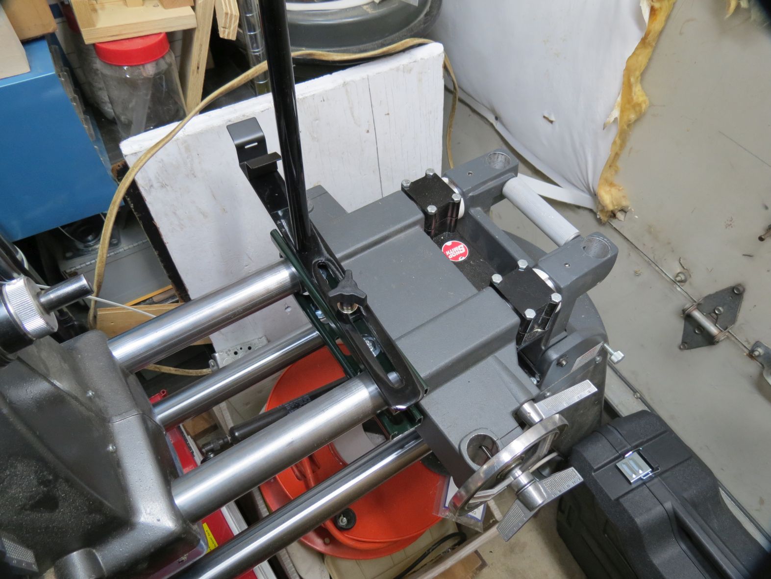

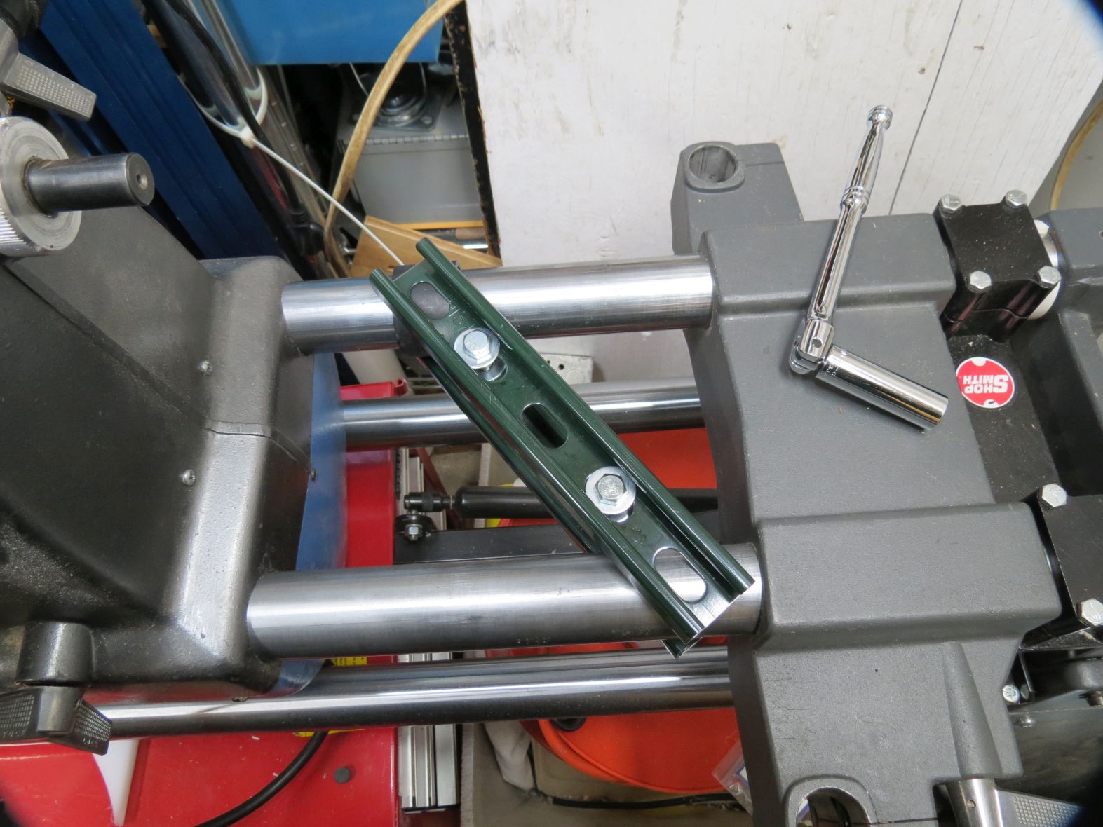

So anyway you have it assemble so now you need to mount it. With the headstock slide back out of the way you twist the assembly and put it between the way tubes. Then twist back to put it perpendicular. Since space is an issue I'm putting it over the rubber stop ring and this seem better done as shown.
I put it tight to the carriage and lightly tighten, no reason to get to heavy handed.
And there you have it.
Now we are back to the funny nut. The base of the dust collector will attach to the shopsmith now. You drop the nut in the strut and tighten.
That is about it. If you have questions on this up to this point ask away.
After I use it I may find issues but I think the idea is sound.
