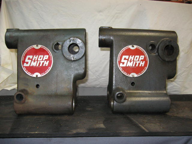

Thank you for posting, This is fun.DOWeaver wrote:I know everyone on this forum seems to like pictures and " What is this"
Try to see how many differences you can find in these head stocks.. Warning picture intense

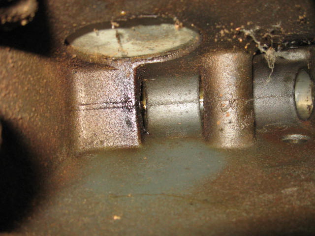

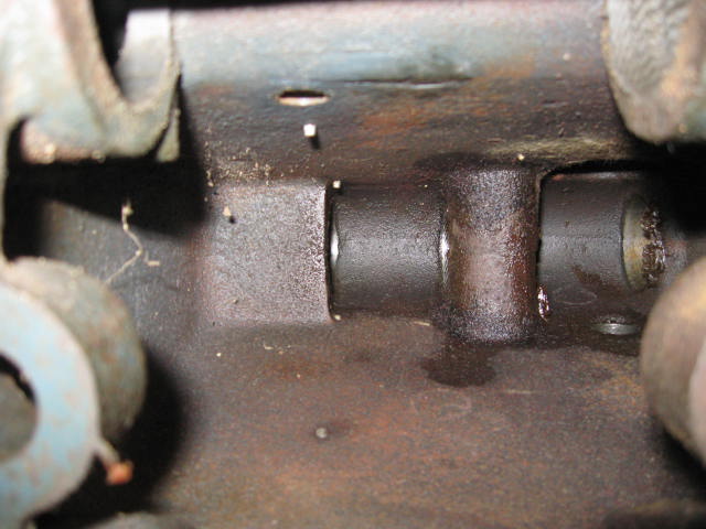

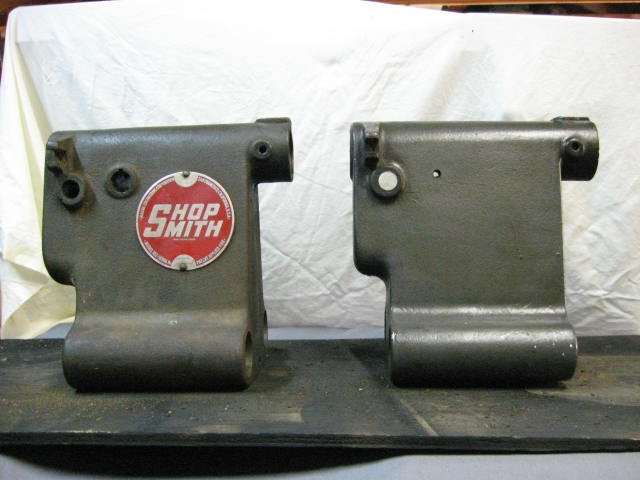

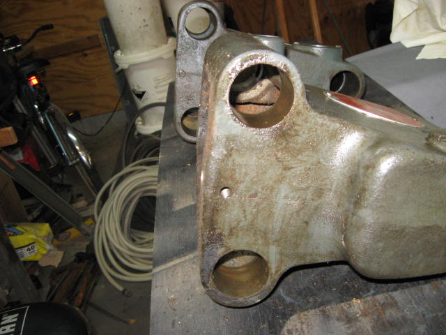

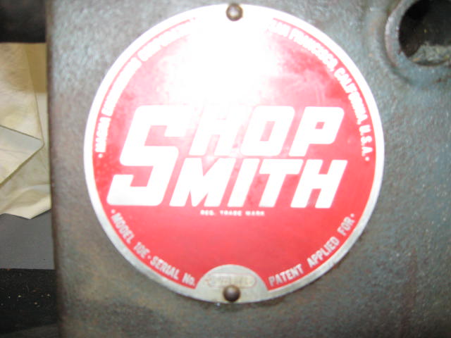

Headstock "A" (on the left)
- older of the two
- has the double wedge locks
- originally made as a Demonstrator (second nameplate on the back side) and I am guessing the serial # starts with 234--. I have #23430
- no hole behind the front name plate
Headstock "B" (on the right)
- newer
- has single wedge locks
- hole behind the front name plate.

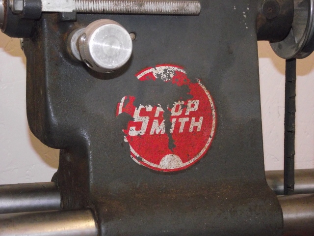

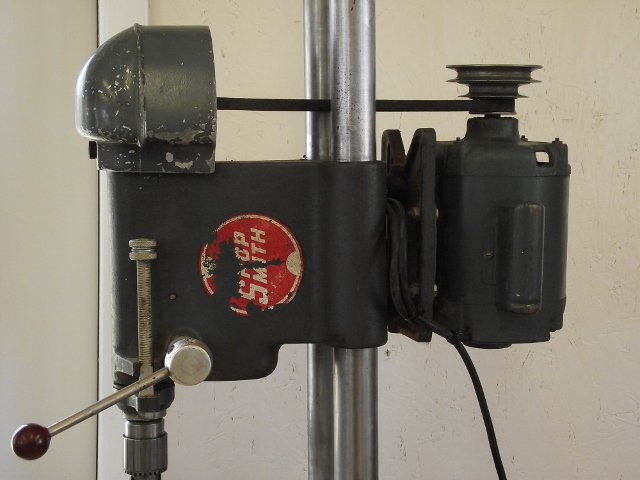

I have one of those demo machines. It has a decal on the back side not an ID plate. My understanding is that these were Montgomery Wards demo machines not Magna. The SN of mine is 69356 which by Skip's list is a '52 machine.rpd wrote:Thank you for posting, This is fun.DOWeaver wrote:I know everyone on this forum seems to like pictures and " What is this"
Try to see how many differences you can find in these head stocks.. Warning picture intense![]()
- older of the two
- originally made as a Demonstrator (second nameplate on the back side) and I am guessing the serial # starts with 234--. I have #23430![]()
- newer
I have not restored it yet because I want to have a decal made (me or someone else) and make sure it will work before I destroy the original.
Maybe what I could do is mask off the original, blast and paint the head stock and have the original decal in place. I will have to think about that.

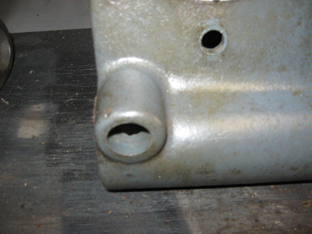

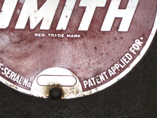

Just as a matter of interest, this is the back side of mine with the extra name plate.
Note the extra hole that the power cord is routed through and the small bolt close to it to clamp the cord on the inside.

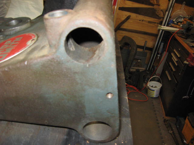

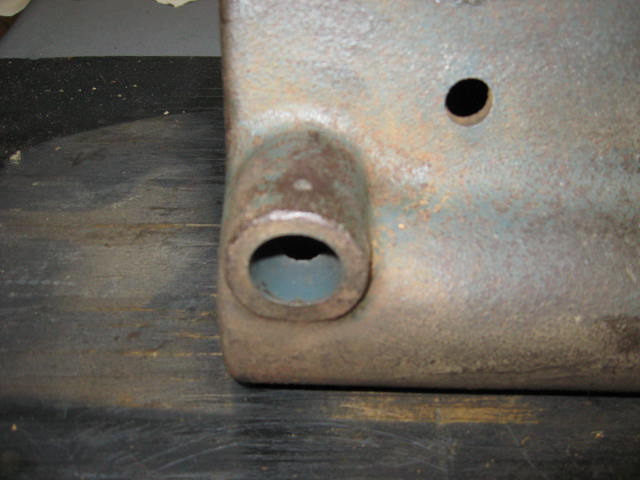

How many did you find? working from left side
1. Older head-stock casting (edges more crisp)
2. Key-way in quill lock hole (noon)
3. Little tips on quill feed hole smaller (at noon and six )
4. No large hole behind front nameplate
5. Color ( blue gray ) Montgomery Wards Store sign colors 40s & 50s
6. The back name plate (Ser. No. Is blank)
7. Hole for quill lock ( goes through to back)
8. The M on the rear name plate in ( Magna & Model downside-up Ws )
9.
