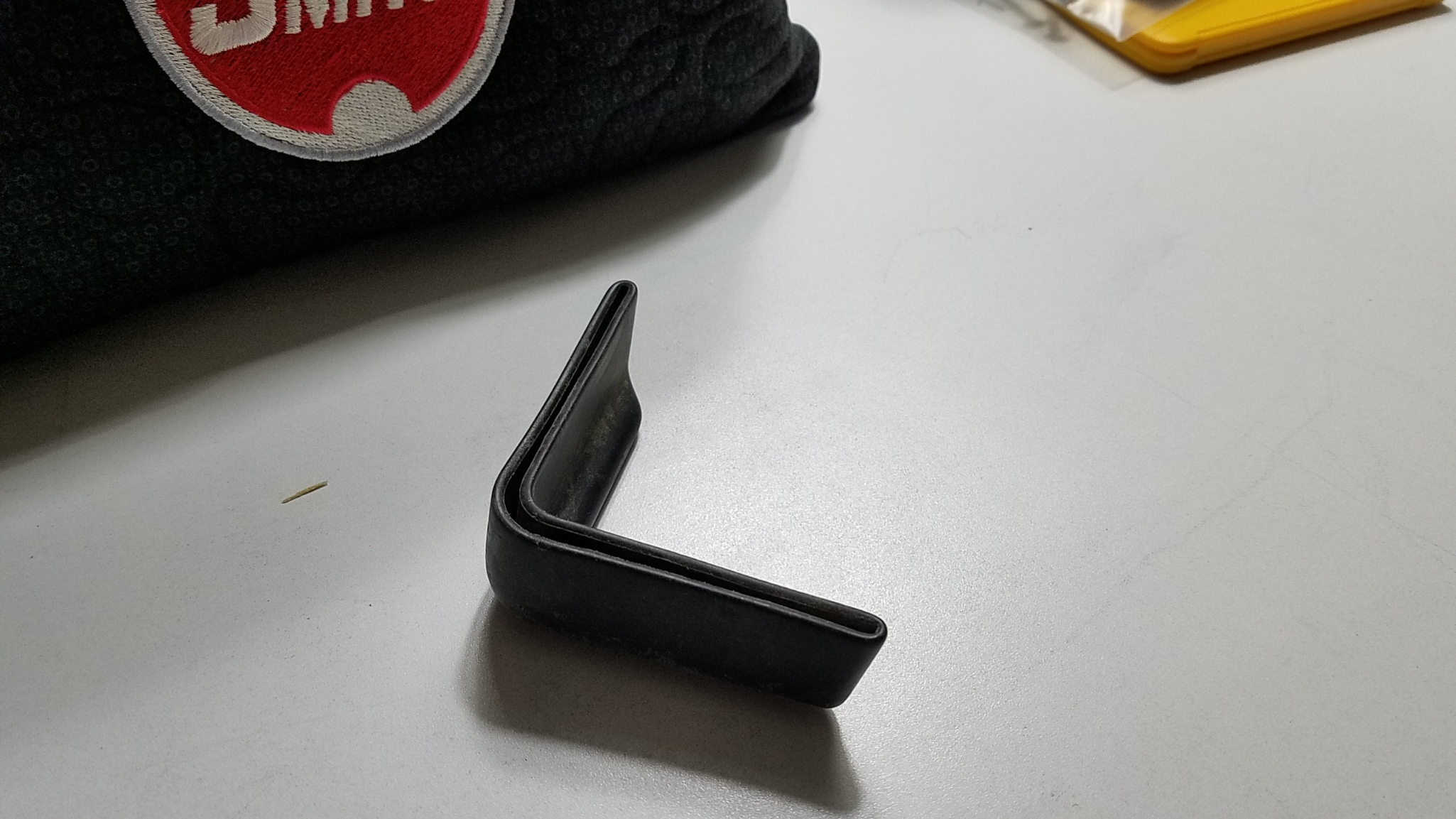

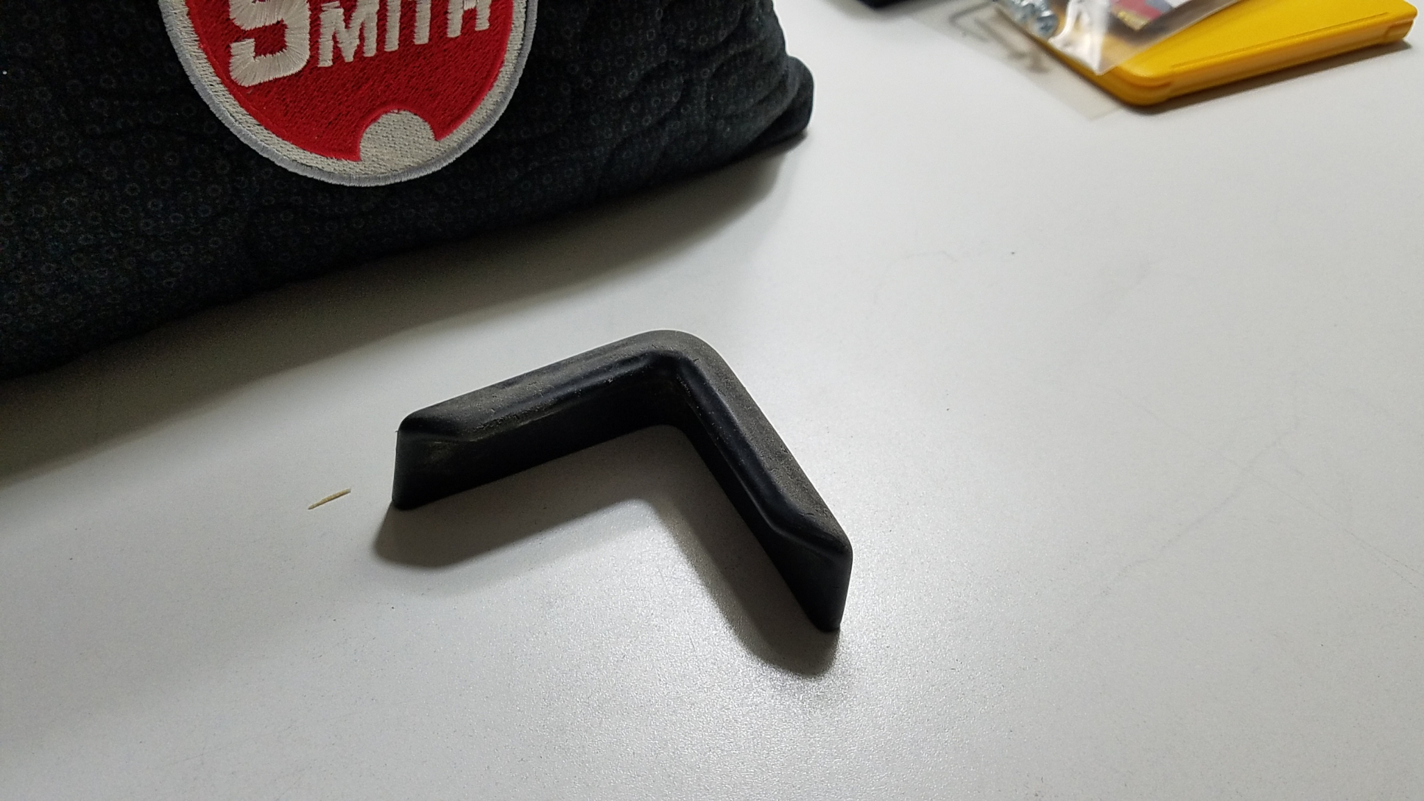

That sounds like a much better approach than what I do, which is to try to pull up on the way tubes when lowering the machine off of the casters, but that doesn't always lessen the impact. The Shopsmith Products pages don't show a picture of the leg boots ... could you perhaps take a picture of yours, or describe them verbally, such as their overall size, thickness, and how they attach? Thanks!shopsmithpaul wrote:It also softens the drop a little from the casters.
Re: Non-skid/.mar feet for Mark V stand
Not a very good image but this is what the Leg Boot looks like. Item # 97 in the exploded parts view.br549 wrote:That sounds like a much better approach than what I do, which is to try to pull up on the way tubes when lowering the machine off of the casters, but that doesn't always lessen the impact. The Shopsmith Products pages don't show a picture of the leg boots ... could you perhaps take a picture of yours, or describe them verbally, such as their overall size, thickness, and how they attach? Thanks!shopsmithpaul wrote:It also softens the drop a little from the casters.
http://www.shopsmith.com/service/pro_pl ... iagram.htm
I have them on my power stands but I never thought about putting them on the Mark V.
- Mark V Booties 003.jpg (1.35 MiB) Viewed 6649 times
- Mark V Booties 004.jpg (1.51 MiB) Viewed 6649 times

I tried, but they didn't fit on my 520 legs. Paul must have a purty-dang-good bootie stretcher.dusty wrote:Not a very good image but this is what the Leg Boot looks like. Item # 97 in the exploded parts view.br549 wrote:That sounds like a much better approach than what I do, which is to try to pull up on the way tubes when lowering the machine off of the casters, but that doesn't always lessen the impact. The Shopsmith Products pages don't show a picture of the leg boots ... could you perhaps take a picture of yours, or describe them verbally, such as their overall size, thickness, and how they attach? Thanks!shopsmithpaul wrote:It also softens the drop a little from the casters.
They do not fit very well on the other two stands either.
