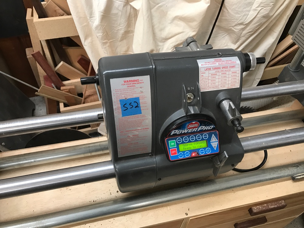

Power Pro is installed
I did the PP upgrade today. All went pretty well and the time frames the mother ship gives is pretty acuurate. I agree with everyone the first thing you notice is the lack of noise. Murphy's law struck on the very last step. I went to put the nameplate on the headstock and as I am pressing it in I hear a tinkle as the spring disengaged from the plate and gently cascaded to the bottom. Oh well. Hopefully it made it to the motor pan and will be easy to get. Tomorrow's another day. Put the stickers on and retrieve the spring.

That powerhead is night and day over the Mark V. I do still have some reservations still because of my failure, but I think the general reliability is as good as the Mark V, it just needs to be proven to me.masonsailor2 wrote:I did the PP upgrade today. All went pretty well and the time frames the mother ship gives is pretty acuurate. I agree with everyone the first thing you notice is the lack of noise. Murphy's law struck on the very last step. I went to put the nameplate on the headstock and as I am pressing it in I hear a tinkle as the spring disengaged from the plate and gently cascaded to the bottom. Oh well. Hopefully it made it to the motor pan and will be easy to get. Tomorrow's another day. Put the stickers on and retrieve the spring.

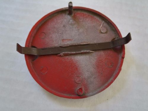

I am confused as I don't remember a spring attached to a plate. Can someone help me out? Is this the wire retainer clip that attaches to the inside of the headstock to hold switch wire?masonsailor2 wrote: as I am pressing it in I hear a tinkle as the spring disengaged from the plate and gently cascaded to the bottom. O
Paul
masonsailor2
- Posts: 1564
- Location: Las Vegas NV
Re: Power Pro is installed
The SS name plate on the back side of the headstock came attached in at least two options. Some were held on by a piece of spring steel on the back which allows for snapping it in place. Others have a pin and a screw on opposite sides of the plate. This machine has the piece of spring steel which broke loose. It's about 1/4" X 3" so it won't be hard to find.
Paul
Paul

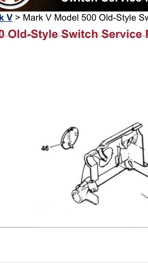

I believe he is referring to the nameplate on the back side of the headstock that covers the access hole.charlese wrote:I am confused as I don't remember a spring attached to a plate. Can someone help me out? Is this the wire retainer clip that attaches to the inside of the headstock to hold switch wire?masonsailor2 wrote: I went to put the nameplate on the headstock and as I am pressing it in I hear a tinkle as the spring disengaged from the plate and gently cascaded to the bottom. O
Paul
masonsailor2
- Posts: 1564
You can see the spring clip on item 46
There seems to be some thing missing in the picture,,,,,,,,,,,,,,,,,oh yea,,,,,,,,,,,,,, saw dust!!
LOL
Looks good.
Congrads!!
