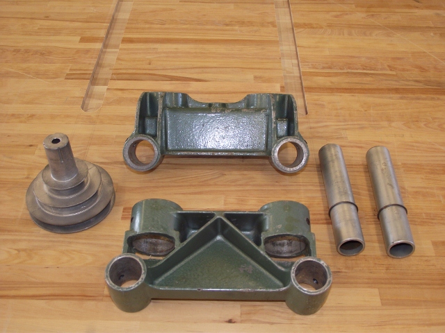

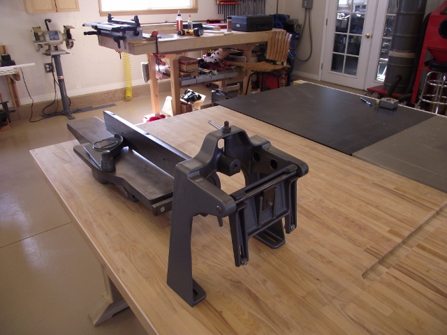

You need a 4E jointer with the proper head rest. The first picture. Those parts are very rare.Bander24 wrote:Thank you all for you response...I don't have time to talk right now...late for Pool leaguue. I will respond when I get back later tonight. All great infomation I needed...THANK YOU..
Or you can use the MK V Jointer or other MK V SPT if you have the 10ER adapters. Good luck in finding them. I have the only complete set I have ever seen on eBay after years of looking.
I would get the adapter Skip Campbell sells. It is high quality and will let you use MK V SPTs on the 10ER. You will also need the head stock pulley that Skip makes that allows the MK V coupler to attach to the 10ER head stock.
The first picture is the original Magna 10ER 4E jointer. The second picture is the original Magna adapter set for MK V STP tools.
