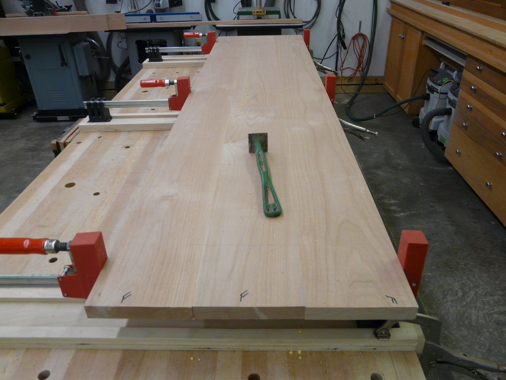

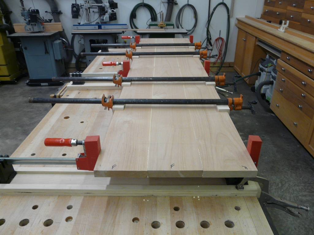

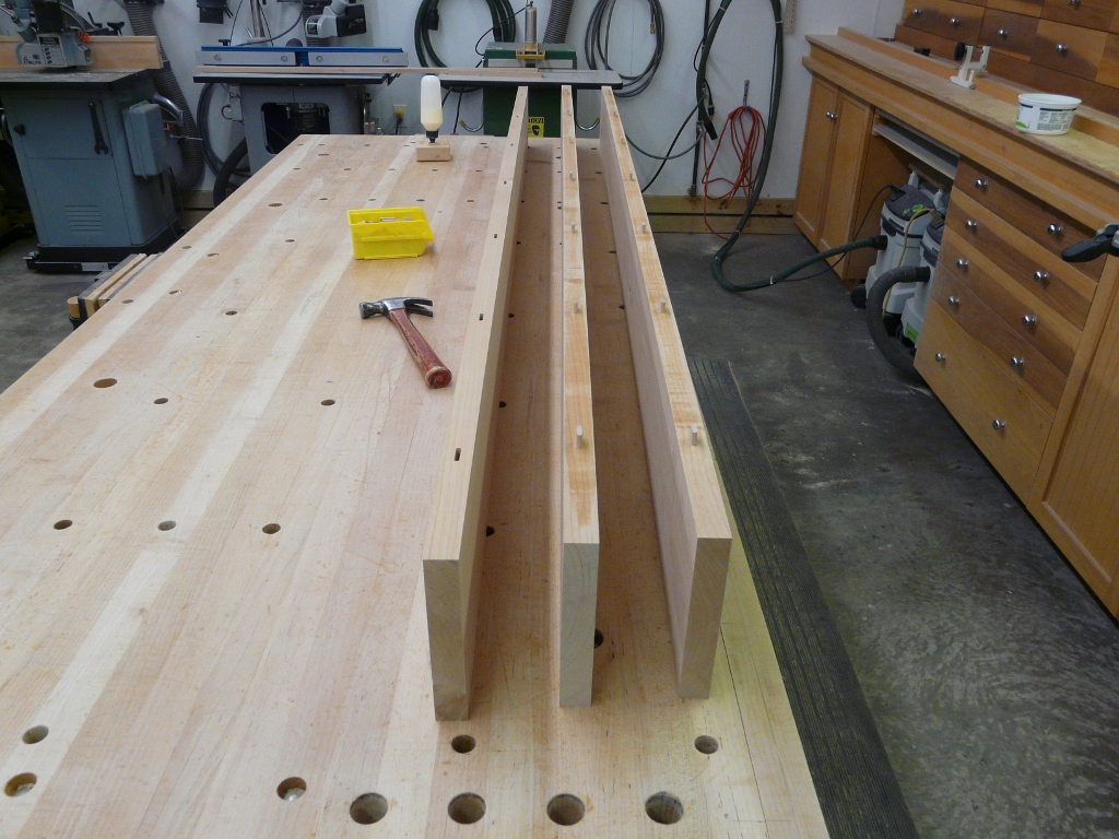

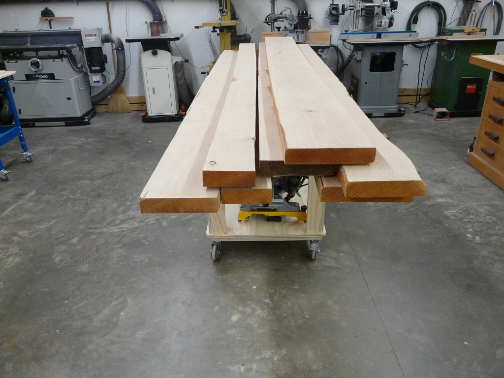

I had some 8/4 alder and need a 1 1/8" thick wooden top.

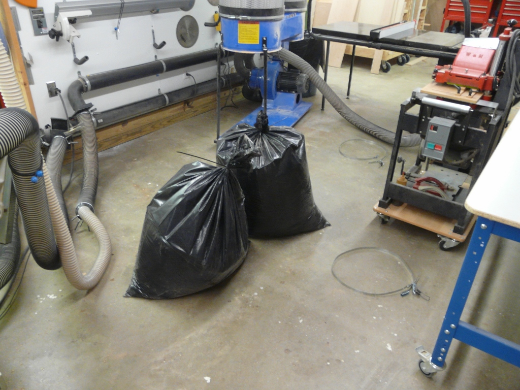

After much jointing and planning and dumping the dust bags twice.

I hate changing dust bags! :rolleyes:

The dust is gone and left a nice panel.

I gotta ask ... what has a 1-1/8" top, that wouldn't be just as good or better with a 1-3/4" top?

Nice job ,,how did you true up the edges for gluing ?

Its for a credenza that I am building. 1 3/4" would look too heavy for my taste.

I had to face joint everything and then plane it down. I used my track saw to straight line it and then ripped it on the table saw and back through the jointer before gluing. It was a lot of work and I usually use 5/4 material for these but I had the 8/4 on hand and wanted to free up the lumber rack.

The glue joints look very tight !
Also did you make your own pegs for the dowels

Thems 'dominoes'.

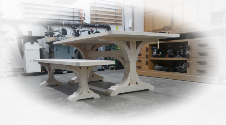

I understand. My personal tastes run more toward the massive look, but everything must be in proportion.
Like the ash table and bench below, custom-made by a master craftsman. ;)

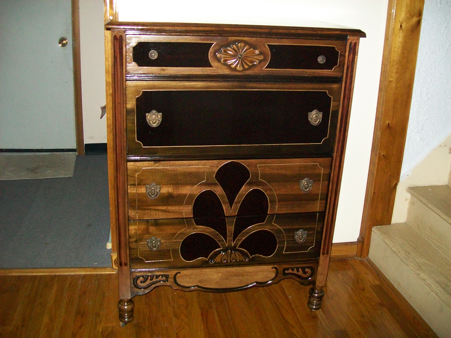

Nice job
However,,
This is a masters work :cool:
