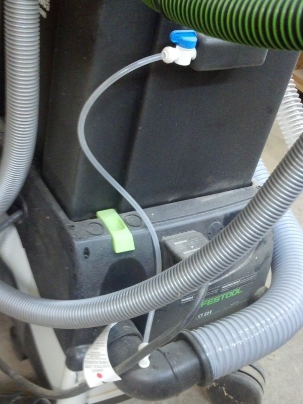

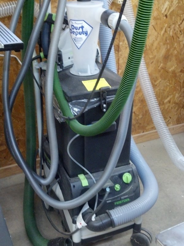

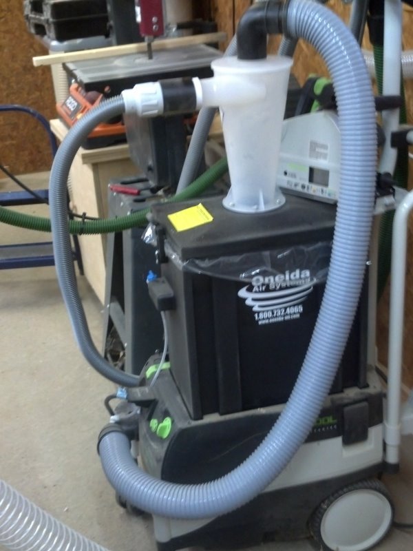

I have had the Ultimate Dust Deputy on my CT22 for years. I also have be boom arm setup. I haven't had toput a new bag in the CT22 since I put the UDD on it probably 8 or 9 years ago. I am a UDD fan for sure, and TS55, domino, RO 90, RO 125... you get the point. That said my setup never moves more than 3 or 4 feet.
Jack
2012-12-29 17.05.20.jpg (75.48 KiB) Viewed 11978 times
2012-12-29 17.05.40.jpg (97.71 KiB) Viewed 11978 times
2012-12-29 17.05.50.jpg (85.67 KiB) Viewed 11978 times

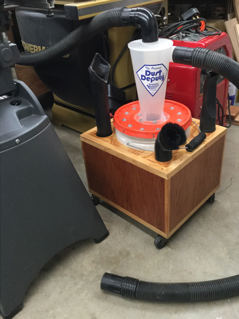

Ed, FWIW, I made the Dust Deputy cart below a few years ago out of scrap lumber & leftover luan plywood. It was my first experiment with a dado stack and decent joinery, and I learned a lot. Putting the accessory holders in the corners turned out to be a very good idea.
My original plan was to hitch this thing to my Ridgid shop vac, and tow them both around together. But it worked out much better to leave them unhitched, and generally just move the cart around. Much more flexible/extensible that way.
And BTW, I just took that pic. The cart has been bare nekkid these last few years, but a couple weekends ago it came in handy for test-spraying shellac with my new $9 HF spray gun. :)
