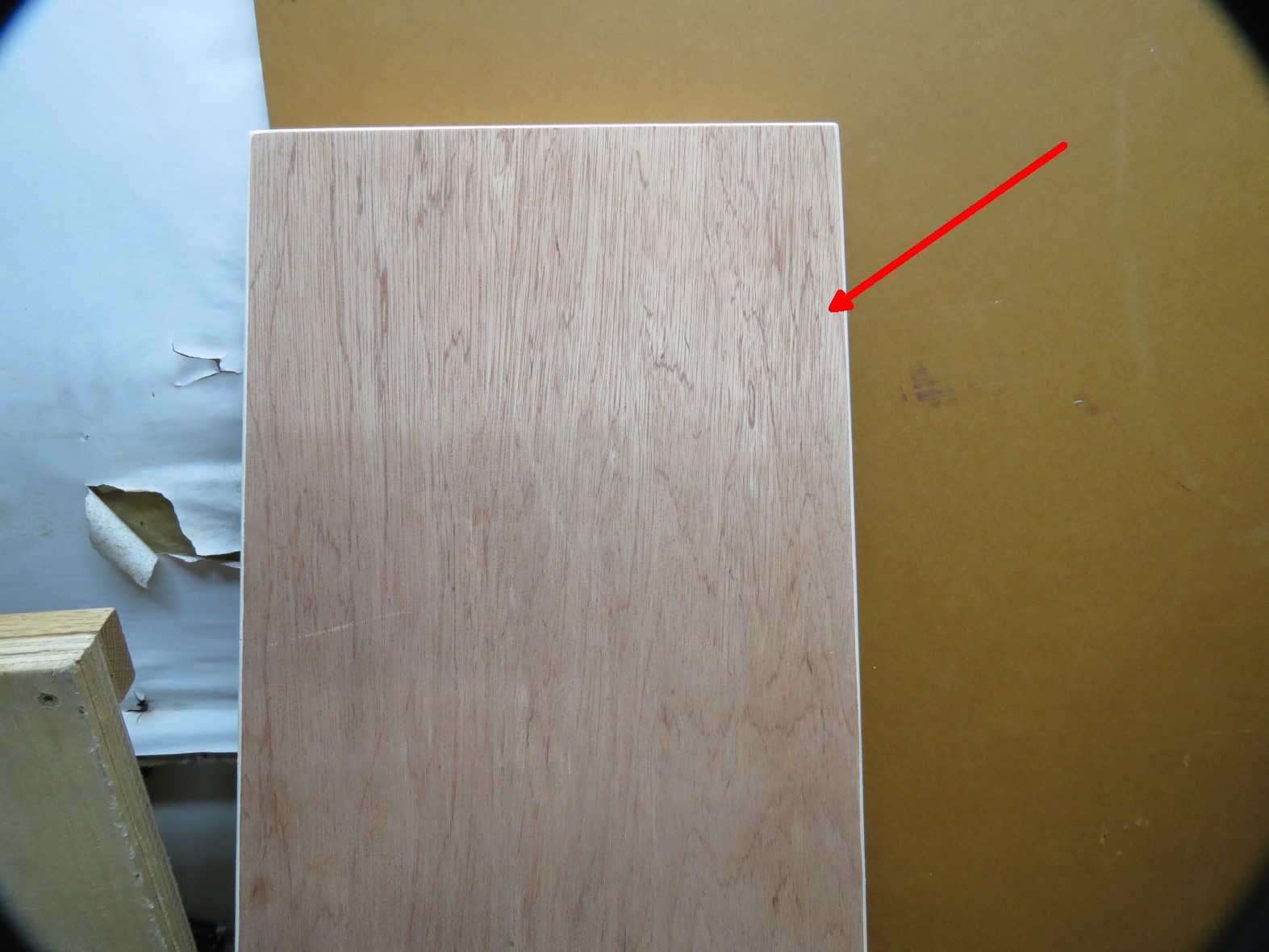

I have this project that I'd like to give a green tint to. Part of the piece has light color wood but the other and larger portion is darker. Rather then try to explain more this is a picture of what the wood looks like now.

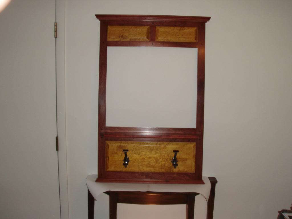

I work with dyes and stains a lot and in combos of both. I learned it from Bob Flexners book and then by use and experience following his techniques.
I use TransTint dyes and usually Minwax oil base stains.
Basically you use a dye first to get the color you want, dint soak the wood, wipe on wipe off, I mix min with DNA so it does not raise the grain lik water mix would. You can go back over it if need be to darken, or with just a rag dampened with water or DNA to lighten/blend it better.
Then I do a seal coat of 1.5lb cut of Shellac, then buff with a green scotch brite pad. Then my stain or BLO to add depth,pop the grain colors, then finish of my choice which is usually oil based wipe on poly.
I will add pics of some of that and explanation in next post in a bit. time to make moms dinner.

The bird eyes maple wast lightly died with Trans Tint Antique Maple, Then BLO to pop the grain and eyes, then oil based poly.
I highly recommend Bob Flexners finishing book, easy to understand and you will learn so much. It is my finishing bible.

That's kinda the point. It allows some dye thru, but evens out the penetration so you don't get blotchy areas. I've tried it (on lathe turnings only) and liked the results. Capt Eddie has a video on it somewhere on his channel. I just sealed half a piece of plywood and half a piece of MDF with Deft sanding Sealer and will let that cure a bit and hit it with some of my green dye- You got me curious! I'll post pics tomorrow...reible wrote:Doesn't the sanding sealer stop penetration of the color or is that the point?

Some what ,also the finish wont absorb into the stock as deep , like you said though ,,,it may just discolor the green tint .
Maybe add a touch of red to the mix for a olive green.
