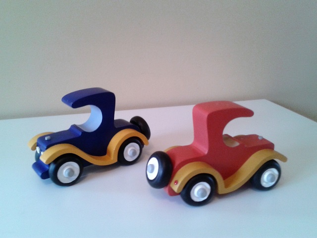

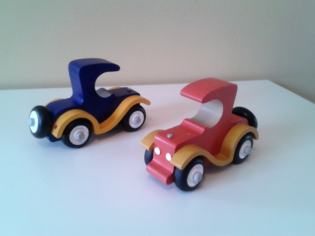

Here are pictures of the latest toys.As usual, a few mistakes and challenges but as mentioned in a previous post, this type of project is more forgiving than others in natural wood.
The big mistake was forgetting to mask off the placement of the fenders before painting the body. I only hope my pegging them with three 1/8" dowels will be enough to hold them on.
The other challenge was trying to drill holes for the tail lights because of the curves. Tried one with no success so I filled it with a dowel and sanded it down. Paint covered the error. Tried using red paint on the eraser of a pencil but not great so I looked around to see alternatives and found some red tape with a rubber backing. I used a leather punch to cut a circle and stuck it on. I hope the sticky backing and two coats of finish will hold them on. After all this, I realized that using the Shopsmith in horizontal boring mode might have allowed me to drill at the proper angle and use dowels for the light which is what I usually do.
On the painting side, it seems with my less than steady hands, I do a lot of touch up of the touch ups. The down side of aging I guess. :(
The plans come from a set I bought around 20 years ago when I bought my Shopsmith and first got serious about woodworking. I think I got them from The Winfied Collection. I now need to find some smaller ones or try to scale these down to fit smaller scrap pieces.
Well, back to the scrap heap.
Have fun!
John

Very cool. I like 'em.
Re: Two Coupes
Look fantastic to me.
Any kid that plays with them would not give a hoot about 'touchups' or if stickers came off. Part of playing is the imagination part.

Horizontal drilling sounds like a good idea, also drill the holes before you cut out the fenders, that would give you a flat surface to drill into and any chip-out will get sawed away.
