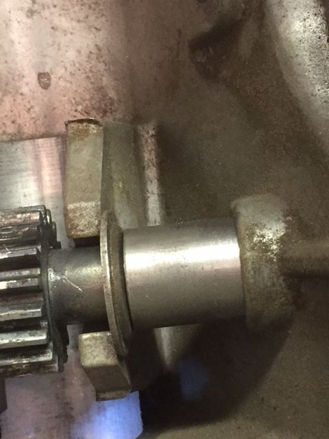

I recently bought a replacement headstock and after cleaning it up got ready to install the quill from my old machine.
The quill will not feed easily - in fact it binds to the point of having to use the quill retraction handle to move it in the opening.
There are no burrs on the quill and the surfaces of the openings and the quill itself are clean and newly waxed. The quill still binds.
I'm thinking now that either the openings must not be circular (as in oval shaped) OR the quill feed hardware is incorrectly installed.
The attached picture shows how the part I suspect is installed. I think it may be in the wrong location or facing the wrong way or both.
If anyone can help me solve this mystery I'd much appreciate it. the exploded parts diagram confirms I have the washer located in the correct order on the shaft but I can not determine the correct location in relation to the pinion gear and quill opening.
TIA for any help. I plan to call Shopsmith but can't do that until late tomorrow afternoon.

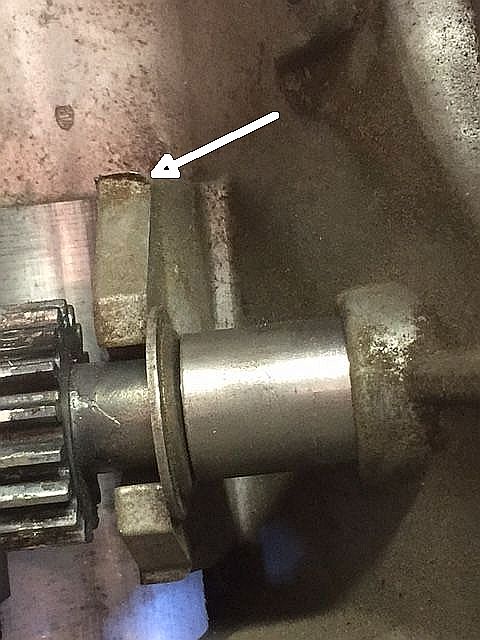

Quill stop ear broken? I suspect the bore is also reduced at that point.

For JPG: The quill stop is not broken (thankfully) but the photo makes it appear so. The off line appearance is an optical illusion caused by the angle from which the pic was taken.
I used all your suggestions given and still ended up calling SS this afternoon.
They think they will have to send me a new Quill since the old quill was working fine when I removed it to do the DIY upgrade - and the new one binds.
Should get a call from them tomorrow - the decision maker was not available this afternoon.
Will post with their answer - but knowing how SS is about customer service I fully expect to have a new quill on the way to me shortly.
