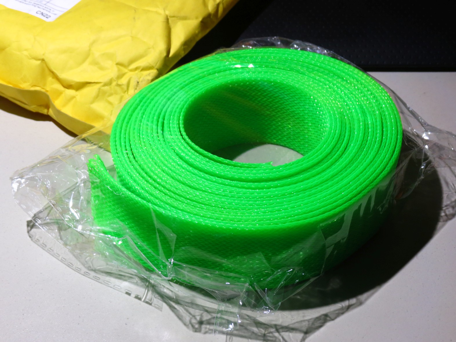

The hose cover arrived today. There will be no hiding this hose when it done.
Now I have to decide if I want to run the power cord in it too. It would/could be handy. If so then do I want a spare cord for the purpose??
At least I'm another step closer as of today.

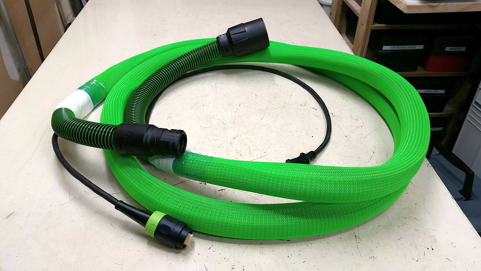

I got to thinking that I never did post a picture of the finished hose with cover. I think everything worked out well after a small glitch on my part having the cover to near the end of the hose where it attaches to the vacuum. Had to cut it back by a foot due to the dust collector sitting on the vacuum.
The cover makes it a lot easier to have the hose slide over things and I think it was worth it. I don't think every hose should have it or for that matter needs it. For those in the know the hose is the 27mm. I also have the 36mm but have not decided if I want to do the same for it. I think the same size tubing might work but I don't have enough left for the job. I do have enough to see if it fits.
As you can see I ran the cord with it. I used the heavier gauge cord which works with the tools that need it as well as the ones that can use the lighter cord.
