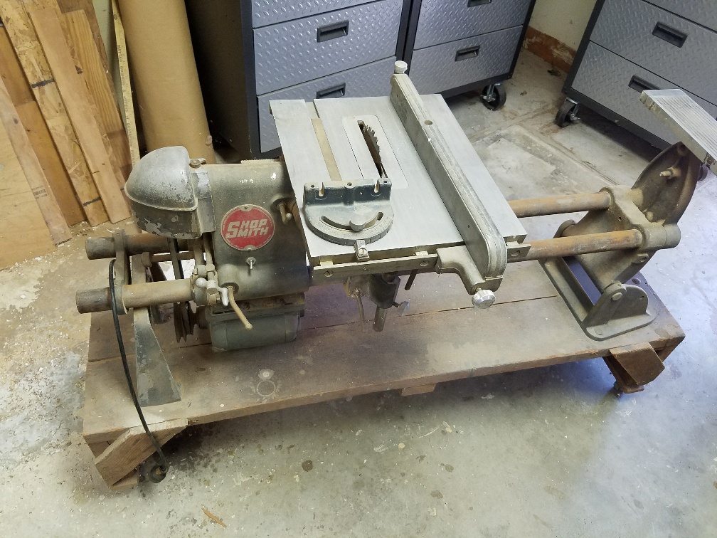

My dad bought this in 1970, I think. I'm trying to find more information about it, particularly when it was made. The serial number is R47694.
Thanks!

That was made probably mid production in 1951. It is an 10ER. Great machine even for it's age.betterlate wrote:My dad bought this in 1970, I think. I'm trying to find more information about it, particularly when it was made. The serial number is R47694.

Do take good care of her! You need to look for the missing speed changer sliding reeves pulley.

I will look around for that speed changer sliding reeves pulley... as soon as I figure out what that is.

Sadly they are exceedingly rare! You might need to get a broken speed changer to harvest it from.

The speed changer looks like this.betterlate wrote:Thank you both!
I will look around for that speed changer sliding reeves pulley... as soon as I figure out what that is.![]()
Again, I really appreciate your help!
Most of one is mounted on your Dads 10ER, The part (sliding Reeves pulley) that you are missing looks like this. Check in your Dad's boxes of parts, with any luck you will find it there.
Here is a link to the owners manual that you can download. 10ER Owners manual
And here are links to a couple of threads that contain a great deal of information on 10E/ER's
Everything E / ER - Technical info, documentation, links
Restoration Progress On My 1952 ER10 - Mickyd
