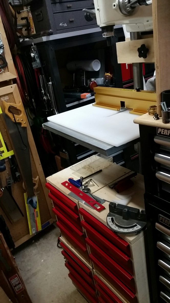

Re: Push me pull me drill press??
For my drill press I have adopted a set of rolling drawers that I built to fit under the shopsmith. It really nice to have that drill press stuff right at hand so that part is good. However when it was under the shopsmith the 2" wheel height was fine. Now it works so long as I don't try to get my toes too far under it.
One of my projects this year is to change out the casters and go to 3", a minor change but I think I'll like it better.... if not then there are 4" casters which is the typical for such things.
What is nice is that they are all attached together but if need be they come back apart in to 4 units. Loose pin hinges with brass rods for the pins and bent, same idea as the old shopsmith under cabinets.
Here is a picture:
I personally like a nice toe kick area and space where my shins don't get bumped, one reason I dislike the shopsmith rack sitting on the front of a machine.
