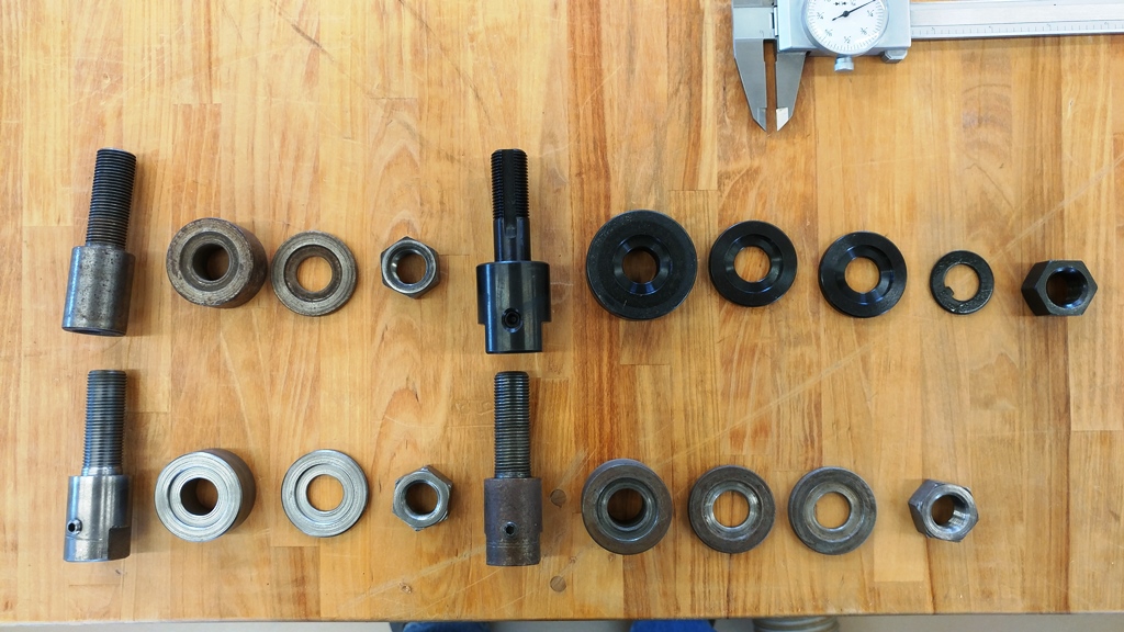

The picture shows 3 10ER arbors and one current Molder/Dado arbor. The two on the left are 10ER but are missing one thin washer I think. I don't know if they were ever sold with just one thin washer. The accessory catalog I have shows two thin washers but it is from 1953 which was the end of the 10ER production. The one on the bottom right is a 10ER with the two washers. The one on the top right is a current SS Molder/Dado arbor.
They all come up on eBay all the time so they are easy to get.

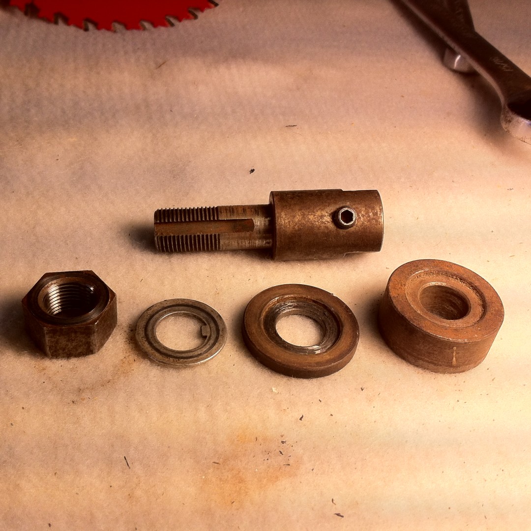

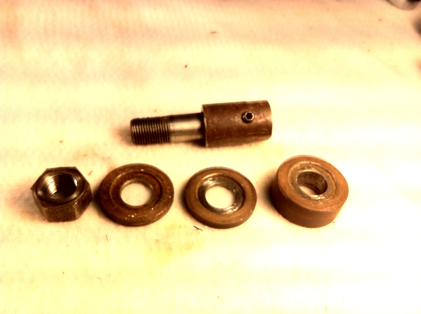

The 10er's came with a universal 5/8" arbor like this.
and disassembled

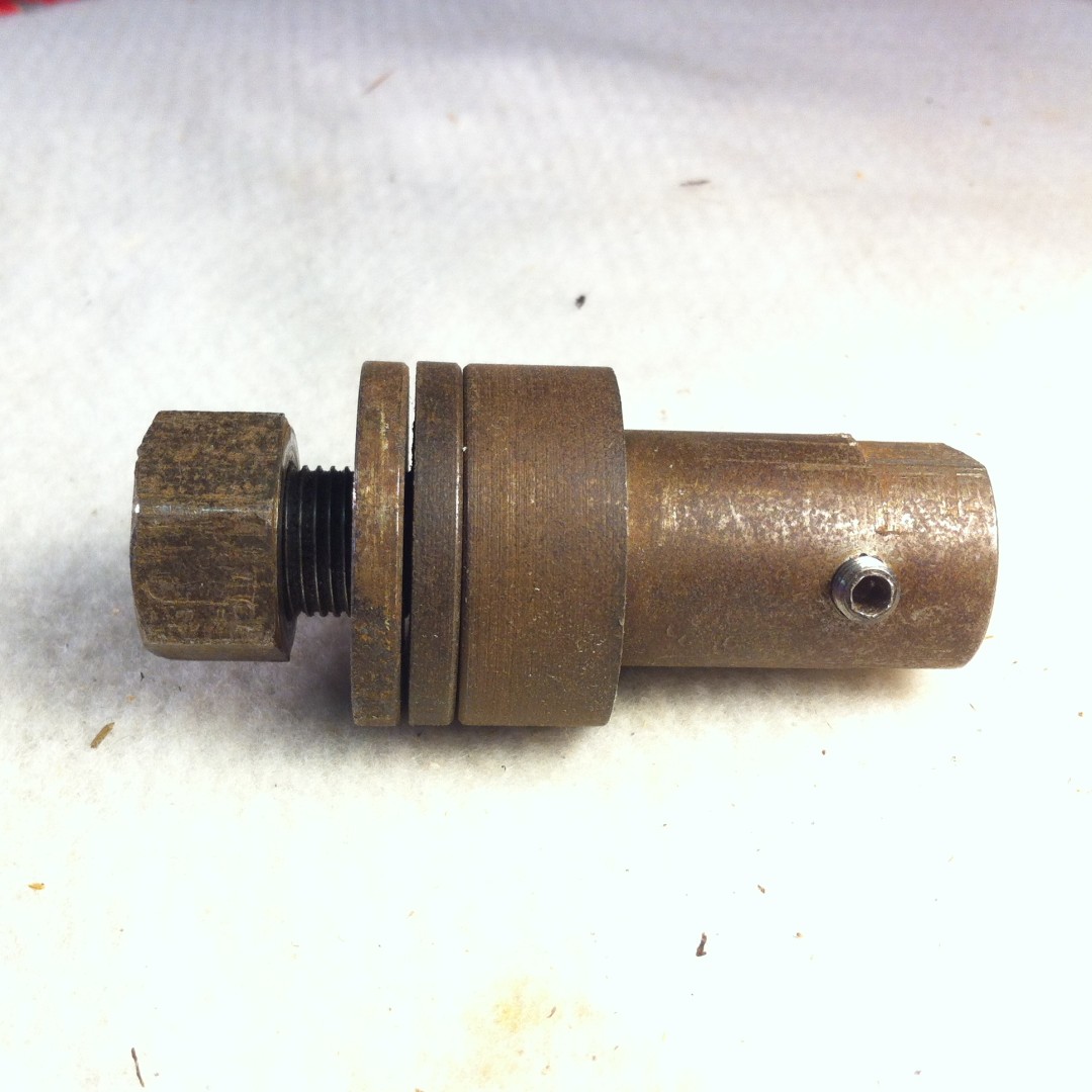

They came with one thick and two thin washers, for saw blades one thick and one thin would be used, for thicker things like a dado stack the two thin washers would be used. As only two of the washers were used a time by the time you get it there will probably only be two, one thick and one thin.
Note the washers have a recess on one side, that side goes against the blade.

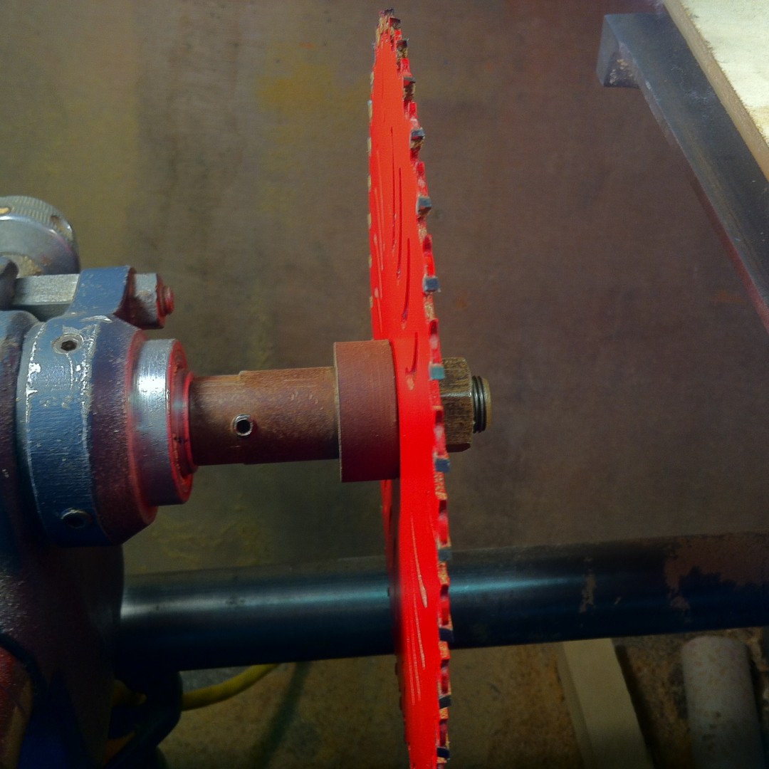

With blade mounted and on the spindle.
