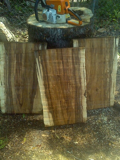

The reason I ask is that I slabbed off some sweet gum with my chainsaw. The slabs range from 8 to 14 inches wide roughly 20 inches long and 4 inches thick, I believe I have around 30 of them. I want to begin ripping them down and don't have a band saw.

I don't think a 500 will have the HP for that. That's pretty big stock. That's band saw territory.
Re: 12" Table Saw Blade on 500
It may still be under powered for the task but I have replaced the 3/4 HP motor with the 1 1/8 HP motor. I should have mentioned that earlier.

Those are nice-looking slabs, but I wouldn't run them directly through any tablesaw in their rough state. Even with ample power, I'd either use a sled, or else flatten the bottoms and straight-line the fence-side edges. If it can rock, the risk of kick-back is high. Even if you can fit a 12" blade onto your Shopsmith, the blade guard (with kickback pawls) isn't likely to fit.
JSBurger has built a sled that is probably big enough to rip those slabs -- but of course a sled will use up some of your cutting height.
A bandsaw really is the right tool for this job. With luck, you might find a good Shopsmith bandsaw on Craigslist for $100 or so.
I appreciate all the responses, and will delay the project until I can secure the bandsaw SPT.
