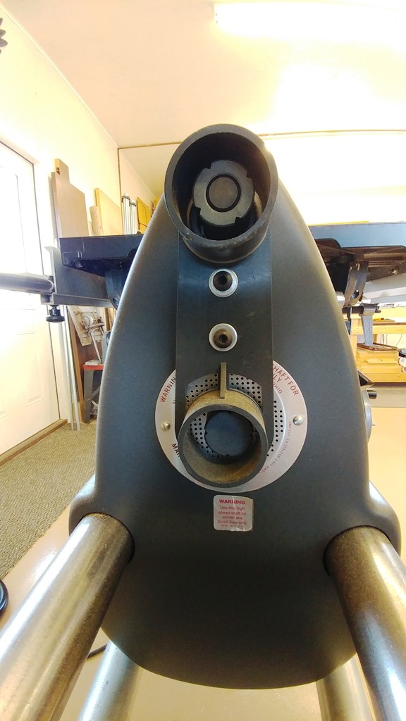

Just curious if anyone has decided to drill a hole or cut a slot in the guard that comes with the PowerPro headstock for the accessory side? The guard is a nice extra safety feature, and works fine if all you ever put there is the power coupler hubs.
I am aware of the Quill Twister (http://www.shopsmith.com/ownersite/cata ... wister.htm), but that seems a bit overkill.
Alternatively, anyone 3d-print a twister? This may be the perfect time for me to try some 3d modeling and remixing https://www.thingiverse.com/thing:2206530 or something similar...hrmmm
For those curious, the reason this comes up is that while lathe turning I generally have a small faceplate on the accessory side of the tailstock. I use it to hand rotate the spindle to check clearance before turning on the machine.

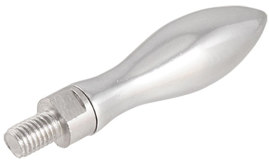

I have added a handle to one of my surplus turning faceplates (which I do not leave on under power) to help rotating the headstock shaft when lubricating or servicing the headstock, etc.
I find it easier to grasp especially if I have it vertical for some reason.
I find it most helpful when I am using the quill to hold a tap to thread a hole and keep it straight.

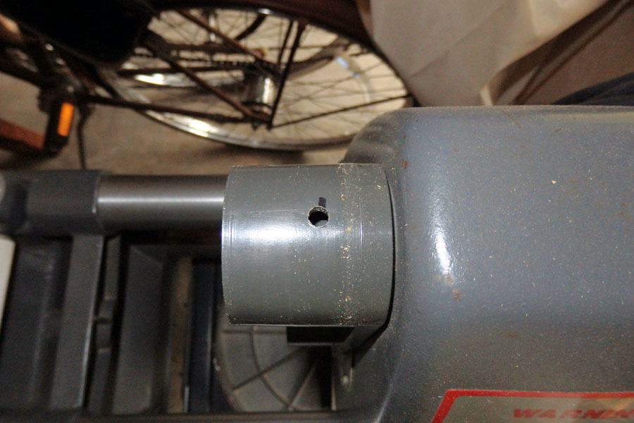

As it is now you would have to take it off. It is held in place by two 5/32" hex drive button head screws. Then you can mount anything but the guard has to stay removed. The only other thing that can be done is drill a hole in the guard to access the set screw. Like many of us have done to the band saw cover to access the tension screw.reible wrote:None of my shopsmiths have this so I can't really say what if anything I'd do to deal with it.

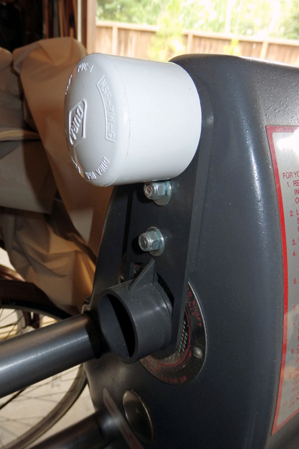

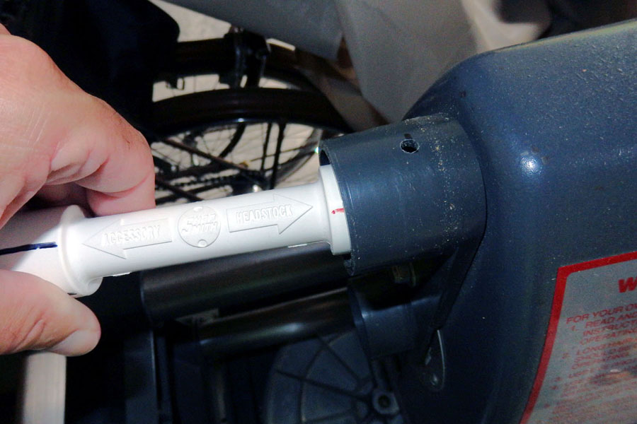

I drilled a hole in the top of mine to access the set screw. I mounted the guard in a more permanent fashion, with 1/4" bolts and lock nuts, so removing the guard to put on a coupling hub or other accessory would be too much work.
If a coupling hub is left attached to the shaft, then a coupler can be used to turn the shaft manually.
The OD of the upper shaft guard also matches the ID of a PVC cap exactly, so I keep the cap on there too as an extra measure of protection to keep curious fingers, stray hair, etc from getting entangled.
